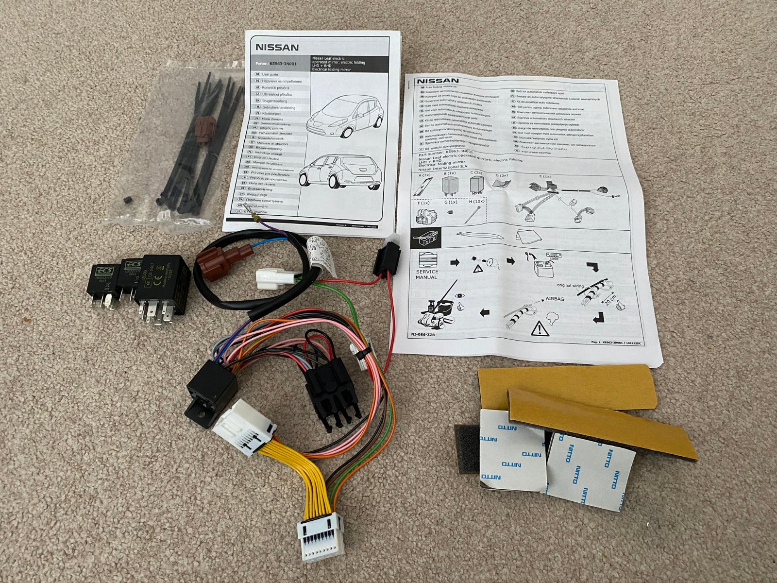

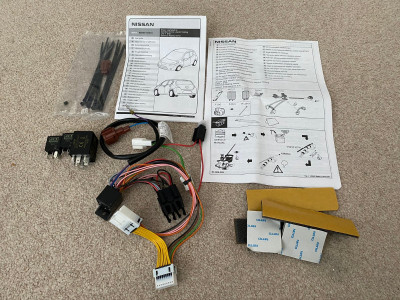

One thing that has annoyed me a bit coming to the Leaf from the Ion is no mirror auto-fold when remote locking/unlocking the car...
There is a latching button on the drivers door controls to fold the mirrors in but you have to remember to do it manually before you turn the car off. So I was finding myself constantly getting out of the car, locking it, realising I'd forgotten to fold the mirrors, unlocking the car, leaning in to turn the car back on, finding it won't turn on because the key is in my pocket just outside the door frame, sitting down or fishing the key out of my pocket, turning the car on, pressing the fold button then turning the car off again and exiting the car a second time. After you've done that 10 times for the week it gets a bit annoying to say the least!
It turns out there is a purchase time spec option to get auto-fold functionality, and it is available as a small kit for retrofitting:
It's basically three relays and a wiring harness to insert itself into the existing wiring going to the mirror/window controller on the door, so it actually installs inside the drivers door...
It was a bit of a pig to install to be honest, as you're basically jamming the relays into a small gap between the door card and door frame and you also have to splice into a wire in the door locking mechanism as the kit was originally designed for the Gen1 Leaf and the connector type changed in the Gen2
Just trying to get that connector off the door lock mechanism took me half an hour as I couldn't see the connector well enough to figure out what type of latching mechanism it had.
Not a job for the feint of heart.

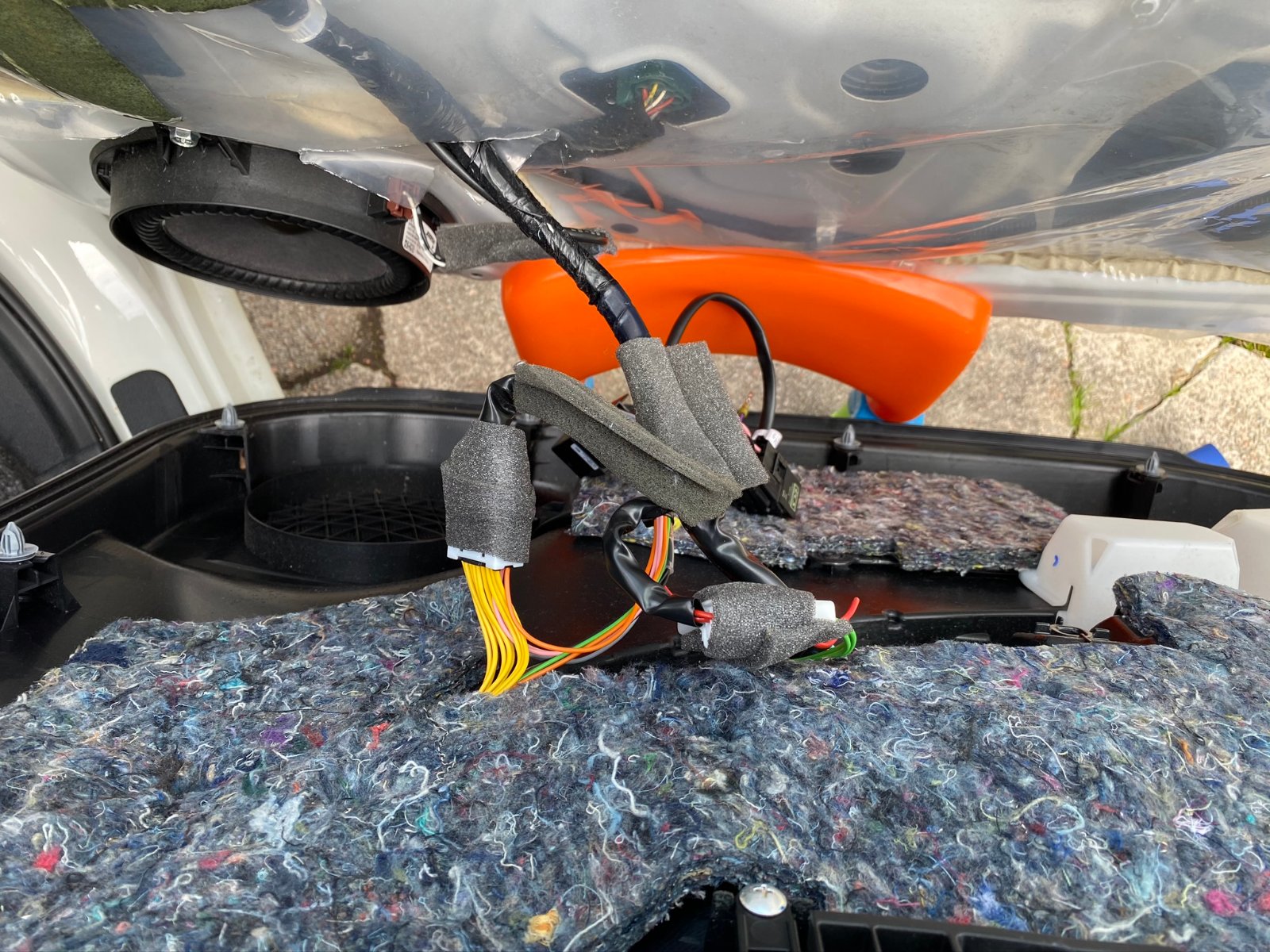

One thing I've noticed with the Leaf is that it feels really well insulated from the outside temperature - once the cabin is warmed up it seems to stay warm with a very minimal amount of heat, whereas the Peugeot felt draughty and poorly insulated.
One thing I discovered while fitting this kit is that the doors are really well insulated and actually have a thick layer of carpet underfelt behind the door cards!
That would explain why it feels so well insulated and also why the road noise is so low... I'm not sure whether the rear doors are likewise insulated but I'm assuming so.
I've never come across carpet underfelt behind the door cards in a car before - has anyone else seen this before ? I guess in an ICE vehicle with unlimited "free" heating there isn't much motivation to add extra insulation to the doors, (except as sound deadening) however in an EV where every kWh matters extra insulation could dramatically reduce the power consumption of the heater once the initial warm up is out of the way and the cabin is at the target temperature.
That certainly seems to be the case because even in the coldest weather we've had since I've had the Leaf (around 10C) once the cabin is warmed up the power consumption of the heater is almost nothing with the car feeling cosy warm. It will be interesting to see how the heater performs in freezing conditions.
As for the auto-fold kit - it works well. When the car is locked from the outside the mirrors fold in, however they don't unfold when you unlock the car - it's not until you turn the car on that they unfold again. That seems a little strange at first but I guess it does make sense as you can unlock the car as you approach and still be able to walk through the gap to another car with the mirror folded in.
