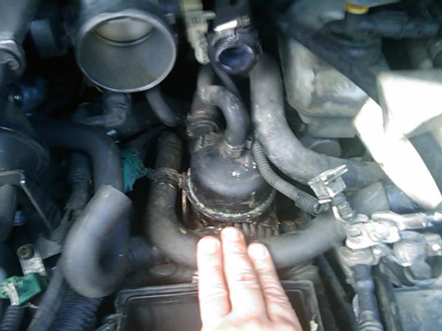

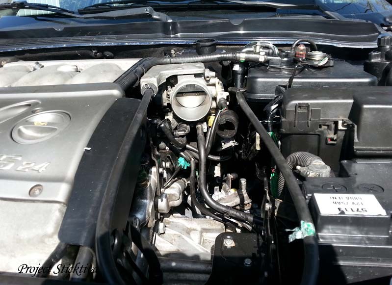

http://stickyfinger-activa.blogspot.co.uk/ Blog Update.....
Leak fixed...the offending item on the right, note the weeping seam the the look of an old cooked bit of plastic.......caught it just in time.
It was just the odd drip when I first looked a few days after getting the car....then over the two weeks it developed into a drip drip, before starting to replace it was a drip-drip-drip-drip-drip...about 1/4 ltr/hour I would guess and VERY easy to miss. Do YOU have a V6 using a tiny amount ?...then check the Degass Tank with care because this can start slow.
The thing about it, it drips from the same position/flows in the same way down as if the overflow has spat a little....so check with coolant low(ish) to prevent confusion.

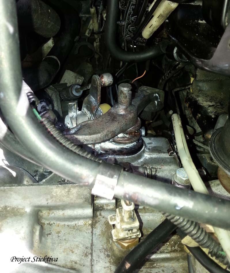

All cleaned and oiled/greased
And back together
And back together

So, whilst down there, I did the main job of the Degass tank, but I also checked and cleaned all the hoses. I cleaned/oiled all moving parts, cleaned the areas metal pipes and surfaces and rust treated the pipe unions, re-made all electrical connection using a contact cleaner then a water proofing/sealing spray (marine), I treated a small "rust spot" by the engine mount, replaced the clutch joint oil soak washer and removed/greased the all the ball joints/cups/springs.

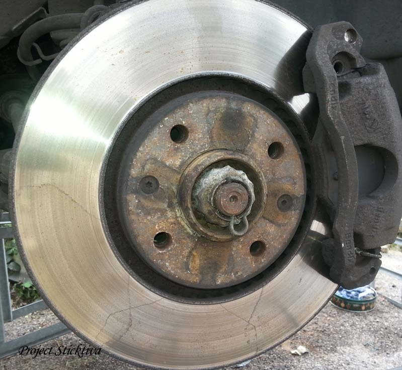

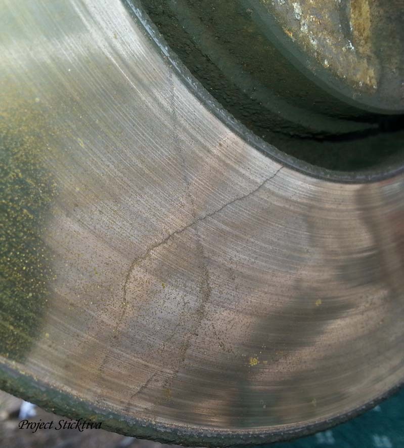

On the matter of stopping my car and the vibration when high speed braking....I think I may of found the problem.....geeze
This is a lesson in cheapo disks ...DON'T do it.
Lucky these did not go PING !

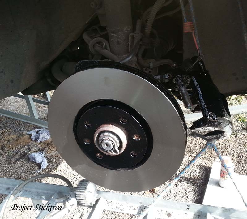

Now, that's better
, Nice new Eicher Front Brake Discs fitted up with Mintex Pads.
I will put on a set of rebuild calipers when required (rebuild them over the summer), these ones are good with nice seals and clean pistons.
Now, that's better
