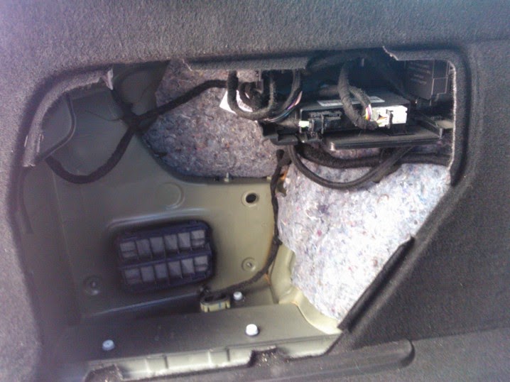

I think that computer module you're talking about is already installed, and you need to do a bit of programming with Lexia to finish towbar installation.

Thanks for the provided link, very photographic ... shame that it isn't shown how the wiring loom was connected (the tow bar socket) ... if it was connected at all, because in the intro part it doesn't get show, just the tow bar itself, no socket (7-pin or 13-pin) ... I'll have to go through my car once again, that module is still am mystery to me, because I found on several occasions that the wiring kit has that module included (that's why the genuine wiring kit costs so much) ... initially I though that the "module" is the parking computer (partly makes sense due to it's position already in the boot), but never got the confirmation about it ...

The car's connector for towbar wiring loom should be hidden inside foam somewhere behind that hatch. If I understood correctly look first in the top part, it should be there.
One shouldn't do any programming with lexia if wiring loom isn't connected.

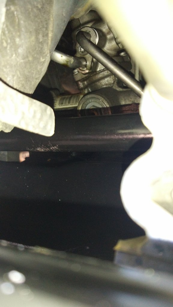

I'll let you know in a few days, but I still believe there is another computer module required for the tow bar to work as it should ... on another note, today I had the car serviced in my usual Citroen Dealer's Garage ... guess what? The steering rack is leaking ... !#%? ... not much, but it leaks ... they told me they have a handy guy that fixes them, and have several cars that already did more than 30.000 kms with the repaired racks ... the alternative is of course a new one, which costs ... a lot (or not, if you look at the total new car value) ...

Sorry to hear that - had mine done a few thousand miles ago - but under warranty, otherwise anything around the £2k mark from main dealer for a new one. Rust is the killer on the shaft, ruining the seals, which aren't separately available if I remember.
Few options here from Citroen owners club that you may already have seen: http://www.citroen-owners-club.co.uk/ci ... placement/

Re: C5 X7 ambient lighting (and some other bits and pieces)
This is how the situation looks like (photo taken by the mechanic):
