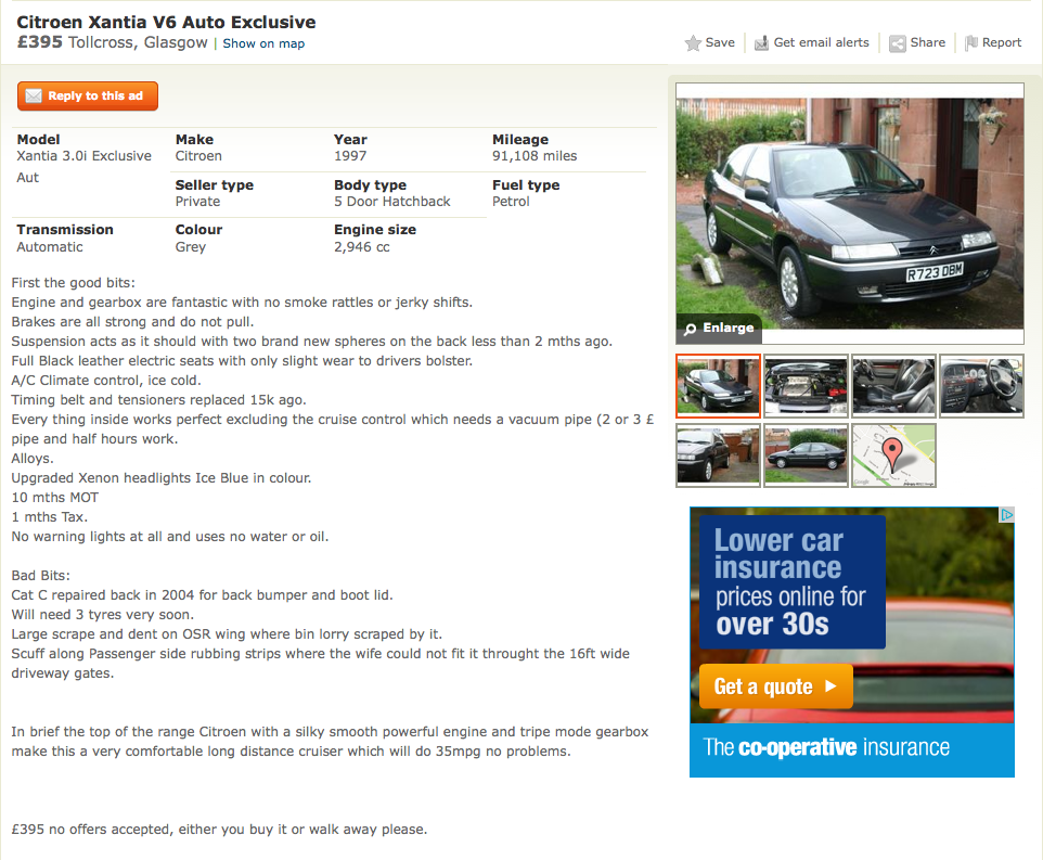

At least the job improvement is good news Simon - sad to hear your v6 'box
isn't joining in with the positive vibes. I'd seriously take into consideration that
Jim fella's offer of rebuilding the innards mind! Would finances allow that other
Glasgow v6 with 90k miles on Gumtree to stand in for active duty whilst the silver

Thanks guys, not really sure what to do.
Even though it looks in good condition I'm not sure that I want to buy another automatic and end up in the same predicament in a few months or a years time. (Not to mention another low MPG car) A lot of the work that I've already done to this one might have to be re done, including tyres, spheres, handbrake cables, droplinks etc.
Also I can't afford to insure two cars at once which would mean putting the old car off the road by transferring insurance, and then do what with it ? I couldn't in good conscious sell it when it has obvious problems driving and is likely to die in a few months. All I could do is either sell it to someone willing to take it on as a project who will get the gearbox done, or break it for parts. I don't have the space or money to keep two cars for any length of time.
None of the alternatives appeal much. :?

Oh yes, very important to eliminate everything else before finally reading the last rites to the gearbox. Those noises worry me though Simon. I wish I could put my ear to them.
That's not a bad Idea of Andrew's - buy that green one to tide you over...
