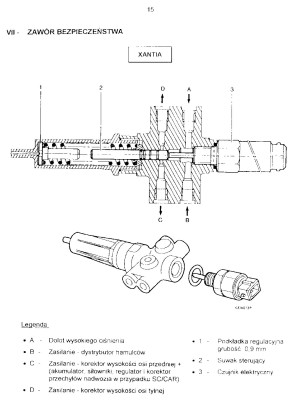

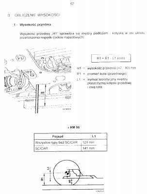

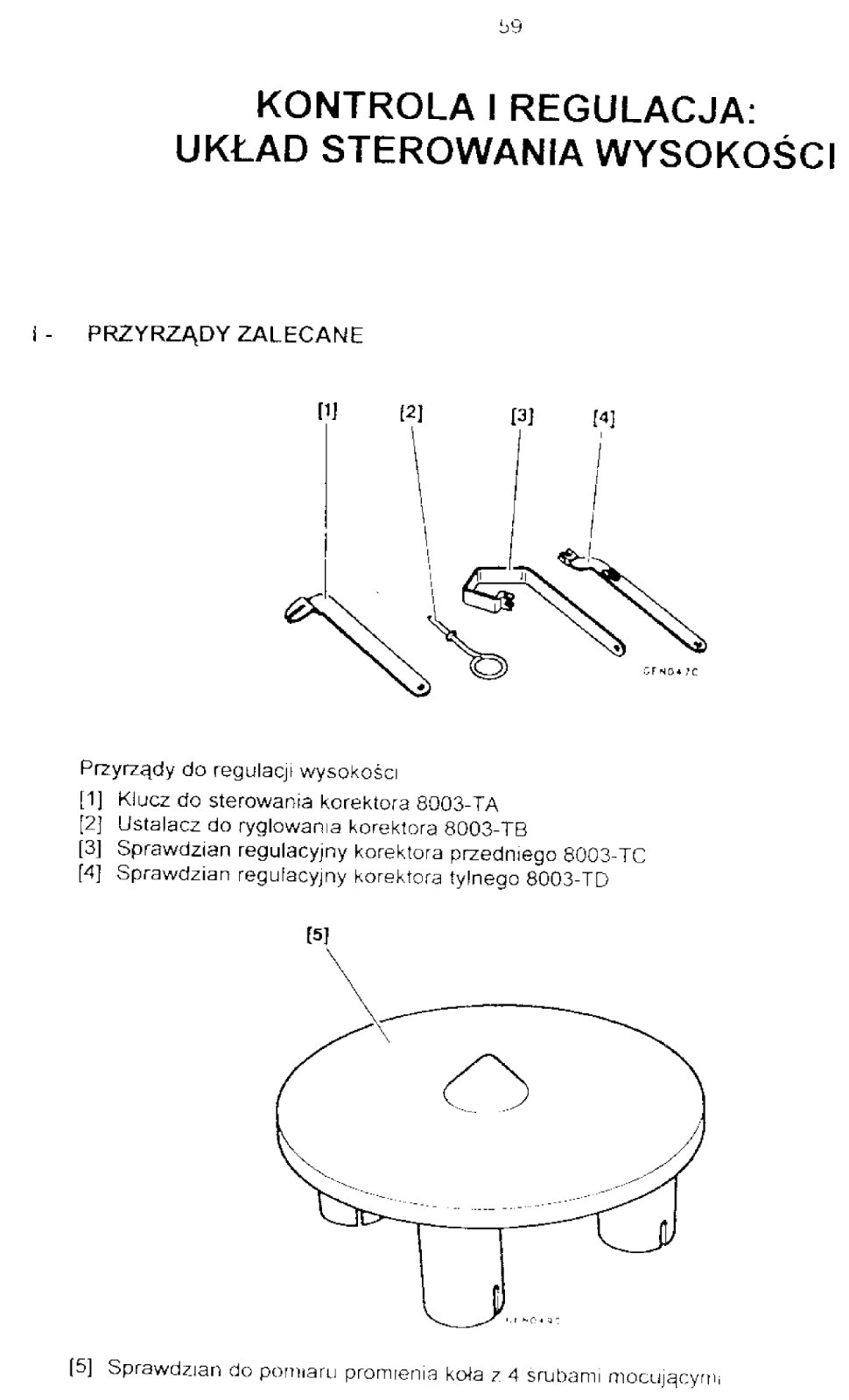

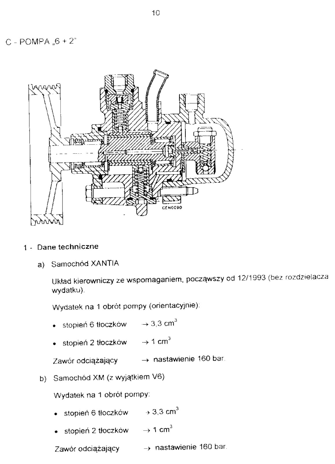

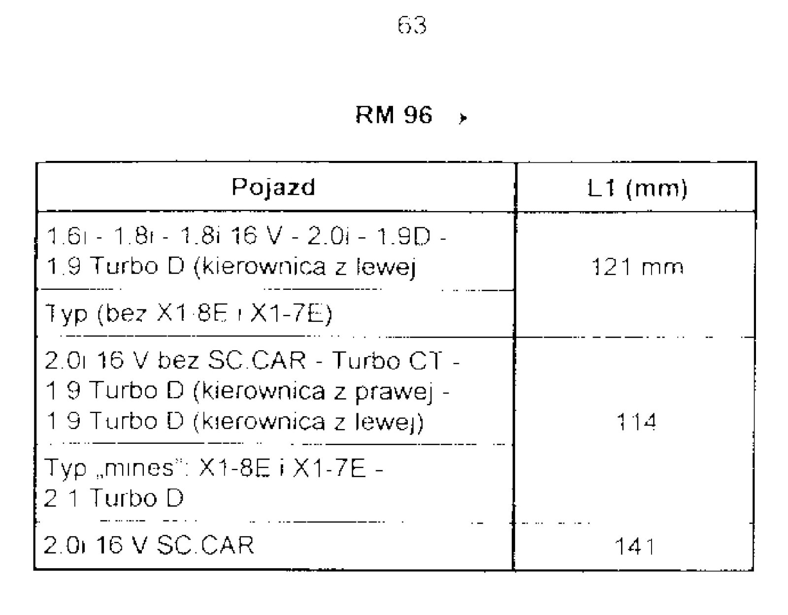

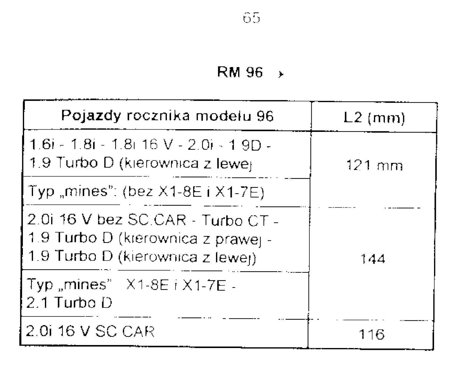

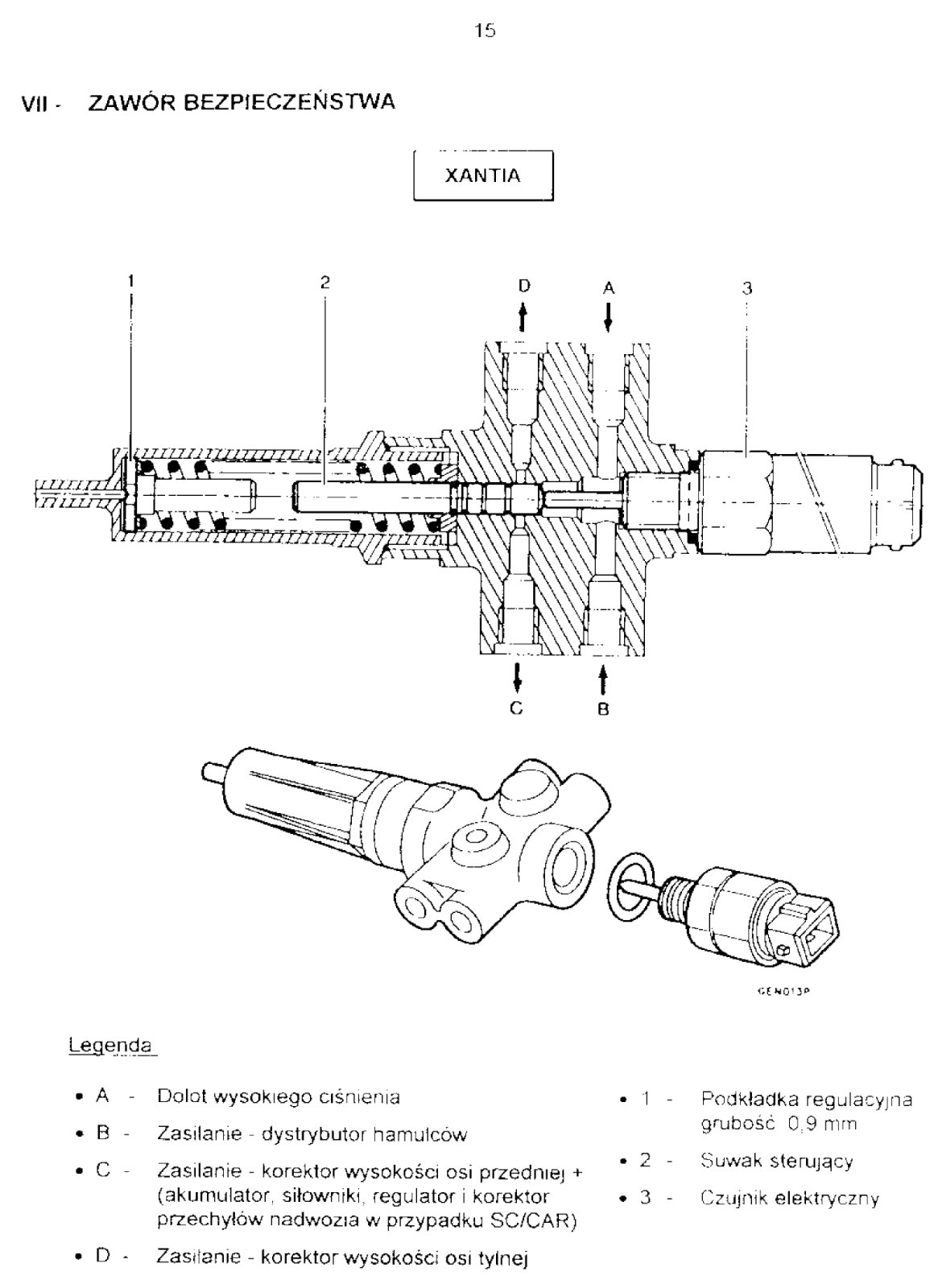

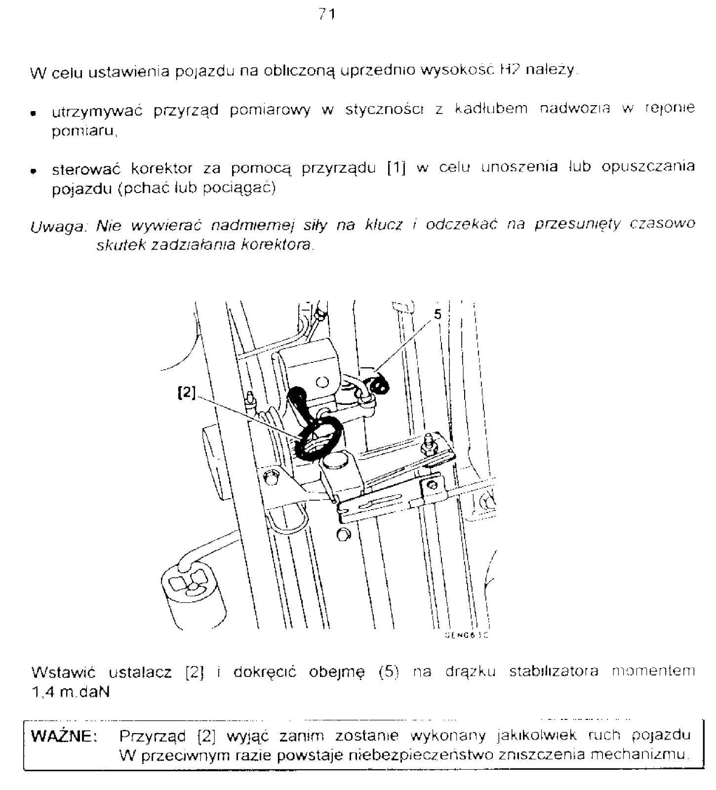

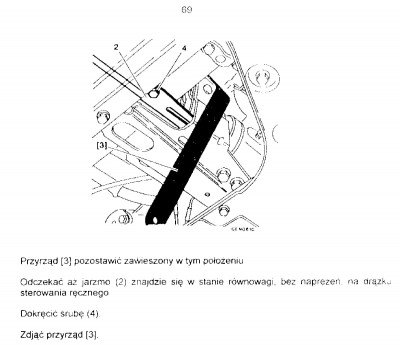

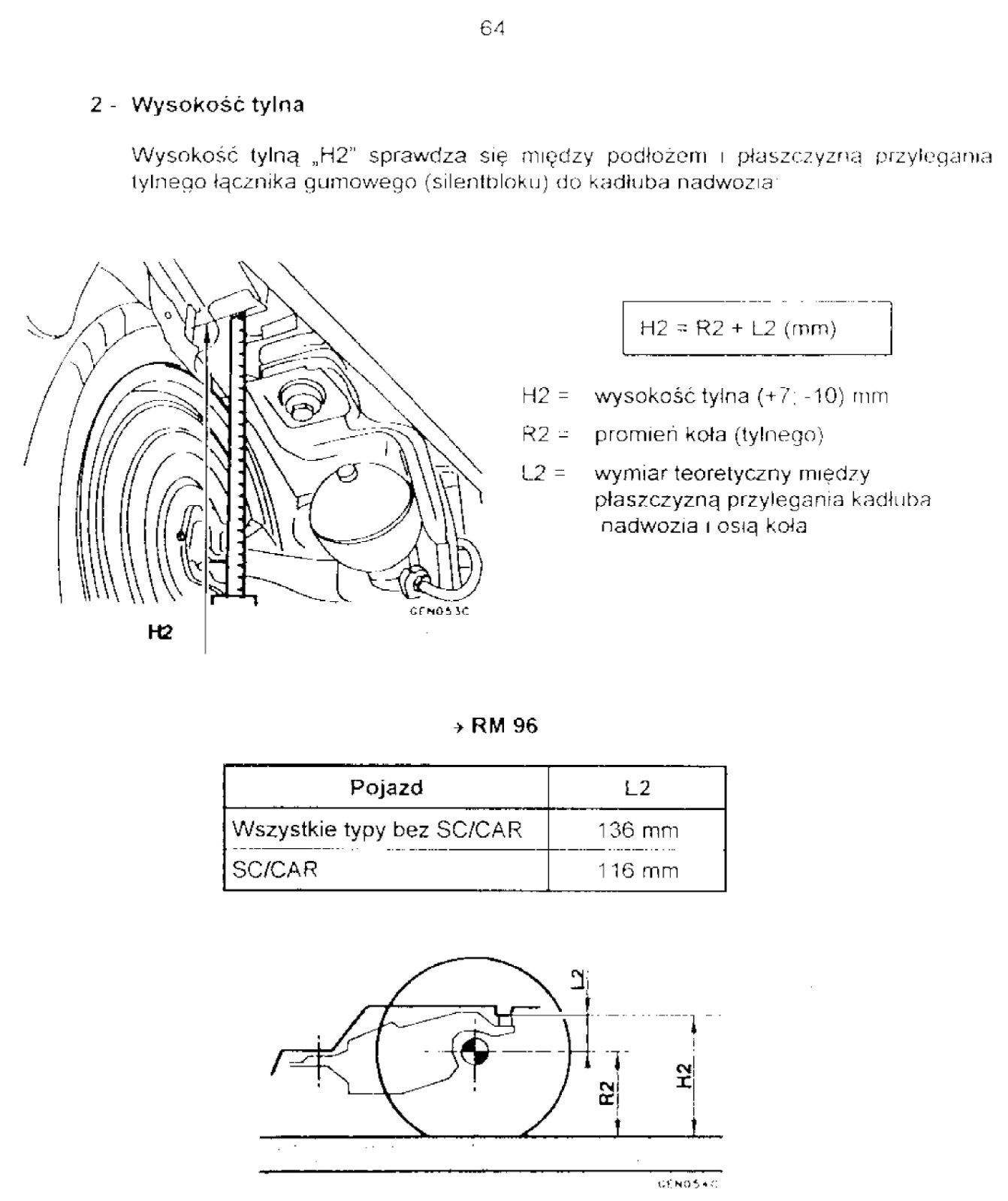

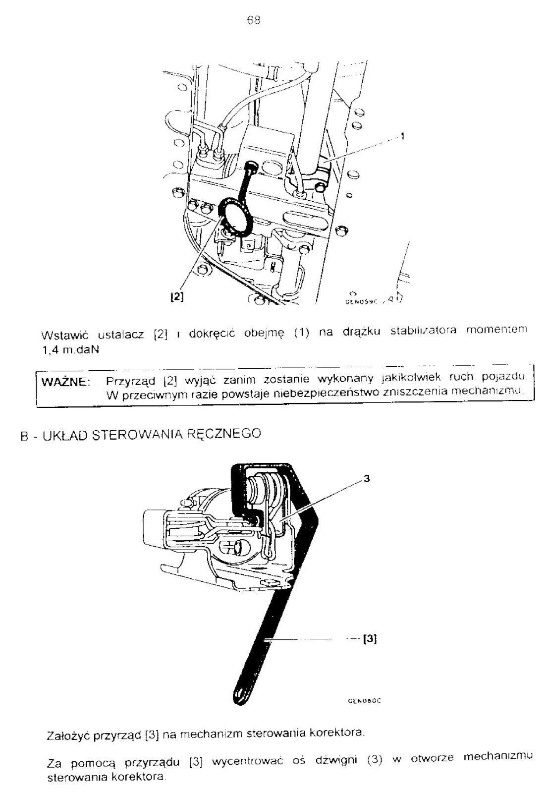

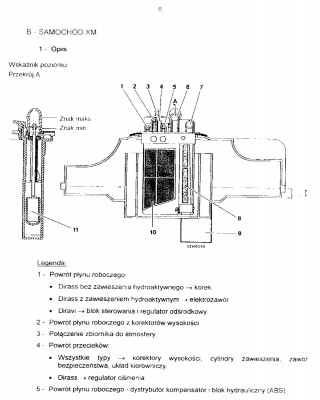

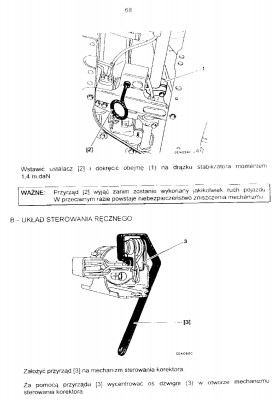

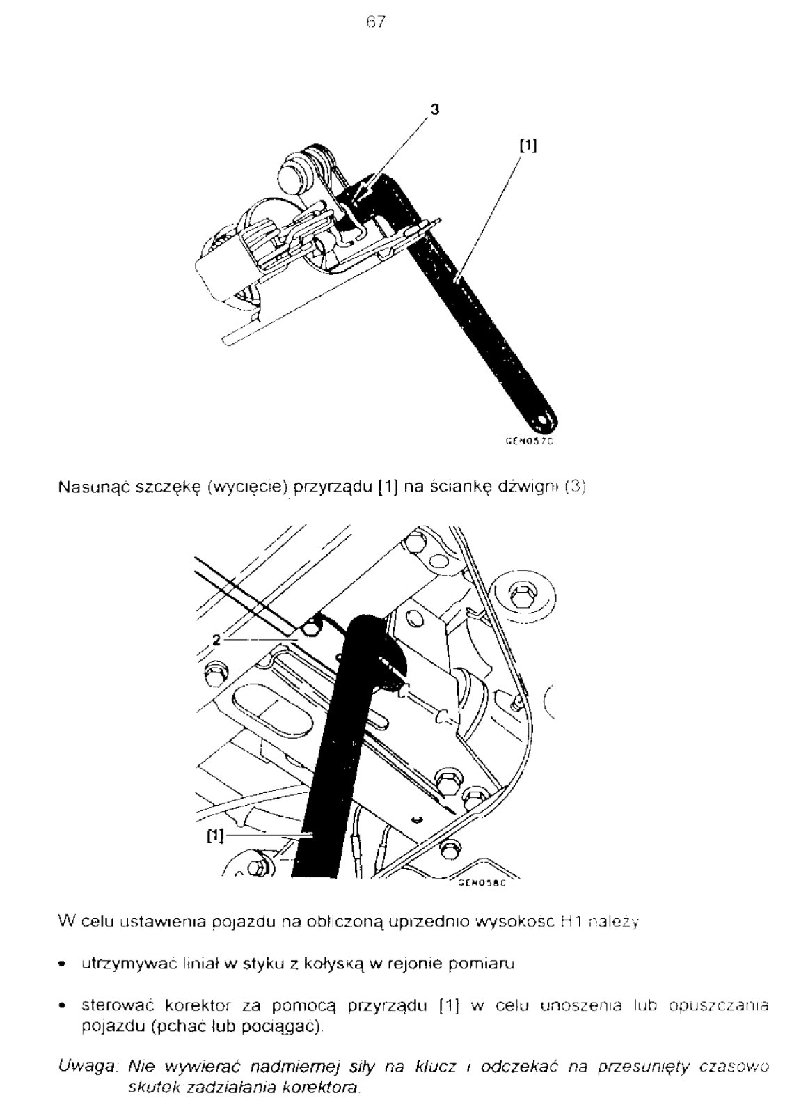

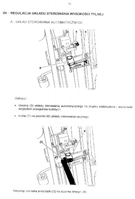

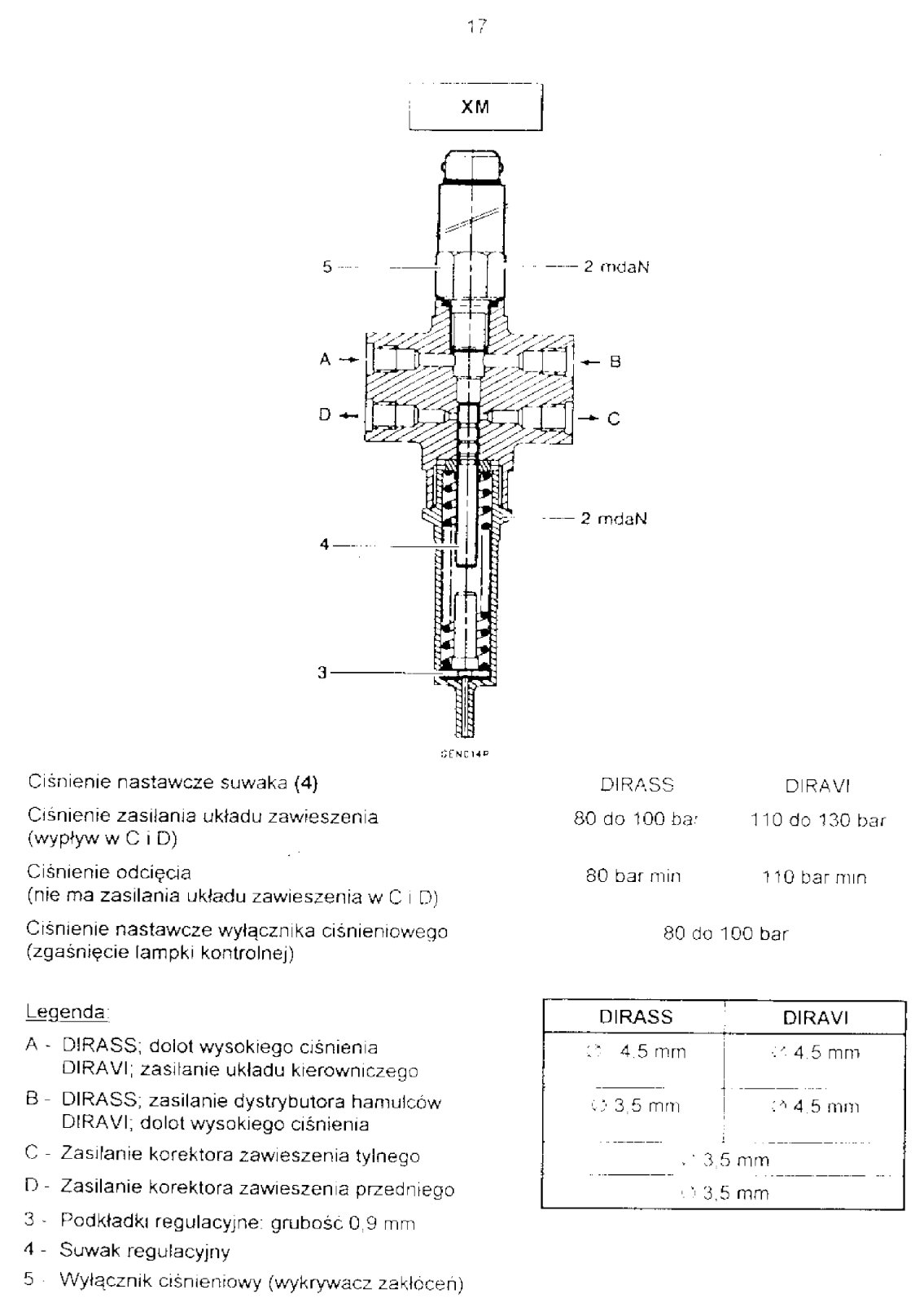

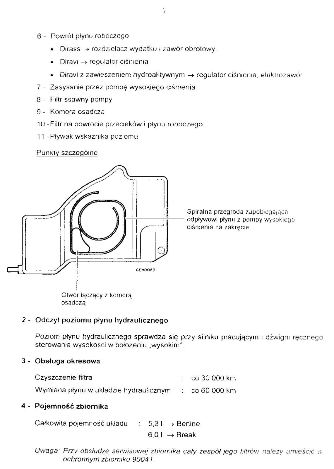

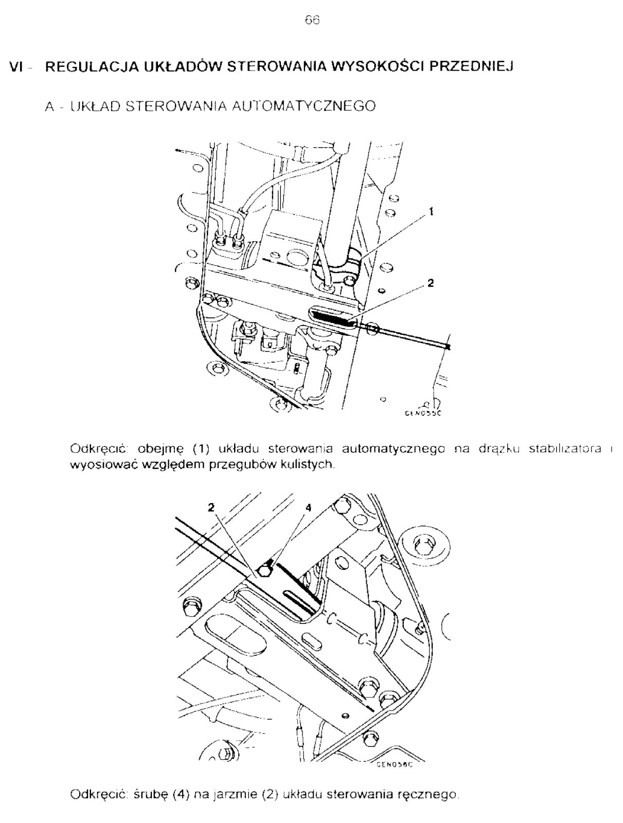

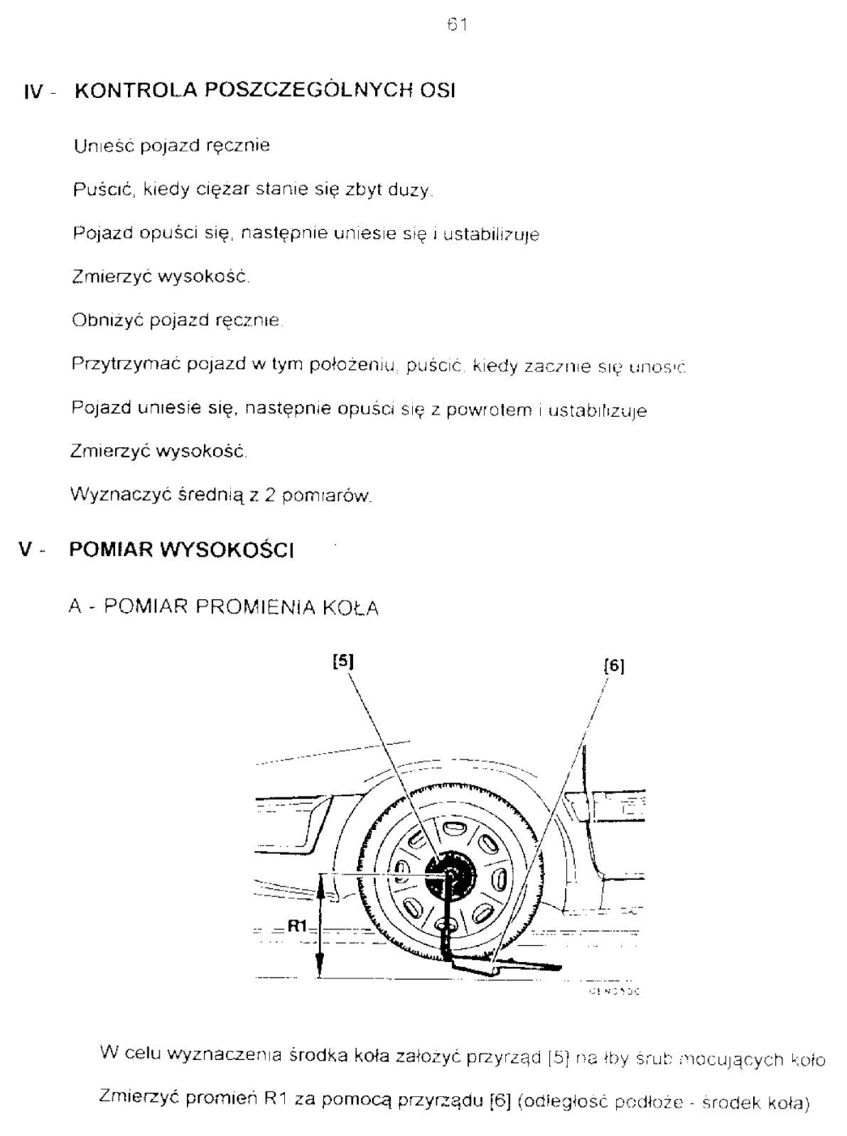

Same document? I will add some interesting photos so that you can compare them with your document.

Hi,
yes exactly the same. Actually, two files I found only with different sizes of the pages. Really good source, just what I was searching for

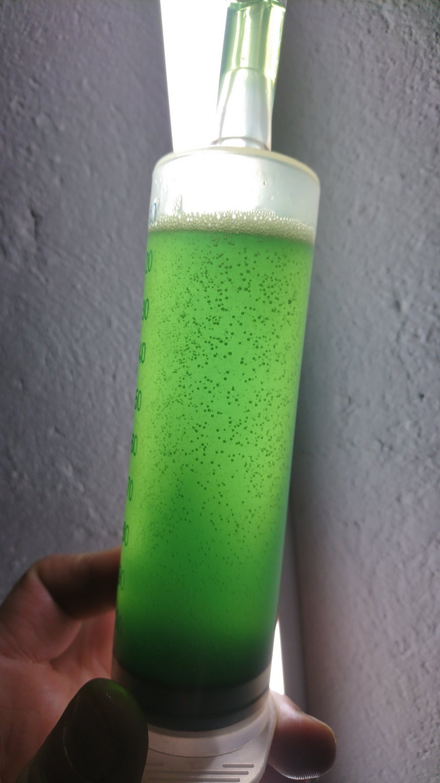

My preferred method of assessing what sort of bubbles are in the reservoir is to dip a sample of the fluid with a small transparent container.

I made 2 attempts.white exec wrote: 19 Jan 2021, 11:36 My preferred method of assessing what sort of bubbles are in the reservoir is to dip a sample of the fluid with a small transparent container.
1 photo after driving 10km in the city, I let the engine run at idle for about 10 minutes (then the conjector turns on every 5 minutes or less) and after this time I took a sample from the tank as in the first photo.
2 photo after driving about 3km with different engine revolutions and turning the steering wheel (conjector turns on every 20 seconds).

I think it is exaggerated to call them micro bubbles, to me this is something around 10-th to 50-th of the millimeter in diameter (
So, you see my point, those bubbles are something, that has been taken into account with the development of the system, and for me it is certain that they can not influence it at a such degree, as to harden the suspension or make it less responsive. I don't want to state my tick time at the conjecteur, as it is hilarious, compared to your 5 minutes at idle

. Mine is doing the same with the rear. You have to admit, that the linkage of the XM is more complicated, than onto the Xantia, and as you probably know the corrector has only +/- 1,5 mm of movement through the entire range, so precise calibration is needed here. I think you have misconfigured height corrector linkages, maybe worn parts of it, and to be honest, I'm not really sure, that you have all the needed info at those pages. Maybe Chris knows more about the calibration, and that is why he enjoys smooth, non-complainable ride
