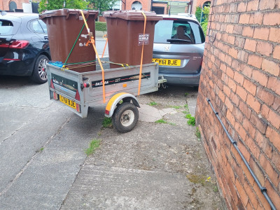

Bins out for a short ride
No prizes for guessing where I have been this afternoon.

Reminds me of an old joke from Covid times: 'My bins go out more often than I do...'

😆... he's doing what folks do where I live but instead he's using his bins , there must be a big racing place near him where they have race meets several times a year . Mucking out must me fun too 😃

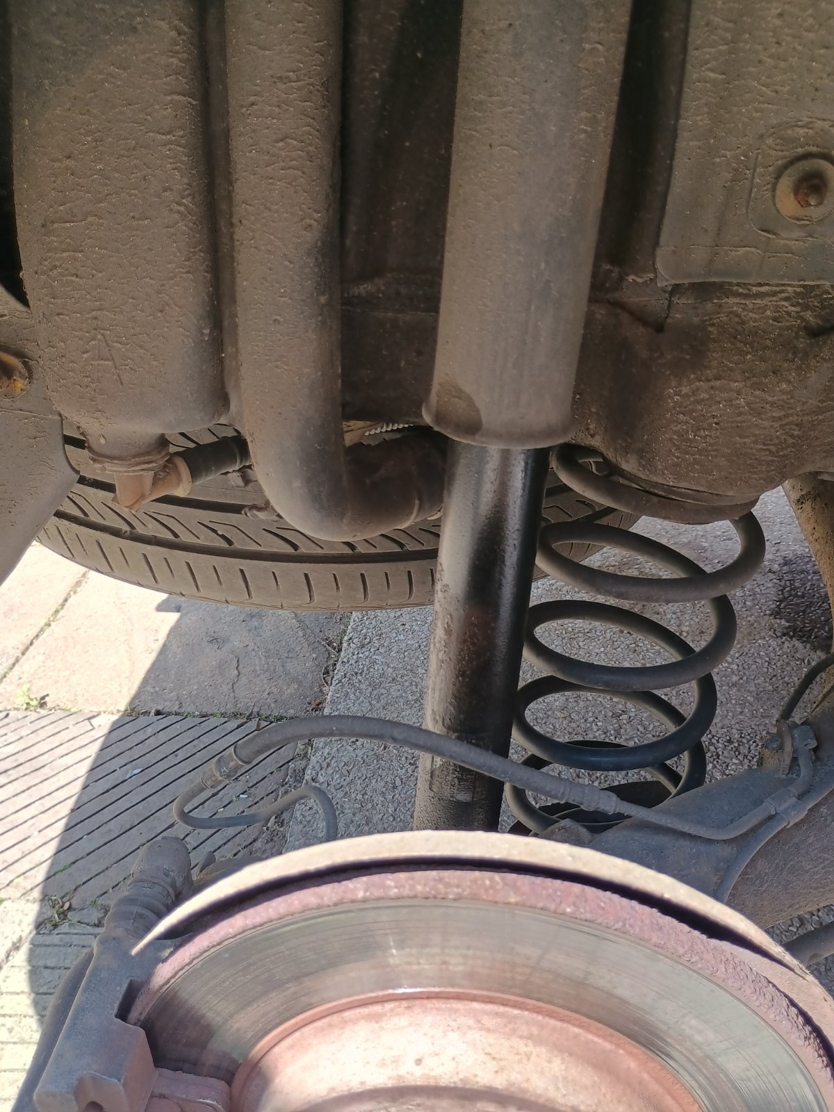

Grey 308 SW, this is the MOT advisory's "slight misting"
Misty shocker
Misty shocker
Actually happy to have this brought to my attention only as an advisory.
Wet from top to bottom, and indeed moistening the end of the trailing arm beneath it. Very glad to be changing it.
New items are TRW and pretty reasonable £34 each from Autodoc.

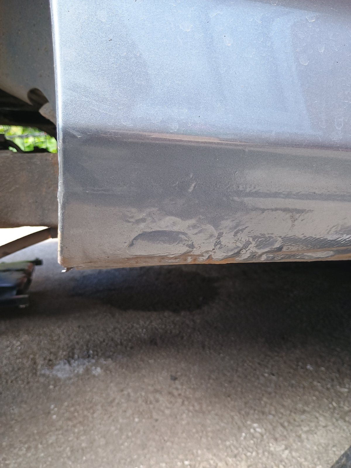

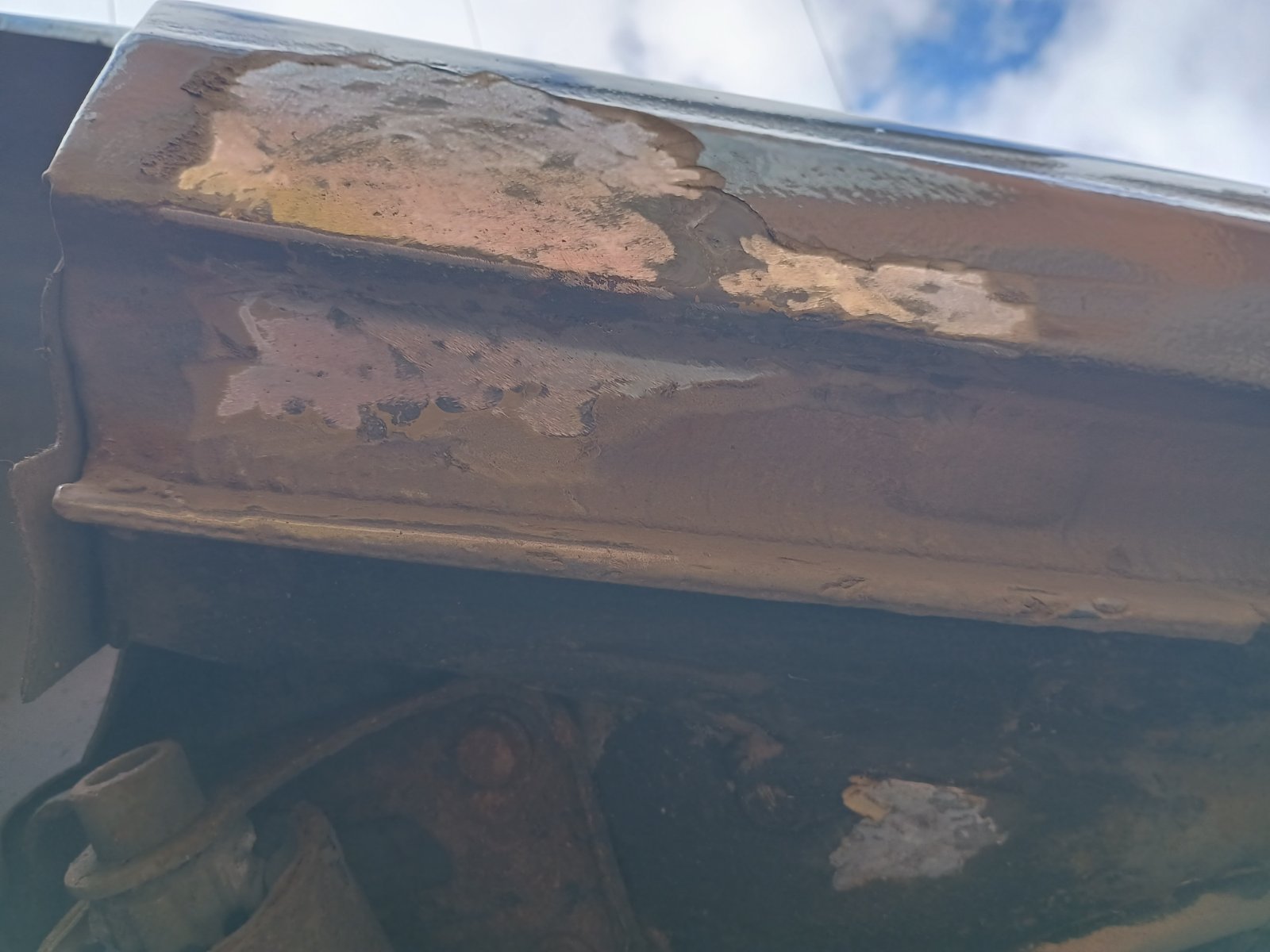

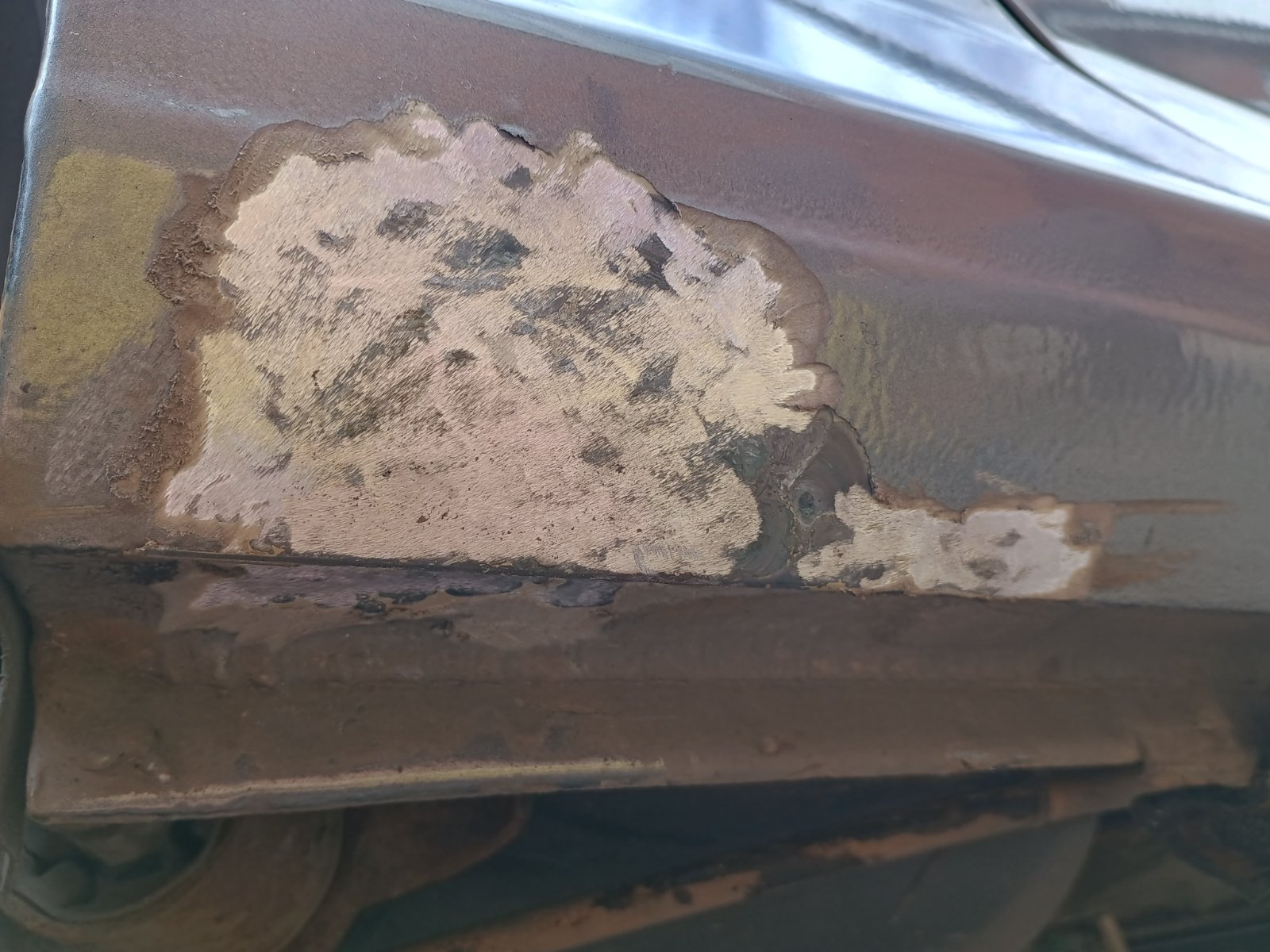

Caught it early but definitely needed treatment, again just a picture for now, waffle to follow :)
And now, waffle!
Post powerfile treatment
Sill end
Sill end
Ground back with powerfile, fortunately no holes, just bit of surface rust. Cleaned up then treated with phosphoric acid. Then brush painted grey primer.

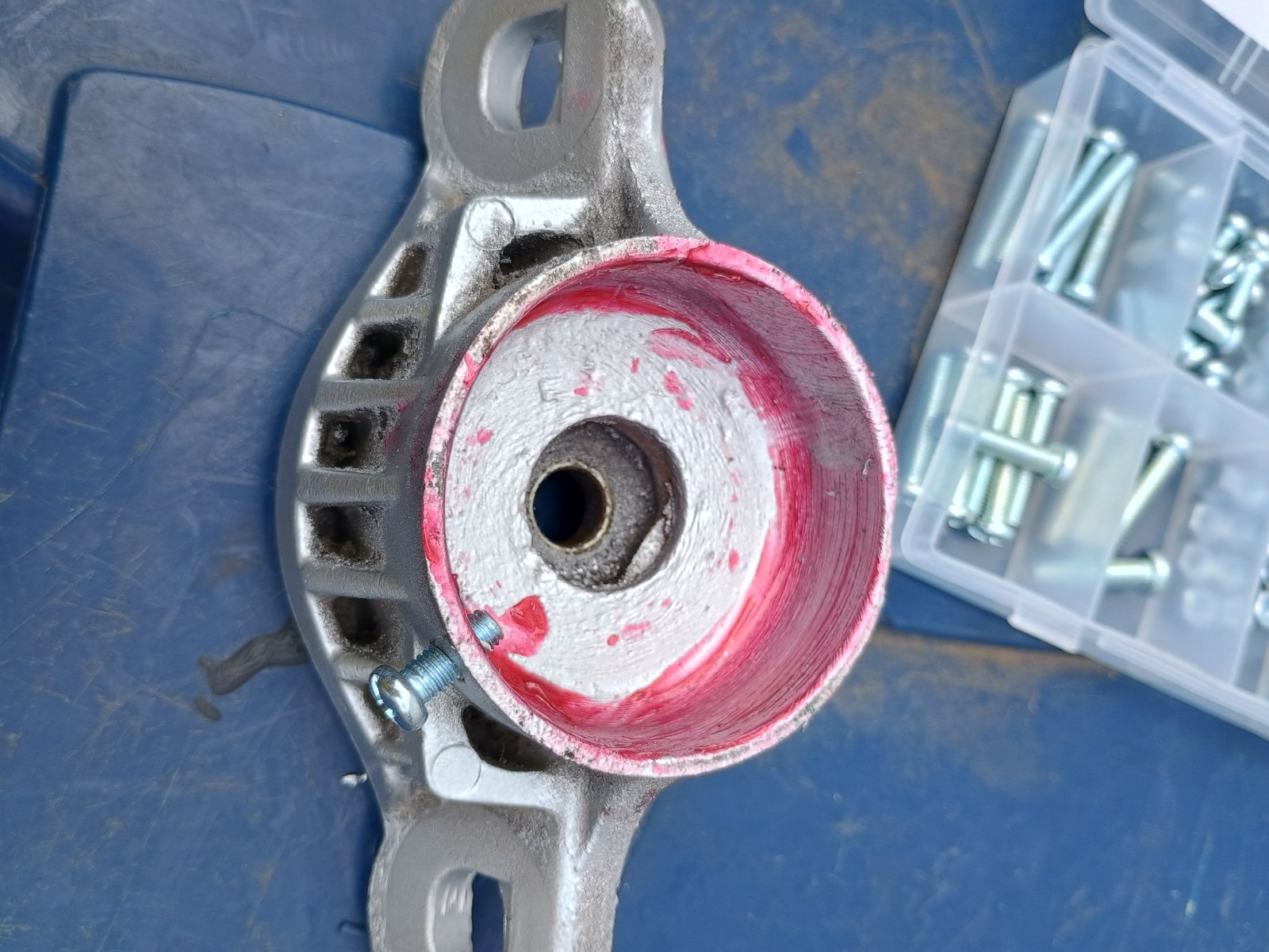

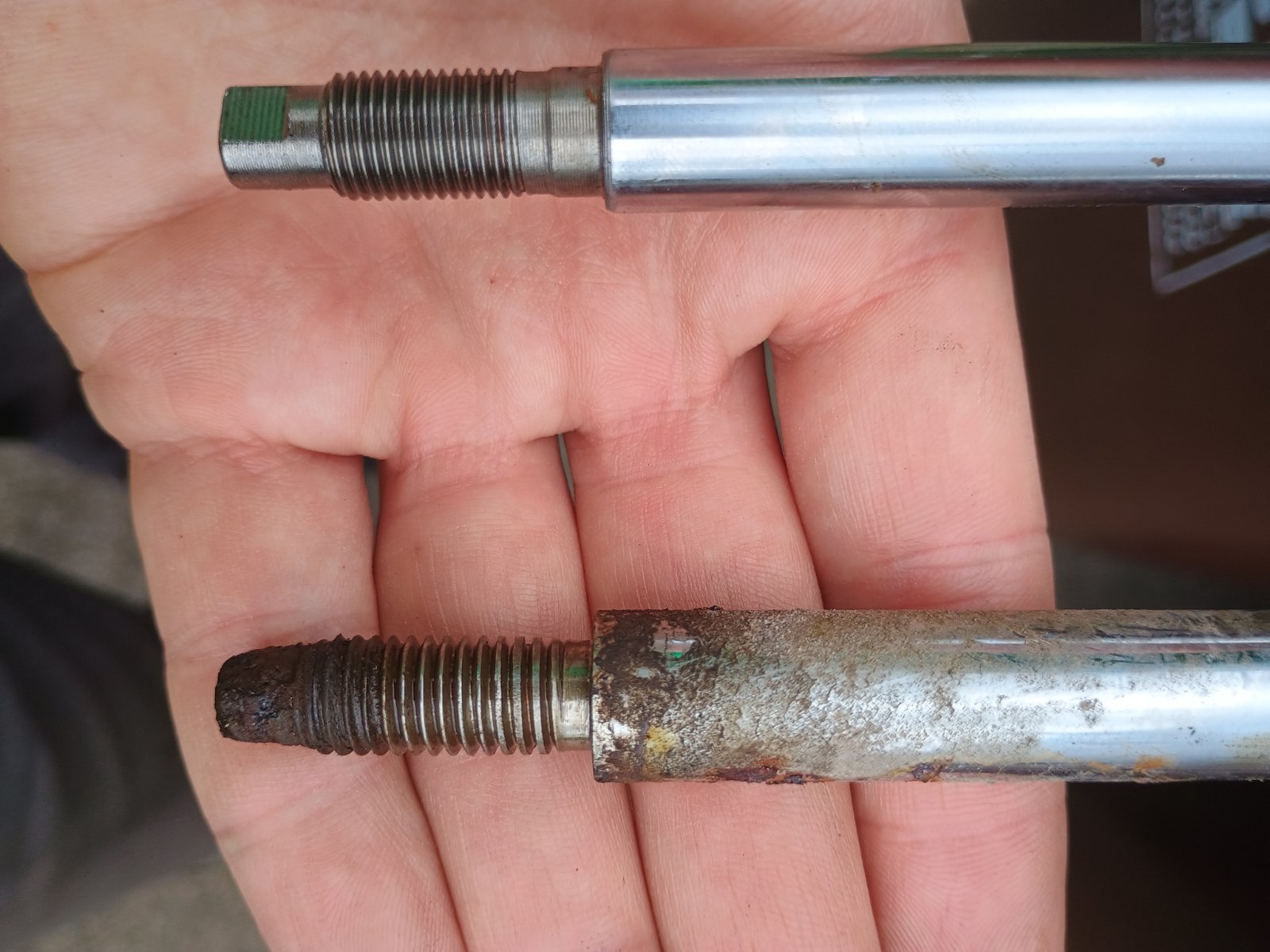

Few more damper swap images:
Surprisingly big difference between the old and new in terms of thread pitch
Old is standard pitch M10 (but with a less common 16mm nut)

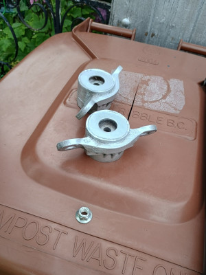

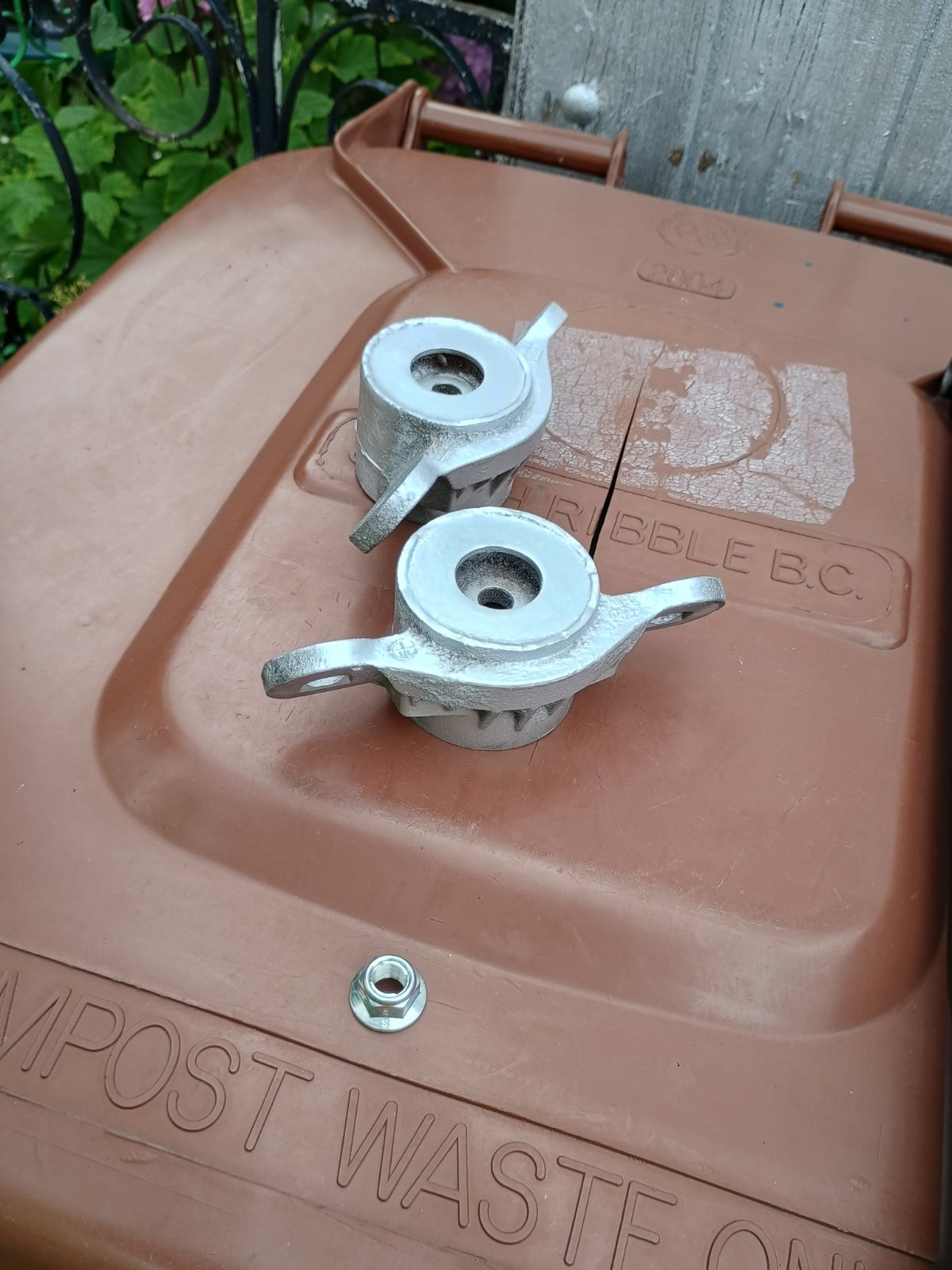

Damper alloy top mounts were very aluminium oxide crusty, so wire brushed and quick squirt of silver paint.
Spangley
Spangley

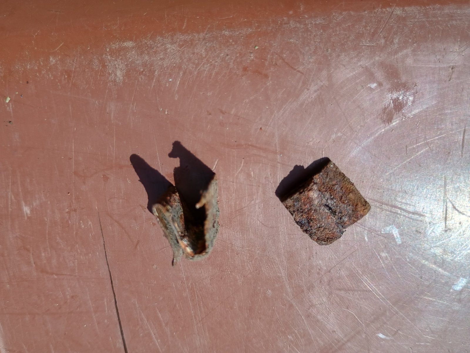

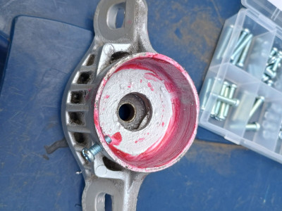

Top mounts also modified with M5 tapped hole and screw to replace this:
Crusty and .... Well, non-existent!
Bump stop retaining clip.
New version:
Retainer MK2
Retainer MK2
Red rubber grease to help bump stop slip in. Also excellent and sticking all the swarf from the bolt mod. D'oh!

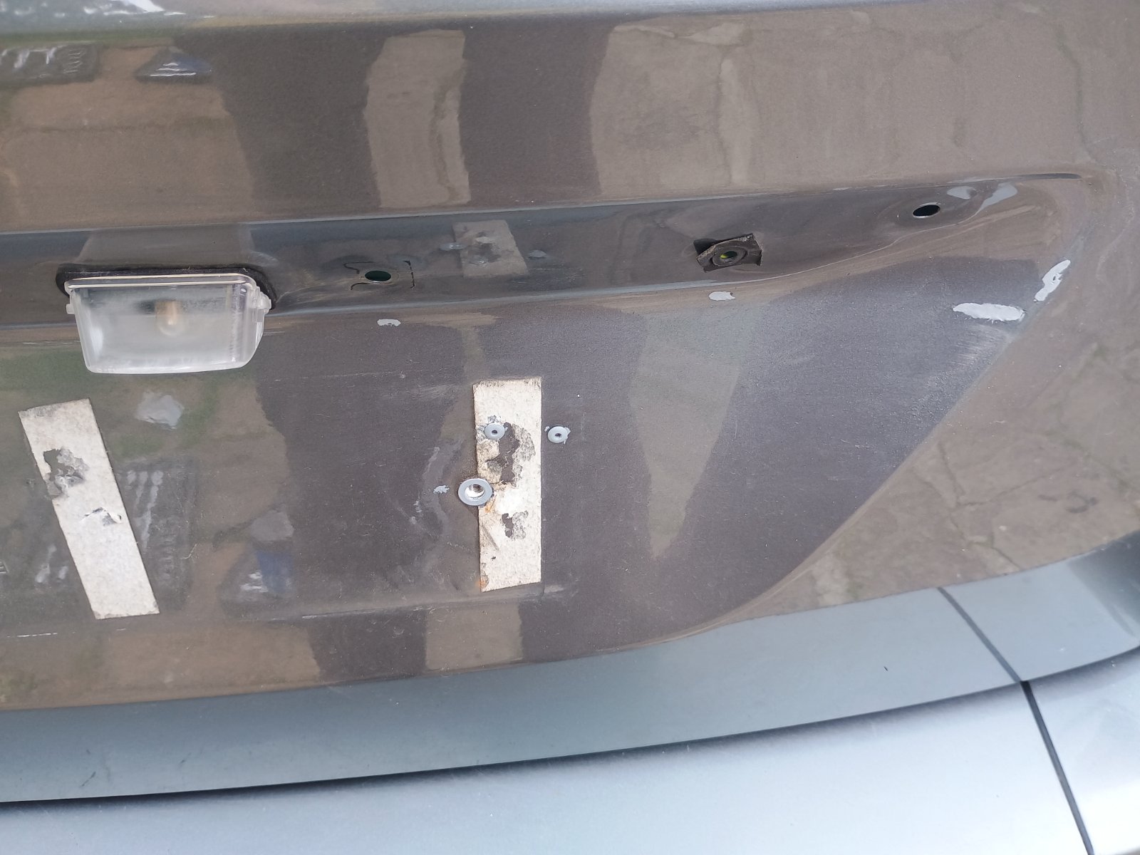

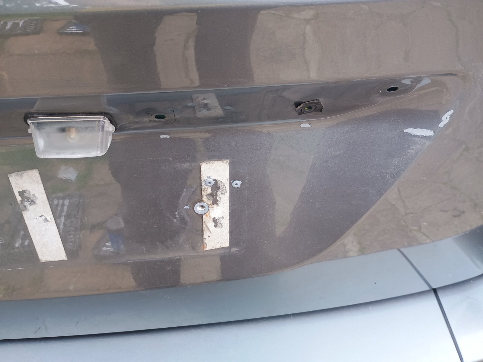

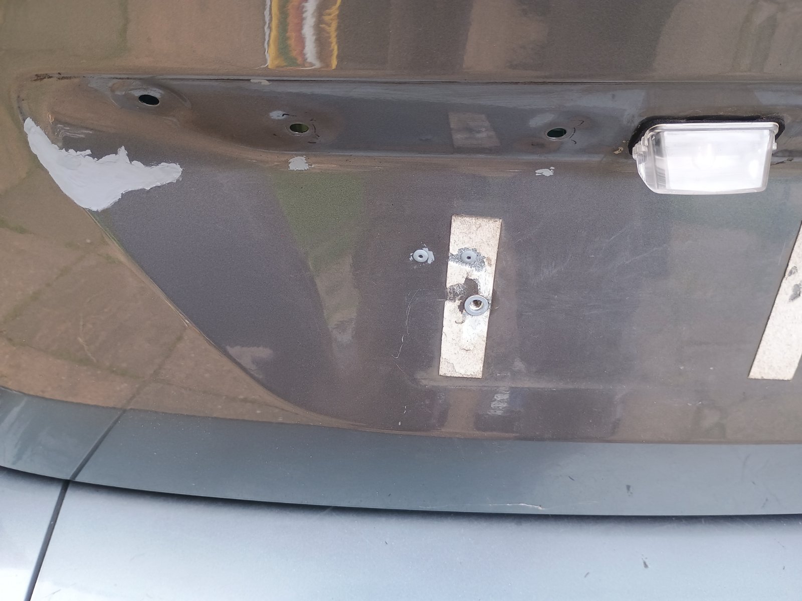

Another car job followed, but only part completed. Here's a couple of "teaser images"' and more tomorrow when I hopefully finish it off.
Left
Left
Right
Right

Number plate off and possible tow bar loom to go in ? :)
Posts: 5364
Joined: 25 Apr 2022, 09:03
x 2367
Unread post by MattBLancs »
mickthemaverick wrote: 28 Jun 2025, 21:11 Number plate off and possible tow bar loom to go in ? :)
Number plate off: yes, but towbar (and wiring) already fully functional :)
The answer is an odd failure (and an odd fix) - unhelpfully I've painted it with a bit of the grey primer too.

Well when you say waffle you certainly mean it, but I'm more interested in how you got the brown lid to crack in the centre. There must be a story there as it doesn't look like a cut mark.
