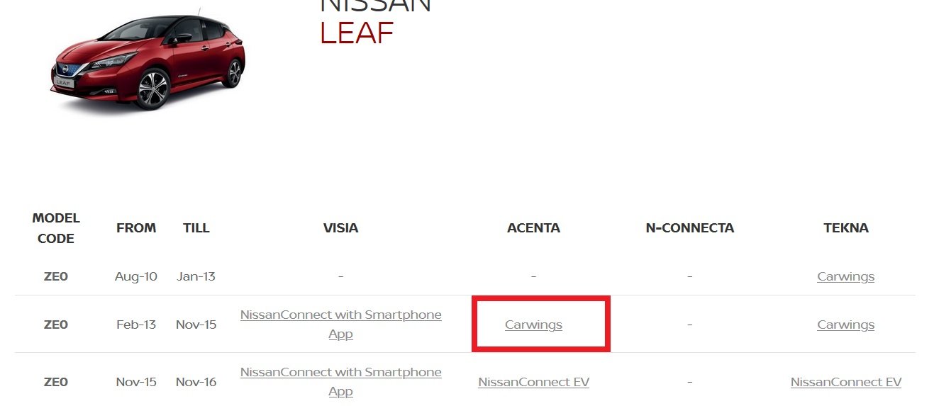

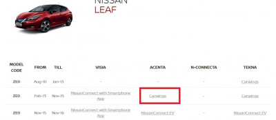

Posts: 26424
Re: Simon's new Xantia V6 and Peugeot Ion blog
I had a brief look at the Nissan Connect "website" and deduced that with my vehicle it is the older CARWINGS.
screenshot
screenshot
I was amused to read elsewhere Nissan's description as....
Get closer to Nissan
You+Nissan is all about Nissan understanding what you need and giving you what you want. It’s a space that enriches your experience of owning a Nissan with content that you will always find relevant and exciting.
You+Nissan LEAF
If you have a Nissan LEAF, YOU+NISSAN gives you extra-special services, such as access to the revolutionary CARWINGS services, an amazing tool which will help you get the most out of your car by managing several of its functions remotely from your computer or iPhone.
Well Nissan I am going to have to pass on such revolutionary services. I am still by choice in the smartphone wilderness, so I'm sticking to not bothering sorting out the "carwings" thing.
Not sure if the fairly awful sat nav maps are rolled up in Nissan Connect or whether that is a paid for add on to keep them updated. Again its not something I am bothered about at all. In its cumbersome way we only ever use it to see how far it is when straying outside our home turf to the next charging point.

NewcastleFalcon wrote: 30 Jul 2020, 18:55 Well Nissan I am going to have to pass on such revolutionary services. I am still by choice in the smartphone wilderness, so I'm sticking to not bothering sorting out the "carwings" thing.
Ah, I didn't realise 2015 models like yours were still "Carwings", that means the infotainment system is a bit different to mine although it does more or less the same things. I believe older cars with "Carwings" now use the same Nissan Connect EV app however.
I forgot that you don't have a smartphone - without one it's not much use! You can still use a web browser on any computer to do the same functions like remote climate control but not with the same convenience of whipping a phone out of your pocket to do it.
I believe the last map update (which you pay for!) for the Leaf 24 and 30 was released in 2018, so even if you or I paid to get this update our maps would still be 2 years out of date. Around here there are a lot of major changes to major roads and motorways which have happened in the last two years, making the on-board navigator useless to me as it isn't even aware of some of the new roads like the new section of M8 motorway...
Sadly this is a common complaint of many modern cars, not just the Leaf - onboard navigation systems are often only provided with updates for a few years, which you have to take it into the dealer to update (and pay for it) then after a few more years, no more updates. Compare this to Google maps which is updated very frequently and for free. Considering that the Leaf 30 was still on sale new in early 2018 and the last map update available is 2018 this is pretty disgraceful to be honest, however it was a problem I was aware of with earlier Leaf's before buying.
I will just continue to use Google maps on my phone as I have always done and that frees up the centre console to view energy stats when driving or more easily control the radio.
Carplay and Android auto support solves these kind of issues with expensive and out of date map updates - once a car has them you can link the screen to your phone and project any map application you like from your phone to the screen on the car, as well as music apps, phone call taking apps etc... unfortunately the first Leaf to get Carplay and Android Auto was the 40kWh Leaf 2 model. Most currently selling EV models (and ICE for that matter) have Carplay and Android auto.
