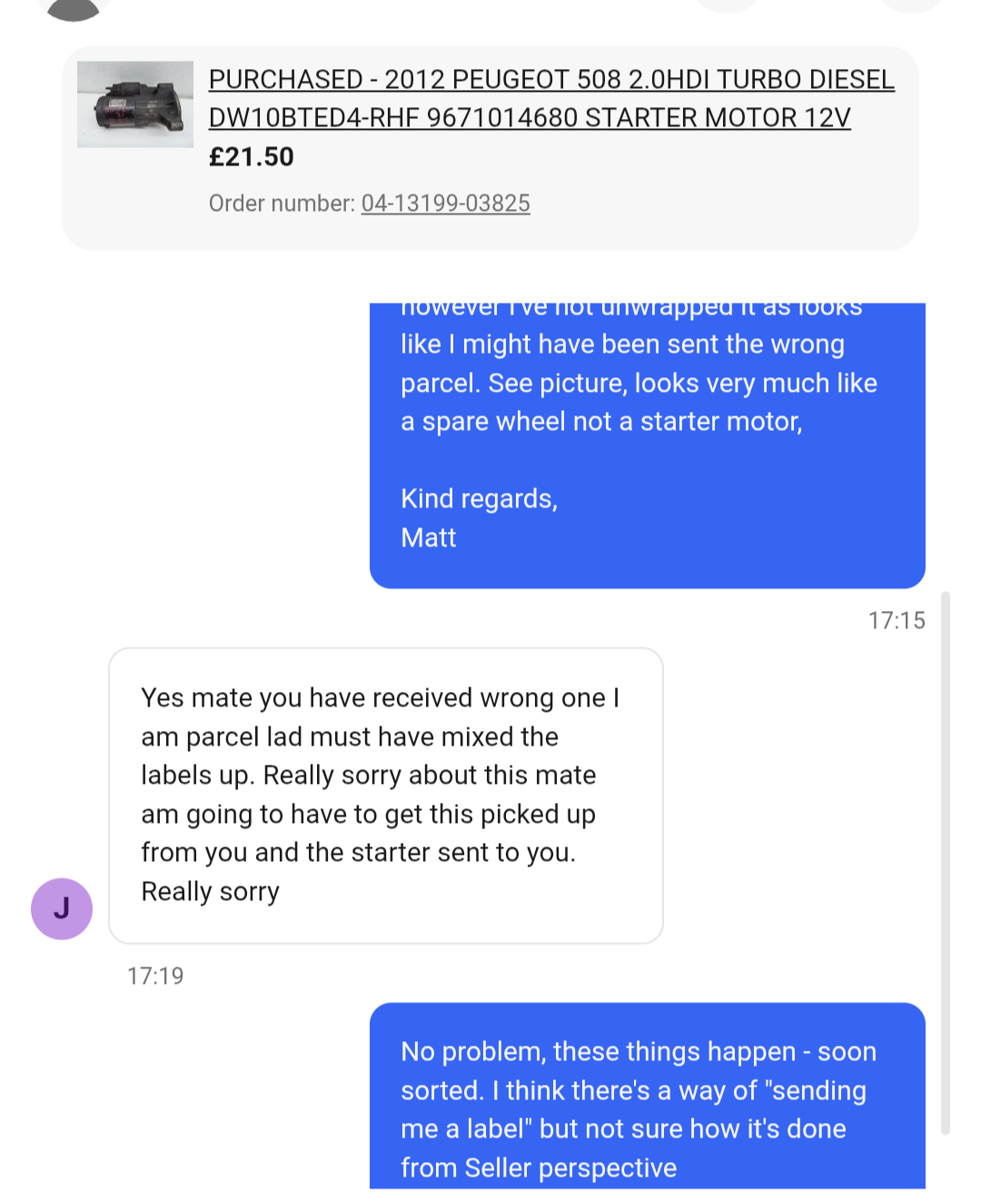

Hurrah! My cheap starter has arrived....
Not unwrapped it yet ...
Errr...
Hmmmm...
Spoiler: show
:?: :?: :wtf:
Posts: 21103
x 8100
Either you have a starter for a hovercraft or the wrong package? :-D

Posts: 55053
x 8378
Well, cut him a bit of slack... Such an easy mistake to make ;) After all, they're both round...

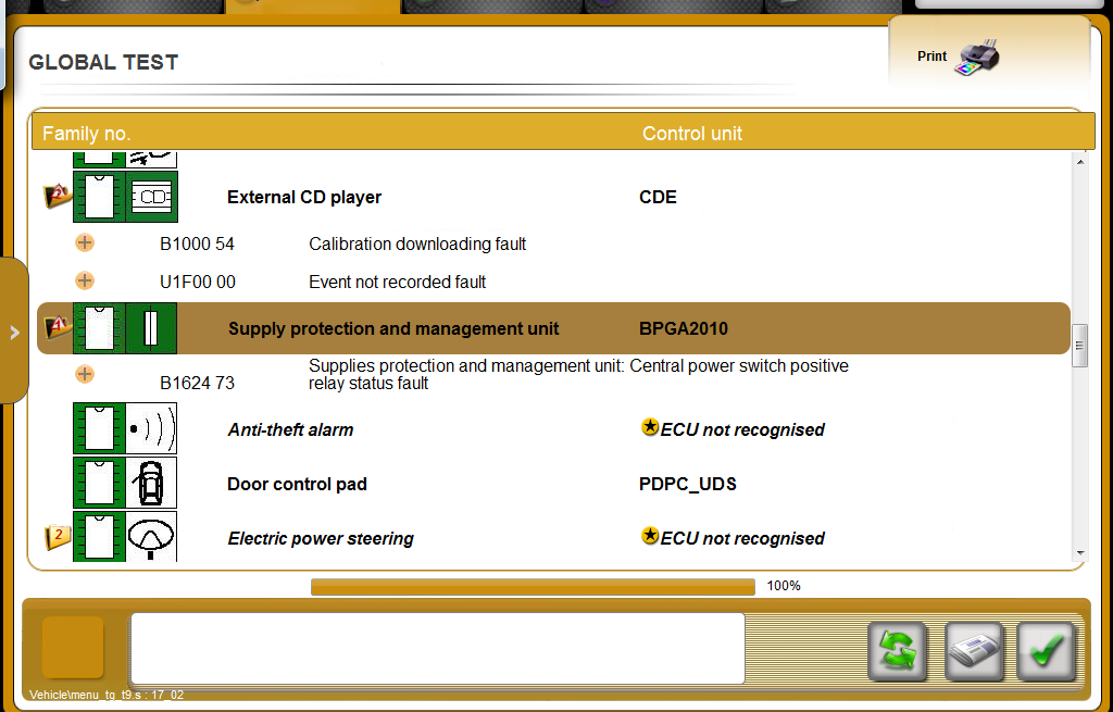

Unread post by MattBLancs »

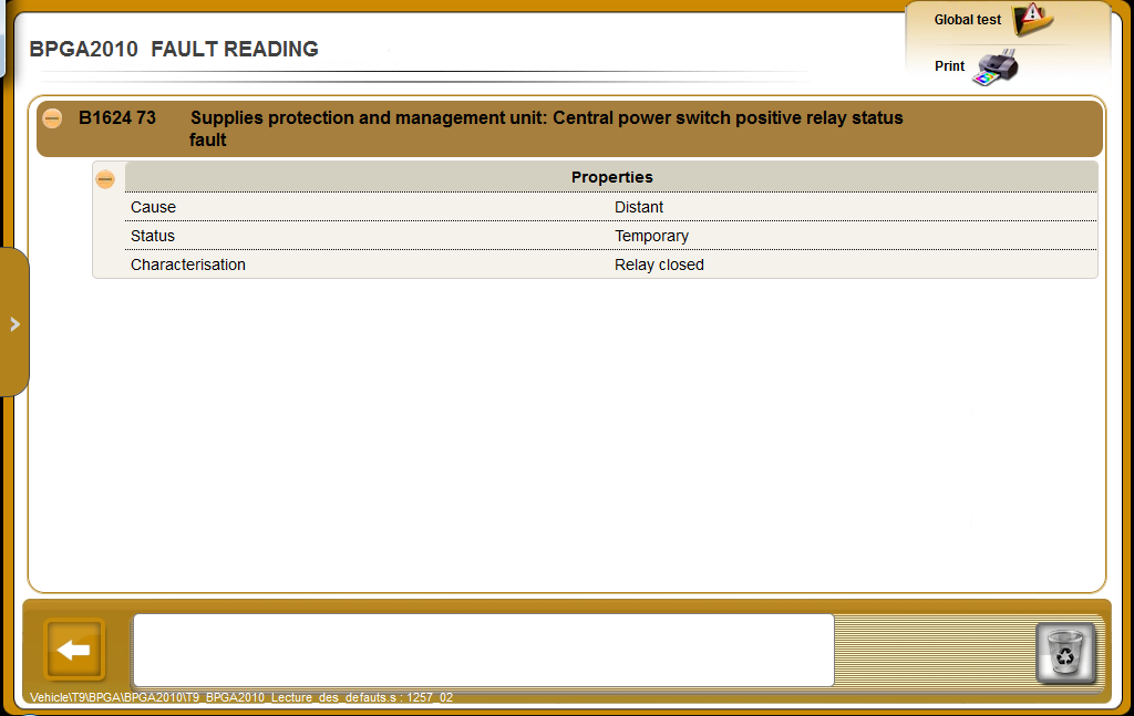

Trip to the tip (obviously, it's the weekend!) and
Electrical fault, have vehicle repaired
+ SERVICE light
Has made a reappearance. Started fine (both at home and 5 minutes drive + 10 minutes boot unloading later on way back from tip) and the SERVICE and fault message both didn't come back on the second start up.
Diagbox laptop on charge, fault code reading in a bit.
Thirty day window for return on my new BPGA, looks like it could still be being fitted! (Have not initiated the Return Process as yet)
Have a long trip away down to Bristol with work next week, so this isn't really the birthday present I'd like to pick up!! :D

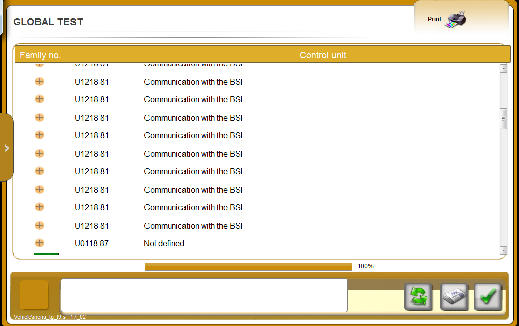

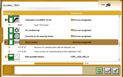

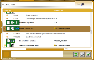

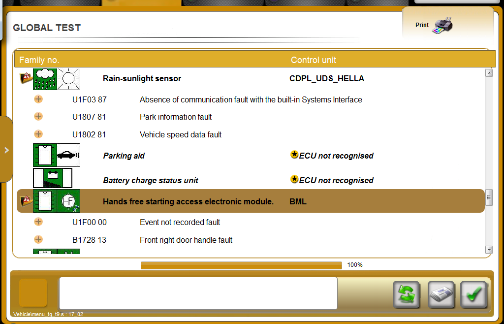

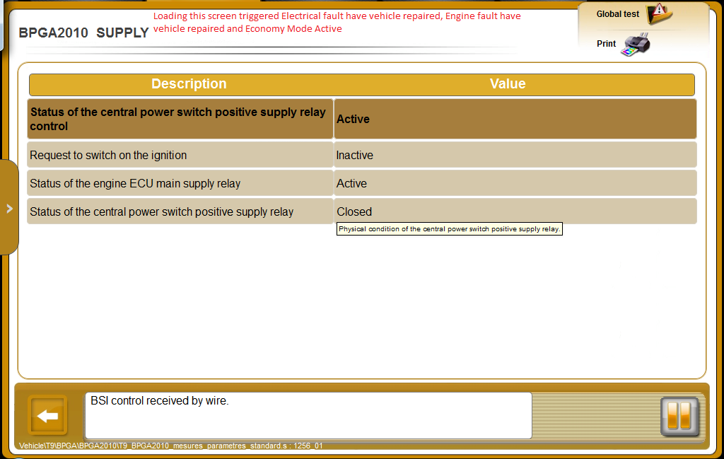

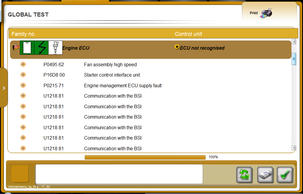

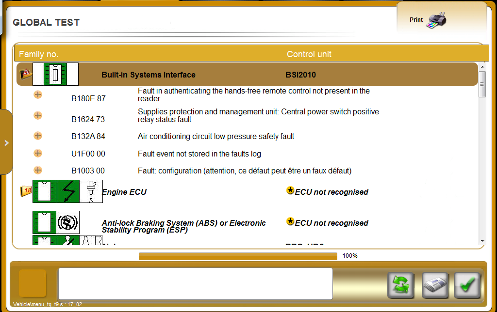

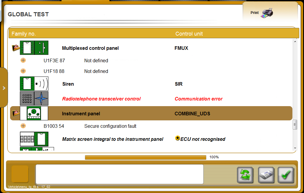

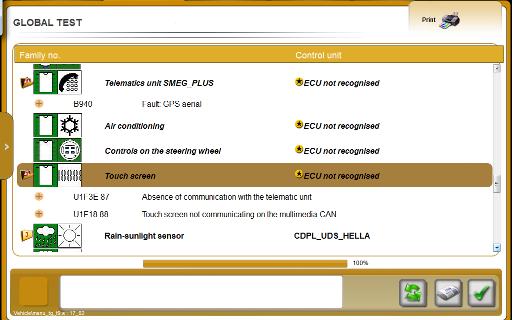

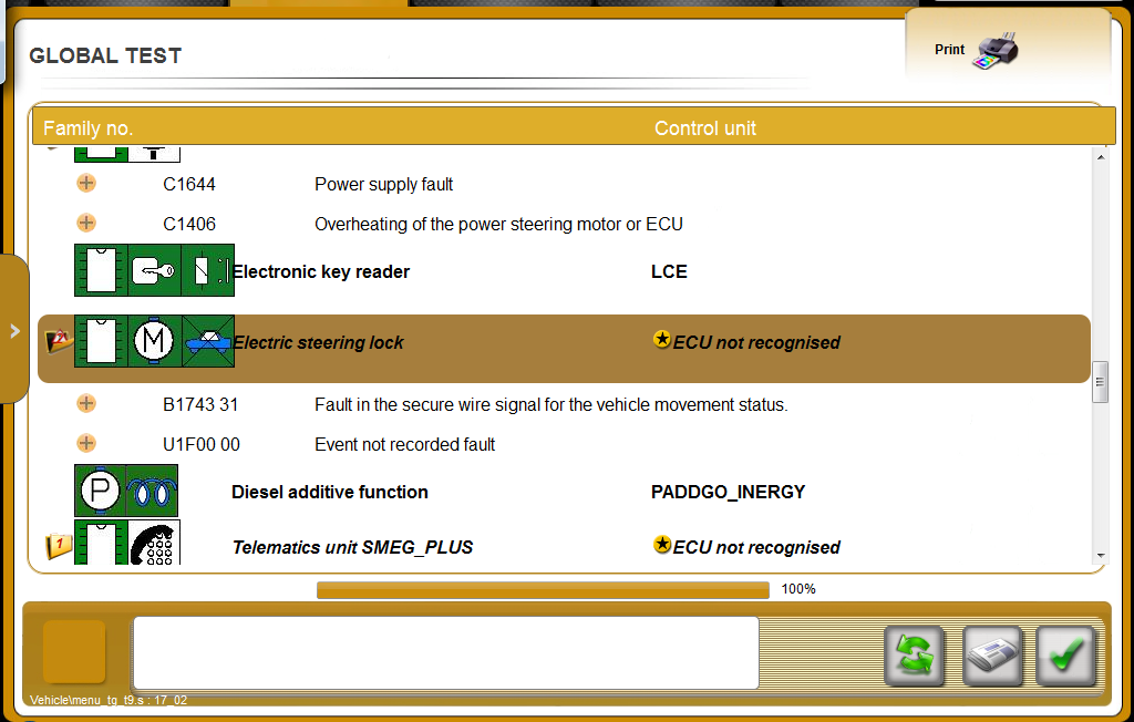

Quick download of the fault codes and few parameter screens etc
Going to swap in the new BPGA and get battery on charge.
blue 308 15.6.2025 errors 8 rain sensor and hands free starting_101951~2.png

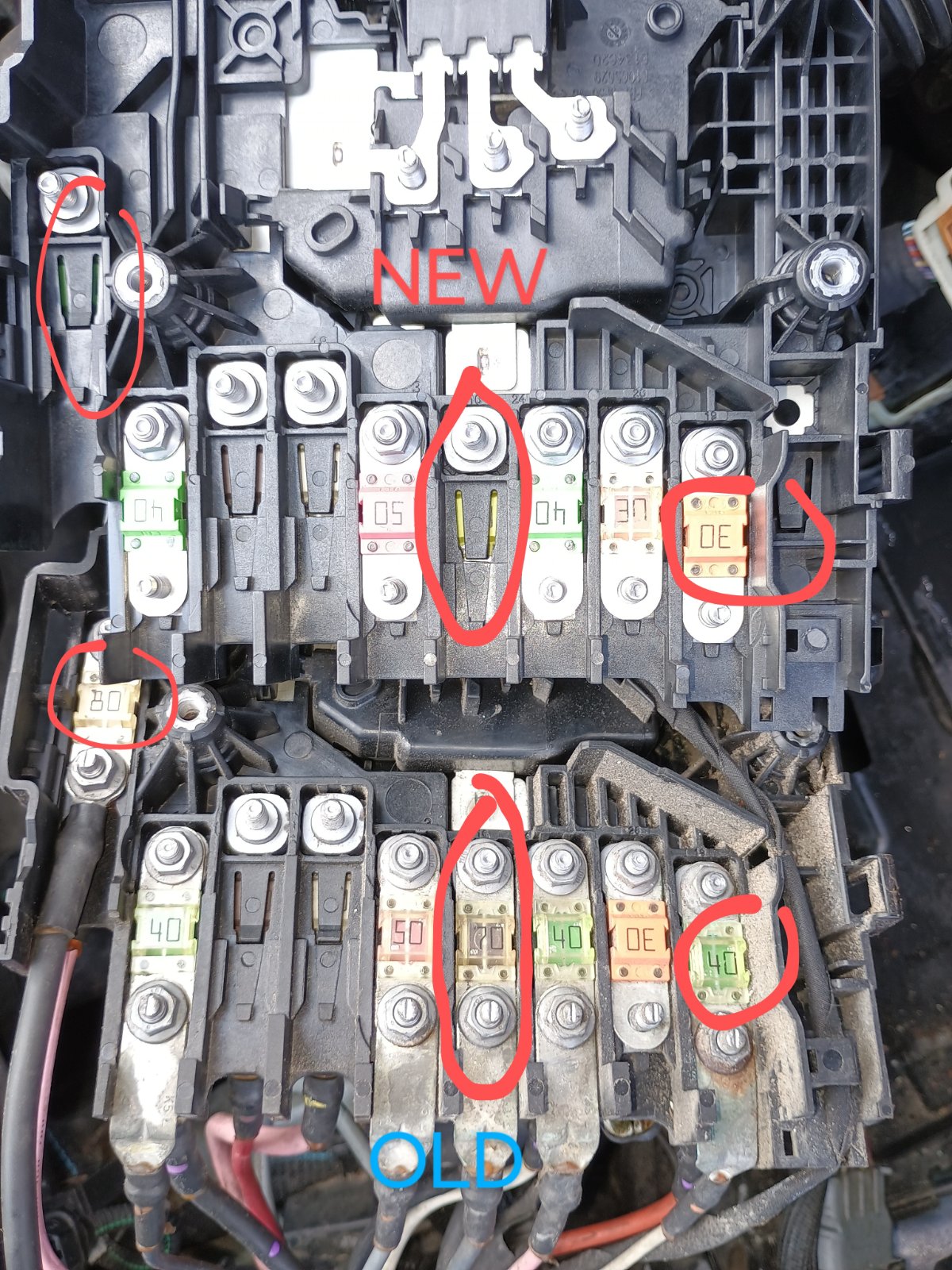

Comparison of BPGA units
