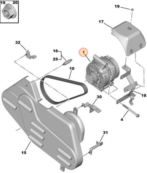

There are several options, depending on what is fitted (150 Amp or 180 Amp)dwjlivermore wrote: 02 Jul 2024, 08:53 Morning all
Could i please ask for the part number and price of the alternator fitted to my Citroen Relay - VF7**************[VIN obfuscated, can be read by forum staff] 2012
There seem to be a few options.
Many thanks
Darren
(1) New Bosch (0125711001) or (0125711102) Class 15 150A, part: 9674987580, £1010.83
Std PSA Exchange Alternator, Class 15 150A. part: 1638094680, £317.30
Std Exchange Bosch Alternator, Class 15 150A, (0125711001) or (0125711102), part: 1606430480, £620.45
New Bosch Alternator (0125811021) class 18 180A, part: 1609842580, £1171.32
Std Exchange Bosch Alternator (0125811021) class 18 180A, part: 1609845280, £682.45

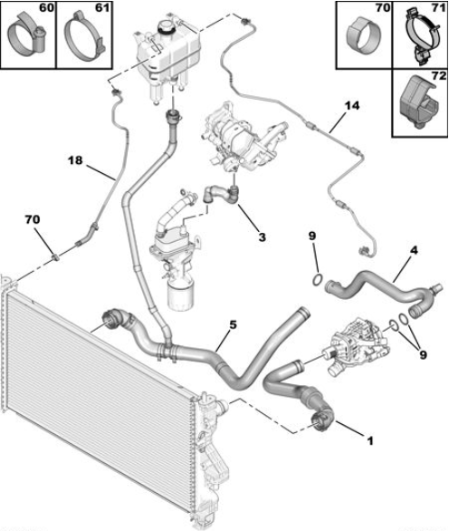

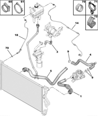

Citroen Jumper III 2016 (Euro6) - Requesting parts code for cooled EGR connection pipes
I'm opening a new topic requesting support with code number for the conduits connecting the EGR with the cooling system. I have to fix a leaking EGR (change it with a new one) and the mechanic asked for this plastic conduits to be replaced too, because there might be a risk of cracking them in the process. Although the engine was replaced around 140.000km ago, it seems like some components are still original, and the mileage of the van is 576.000km.
VIN no is: VF7**************[VIN obfuscated, can be read by forum staff]
I will be pleased to make a donation for the forum, with the occasion!
Reason: Post moved to the official parts thread
Those who don't know history are destined to repeat it!
- x 6946
Please let me know the item numbers from diagrams A or B below and I will provide you with the part numbers:
Click Image to Zoom
EGR Diagram A Cooling Pipes Diagram B
Click Image to Zoom
perfidus
- Posts: 93
- Joined: 13 Jun 2024, 09:16
- x 6
One of the pipes is no.3 Diagram B. I'm not clear yet where is the second one.
- x 6946
Diagram B, (3) Outlet Hose, part: 9675070980, £27.46

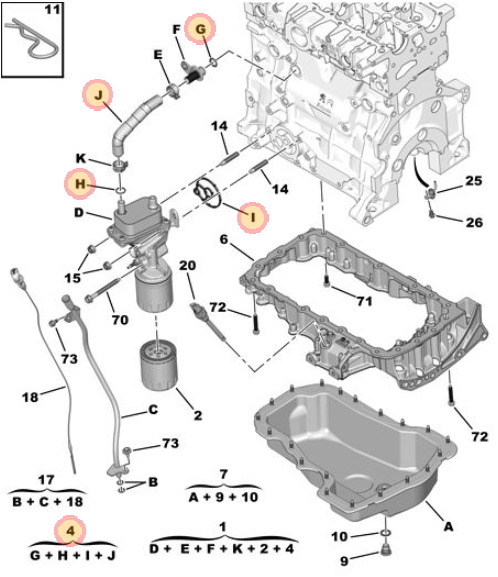

The second one is not marked on the Diagram B, but is near the no.3 pipe, the one that stick out of the oil cooler and return the coolant to the engine block.
- x 6946
Different system which comes under the oil lubrication section.
(4) Set of Oil Filter Support Seals, part: 9807439480, £24.74

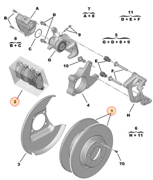

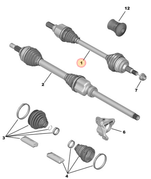

@Mexico14:
So the issue is that you got the last bit wrong in the last 8, which should of been 751 not 741 and this has resulted in the incorrect vehicle. Sometimes I can account for the first part if incorrect, but this relies on the last 8 being accurate, which unfortunately wasn't in this case.
Update
So disregard all previous information - I will go back and delete all the related posts as they are no longer relevant.
Here are the revised parts and diagrams now we have the correct VIN:
Rear Discs & Pads
(1) OEM 2 Rear Discs Kit Pro, part: 1609582880, £163.60
Cheaper Alternative Kit, part: 1687772580, £91.76
(2) OEM Original Brake Pad Kit rear, part: 1636413980, £105.58
Cheaper Alternative kit, part: 1619790880, £59.10
Driveshafts
(1) OEM Original Driveshaft (Left), part: 9808771480, £626.38
Exchange Driveshaft (Left), part: 1613306680, £380.03
Update
Rear Discs & Pads
Driveshafts
