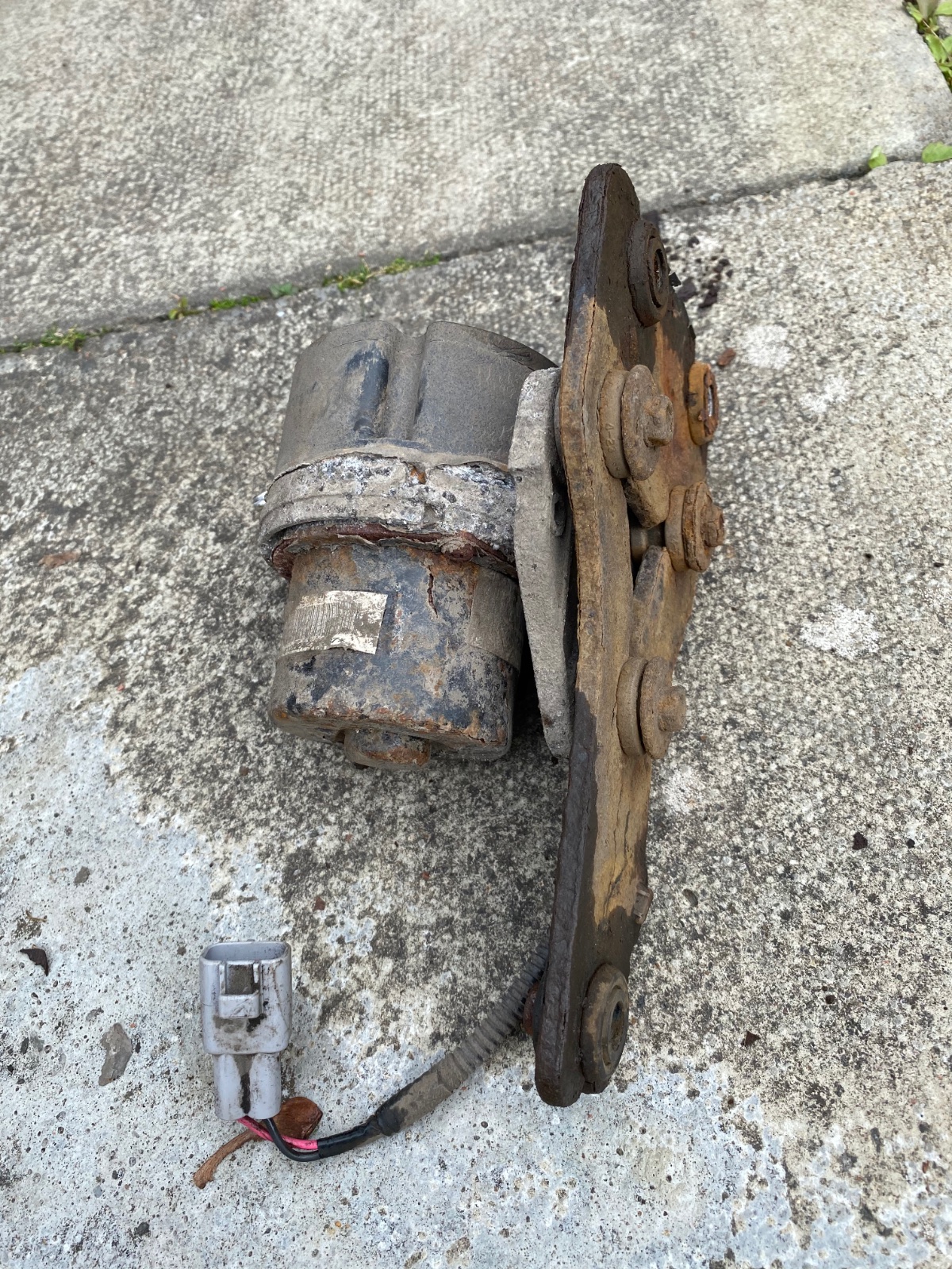

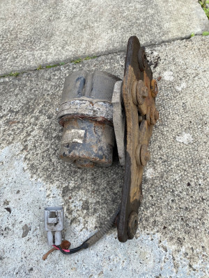

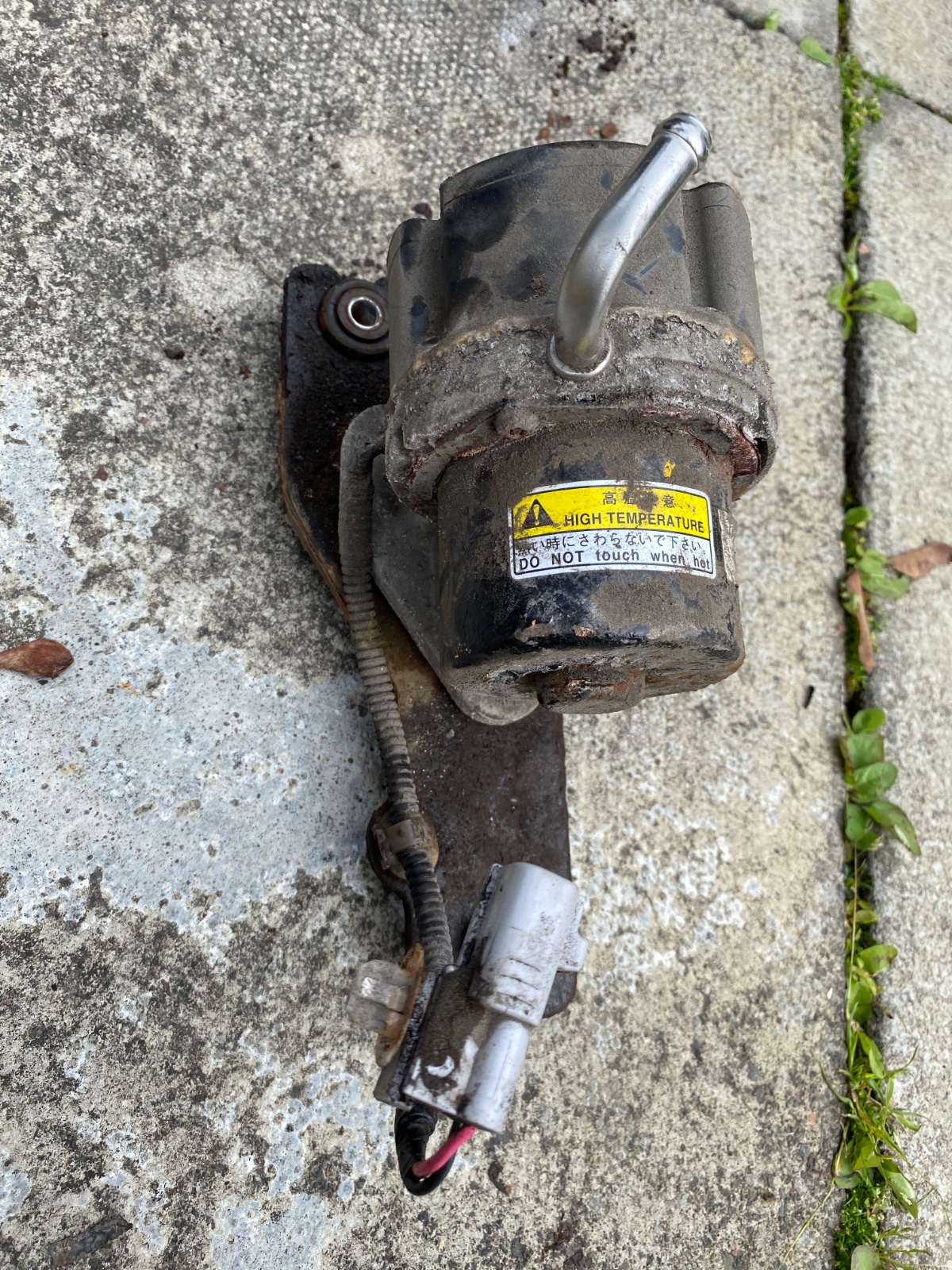

So I started liaising with the seller yesterday and guess what happened on the way home from work that very same day - the electric vacuum pump for the brake servo on the Ion failed, and rather abruptly! :shock: First a couple of miles away from home an exclamation warning light appeared on the dashboard but with no other symptoms. Unfortunately I had no real clue was the warning was for so I carefully kept driving intending to put Diagbox on the car as soon as I got home and at that point the brakes were still working normally. Then a minute or so later a warning buzzer came on and when I went to pull over the brake pedal was rock hard and basically ineffective. #-o And I mean really ineffective - pushing for all I'm worth would barely slow the car at all even from a low speed.
Luckily the mechanical handbrake still works (yay for good old fashioned mechanical hand brakes!) and so does regenerative braking lifting off the throttle. Regenerative braking is most effective at faster (>10mph) speeds while the handbrake is most effective at low speeds. Between the two of them I had enough braking to creep cautiously the rest of the way home with an extra buffer in front of me, but this car is definitely off the road and unsafe until the vacuum pump is replaced.
When I got home I could hear the vacuum pump running continuously (it normally runs for about 3 seconds after pressing the pedal to top up the vacuum then shuts off) and fluctuating in speeds making some "death throes" noises, eventually it slowed right down and stopped and never made a noise again so from the noises it was making I think it's actually had a bearing failure and seized up completely.
To say I'm a bit miffed is putting it very politely. I'm actually quite livid. These cars had a recall for defective brake vacuum pumps (think I've mentioned it before) around 2015, and according to Peugeot this car was up to date on its recalls when I bought it, however just a few years later (assuming they did really replace it - the one in the car looks very old to me) the pump has failed abruptly and left the car with basically no working foot brake. In theory you can push the pedal really hard and get usable braking with a vacuum failure however this was definitely not the case here - the only usable braking was hand brake and throttle lift off regeneration.

Replaced in 2016 under the vacuum pump recall ? I don’t think so Peugeot! :evil: They really are useless.
No way is that pump only 4 years old.

There might be a date on it somewhere.

Hah! If there is it’s totally illegible due to the rust and rot.

That's an annoyance! The price is ridiculous, but that seems to be the case with many of the parts for this car... At least there appears to be a route to getting it fixed for not too much cash. I would guess the recall was check and test, and only replace if it's really already knackered - yours must have passed!!
I imagine that anyone buying this will be an enthusiast so there should be no real problems - and you can sell up the fact that 2 known major problems are fixed. A bank transfer is the way to go, should arrive more or less instantly these days. Make sure you record the time as well as the date on the receipt, that way if the buyer trips a camera on the way home (unlikely I know!) you will have a defence.
