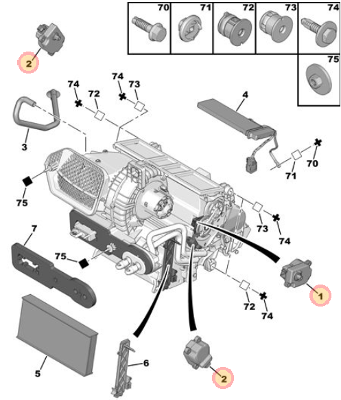

The driver side of the air con (for my C5) is just blowing out warm air. I believe it is likely the flap control system for that side has failed in some way. Please can I have the details for the parts? Thanks.

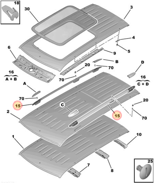

I would like to retrofit genuine roof rails to my 2020 Citroen Berlingo K9 (L1), black longitudinal ones with two fixing points(VIN: VR7**************[VIN obfuscated, can be read by forum staff] but probably do not show up because my car does not have these from the factory). However, if possible, please find the part number.

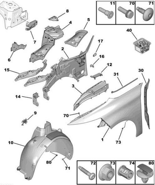

Hi MarcGiveMeABreak wrote: 30 Jun 2024, 14:39 @Paul1973: This is the front wing diagram, so any bits you need, let me know:
https://photos.app.goo.gl/eGW92E8mrEeTt7bf6

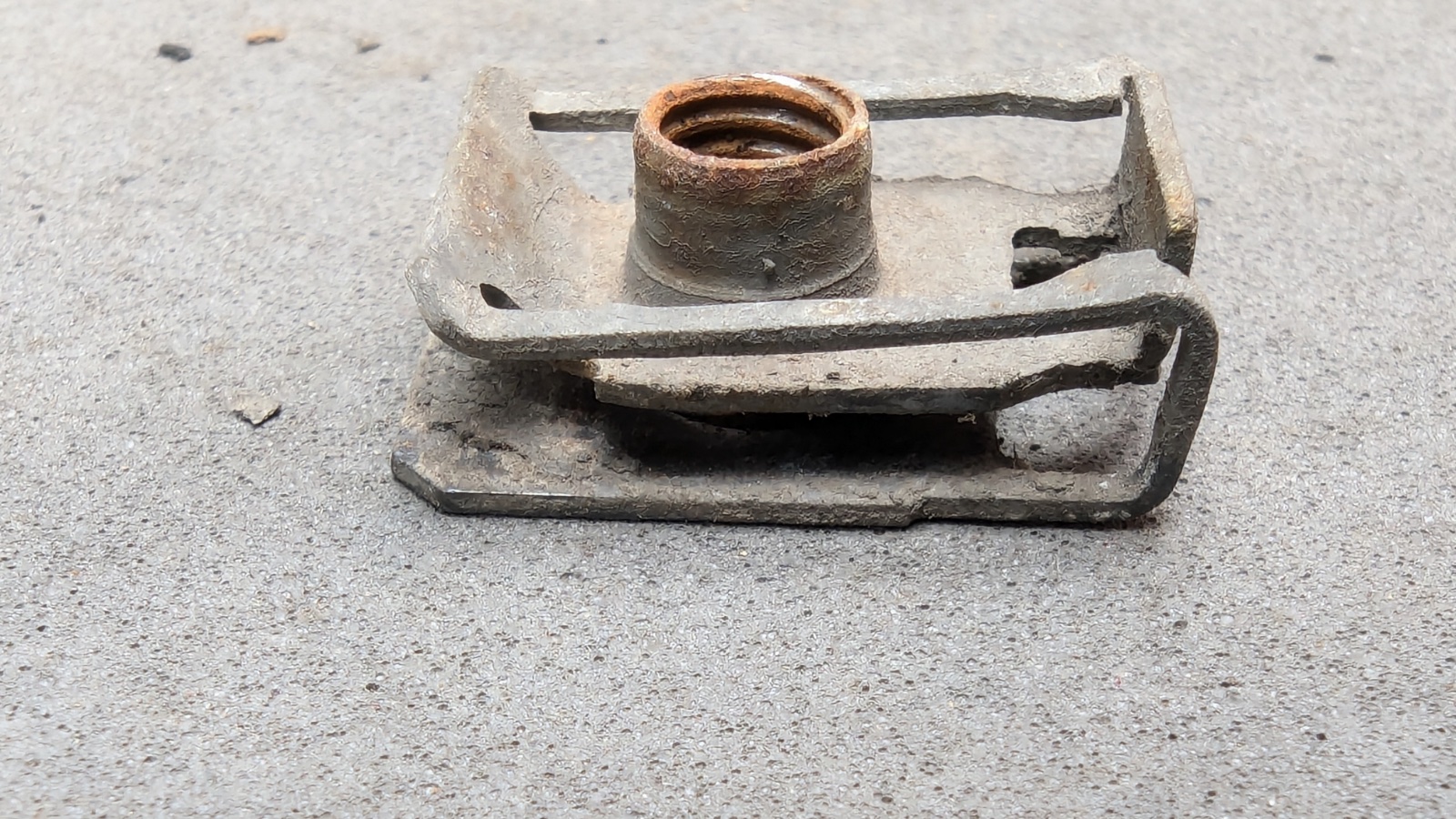

This is the part I am after. They are on the lowest part of the "front" end of the wheealrch liner and are used to secure item no 10 to item number 1 using a number 70 bolt

(1) Air Conditioner Reduction Gear, part: 6447RF, £130.57Hell Razor5543 wrote: 30 Jun 2024, 16:36 The driver side of the air con (for my C5) is just blowing out warm air. I believe it is likely the flap control system for that side has failed in some way. Please can I have the details for the parts? Thanks.
(2) Air Conditioner Reduction Gear, part: 6447RJ, £138.54
However, I'd seriously get an A/C service to pressure check and re-gas first, as these motors rarely fail, but what does fail is the flap control on the main evaporator housing, and that's a dash-out job to replace! The evaporator is 6450RH, £1279.99.
One other thing to check is a blocked heater matrix that can also result in warmer air on one side as the refrigerant evaporates back before it gets all the way round the system.

Ok, so there are different versions based on build date and also wheelbase.vaho wrote: 01 Jul 2024, 07:23 Hi
Thank you.
I have narrowed these down to the wheelbase, which I can't help you with as to which you have as it's not mentioned in the specifics.
(15) Roof Bar Onyx Black
Right with Wheelbase 2785, part 98177514XY, £308.29
Left with Wheelbase 2785, part 98177515XY, £308.29
Right with Wheelbase 2975, part: 98189004XY, £348.55
Left with Wheelbase 2975, part: 98189003XY, £348.55

Thank you, I have short wheelbase.

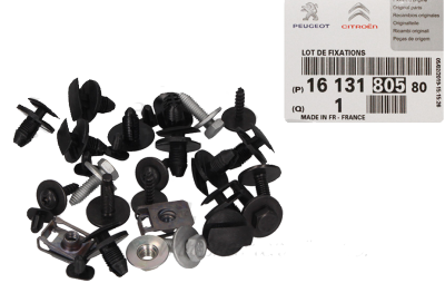

Ok, so in my previous diagram, see item (40), top right. These come in a fixing kit of front wing fixings and contain 2 of what you want. I have found a picture of the actual contents of the kit so you can see what else is in there. Part: 1613180580, £34.46Paul73 wrote: 01 Jul 2024, 12:43Hi MarcGiveMeABreak wrote: 30 Jun 2024, 14:39 @Paul1973: This is the front wing diagram, so any bits you need, let me know:
This is the part I am after. They are on the lowest part of the "front" end of the wheealrch liner and are used to secure item no 10 to item number 1 using a number 70 bolt![]()

Thanks Marc. The A/C was re-gassed last year, and it was properly checked at the time. The problem has existed since I got the car.GiveMeABreak wrote: 01 Jul 2024, 13:02Hell Razor5543 wrote: 30 Jun 2024, 16:36 The driver side of the air con (for my C5) is just blowing out warm air. I believe it is likely the flap control system for that side has failed in some way. Please can I have the details for the parts? Thanks.

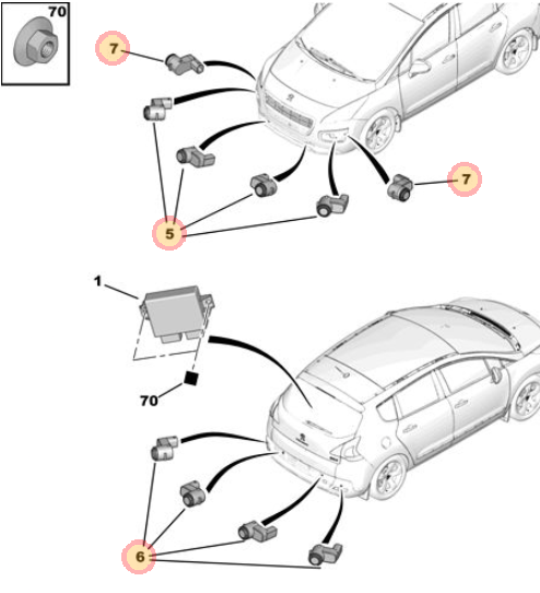

Hi, could I get the parts number for the various parking sensors (if the front forward, and side, rear back, and side are different) on a MK1 Peugeot 3008 (1.6 HDi 2014) please?

(5) & (6) Sensors are the same, part: 9677782980, £172.06 each
(7) Sensors are different, part: 611224880, £166.72 each

Sorry, one more thing. Can you please look up the part numbers of the plastic ends of the roof bars, marked A, B, C, and D.
