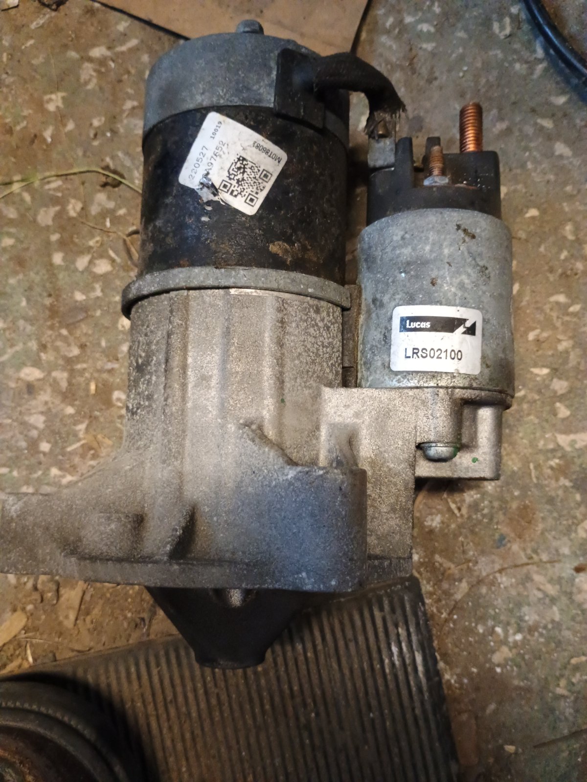

Certainly sounds like the starter motor/solenoid, assuming self contained, may be the problem rather than the BPGA to me Matt!! :)

mickthemaverick wrote: 09 Jun 2025, 18:11 Certainly sounds like the starter motor/solenoid, assuming self contained, may be the problem rather than the BPGA to me Matt!! :)
Yes, starter motor is now removed from the car. Thank goodness it's not a DV6 where the damn things on the back!

Solenoid is indeed knackered on the Lucas.
Going to see if I can get the ex- c5 starter into place. After quick visual to confirm number of teeth etc

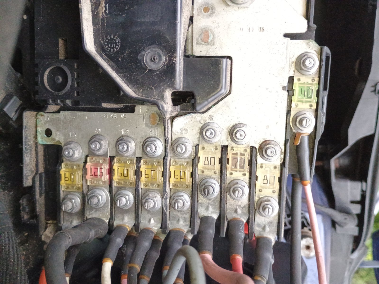

Cleaned up terminals and a subtle change.
Makes sense to me!
Spoiler: show
fuses are clear on one side, opaque the other. Swapped over to clear side = can see if any are blown, visual!
Don't understand why put in the other way up by default!?

Contacts all cleaned, both sides of the BPGA.

I'm guessing the fuses are the other way up simply for colour ID purposes? :)
Ie to cater for dyslexic auto electricians :rofl2:

mickthemaverick wrote: 09 Jun 2025, 19:50 I'm guessing the fuses are the other way up simply for colour ID purposes? :)
But not the colour blind ones :rofl2: (that's not a suitable career path, surely)
They were a random selection of ways up so the poor dyslexics might also have trouble with the "09" fuse next to the 70 and 125 either side of it.
