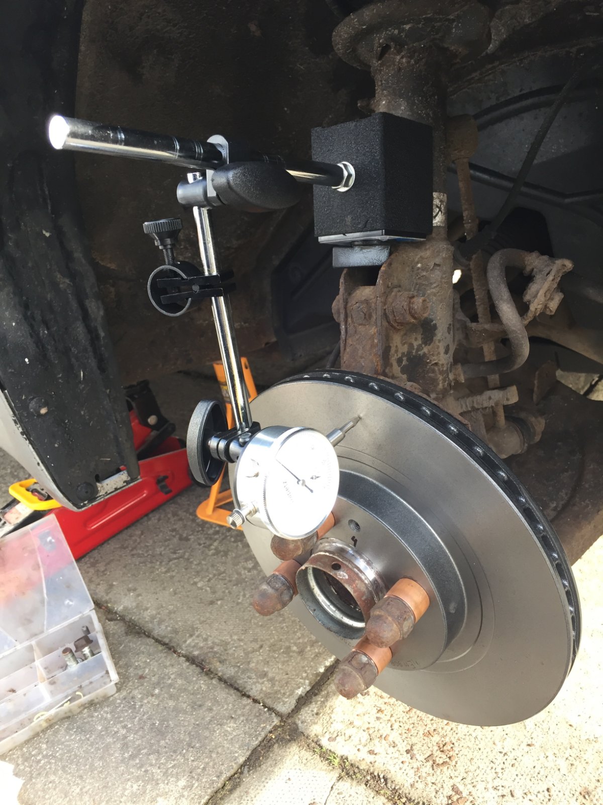

After recently learning how important minimising run out is when fitting new discs, this is the first time I've used a dial gauge while fitting discs and it was a bit of an eye opener! :shock: I'm so glad I got a dial gauge and thanks to Chris (?) for recommending one that was very affordably priced (just over £20) and has proven to be perfect for the job. =D>
When I fitted the last discs I did what in hindsight might have been a mistake - coating some copper grease between the disc and hub, something I've never done before. Unlike normal grease copper grease is quite thick and does have metallic copper in it so could potentially cause the disc to not sit perfectly true and introduce some run out - the article about run out (which I posted here a while ago) warned that even a tiny spec of rust between disc and hub can introduce significant and problematic run out and advised the surfaces should be scrupulously clean and free of any contaminants.
The article warns that even 0.1mm of run out is enough to initiate a chain of events that ultimately leads to thickness variation of the discs and vibration. Essentially the pads over time wear down the "high" sides of a disc with run out - which is the opposite angular position on each side of the disc. This reduces the run out on each side (as measured by a dial gauge on one side of the disc only) but introduces thickness variations around the disc which result in vibration under braking, which is probably exactly what has happened. The article recommended that run out of a new disc measured in the middle of the swept area should be no more than 0.04mm.
So I cleaned the surface of the hub with kitchen roll and "gunk" cleaner (similar to carb cleaner) to get all the grease off and did a test fit, numbering the positions on the disc so that I could measure the run out in each of the four possible fitting orientations. There is no retaining screw on these discs so it's necessary to put the wheel nuts on with spacers to perform the run out measurement:
The initial result was a little surprising and disappointing:
1 - 0.1mm
2 - 0.08mm
3 - 0.13mm
4 - 0.1mm
So if I had just slapped the disc on without measuring the run out and hoped for the best, even though I gave the hub surface a cursory clean, I could have ended up with anywhere from 0.08mm to 0.13mm which is far too much according to the articles I've read, and would definitely lead to thickness variation over time. So the disc came off again and I felt the surface of the hub carefully with my fingers and could see and feel very slight raised bumps in a couple of places - not sure if it was corrosion or something sticky, but something was there so I got out some kitchen steel wool (the fine stuff with soap in it) and gave the surface of the hub a good hard scrub and managed to remove whatever it was on the surface until it felt smooth. Whatever it was was quite resistant to being removed and needed a lot of scrubbing.

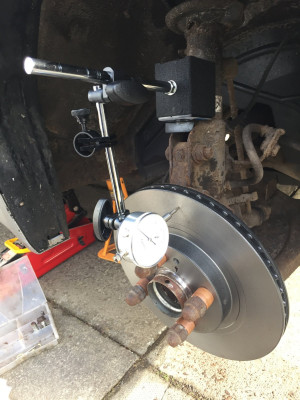

I then retested the fit and run out and got:
1 - 0.05mm
2 - 0.04mm
3 - 0.04mm
4 - 0.05mm.
About a factor of two improvement and also virtually no variation with fitting orientation. =D> I then nipped the nuts up a bit tighter with a socket and the figure reduced to 0.03mm and I was happy with that and continued with the pads etc.
On the other side of the car I just went straight to scrubbing the hub scrupulously clean with the steel wool, then on first fitting I got:
1 - 0.04mm
2 - 0.03mm
3 - 0.02mm.
I didn't test position 4 because by the time I got to 3 it was already better than the other side of the car so I was more than happy with it and just left it there. (I suspect it would have measured 0.03mm anyway)
So I'm very glad I had a dial gauge to test this and would whole-heatedly recommend anyone fitting new discs not only to take extra effort to get the hub face scrupulously clean (it needs scrubbing with something slightly abrasive like steel wool) but to also measure the run-out to verify that it is sufficiently low. If a spec of rust got trapped between them you'd immediately pick that up with the run out measurement. Even the 0.13mm run out was invisible when eyeballing the disc.

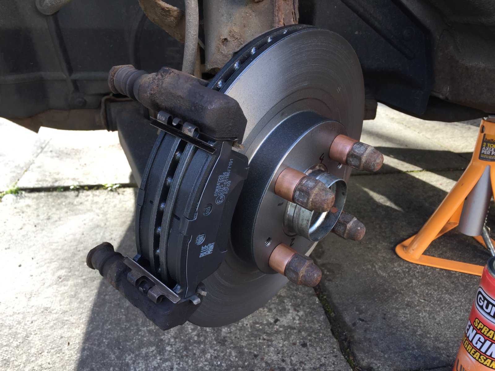

The discs are Brembo but I ended up buying "Blue Print" pads, partly because I liked the load spreading shims they came with, which some of the other pad brands did not have:
Unfortunately, exactly like the Apec pads that I fitted last time, the total pad length from ear to ear is at least 0.5mm longer than the gap available to insert them! #-o It's physically not possible to force them in, and even if you did they would be jammed and would not be able to move freely. So just like last time I had to file a good 0.5mm off the tips of each ear on the pads to get them to fit and allow a slight bit of vertical slack (taken up by the spring shims) so that the pads don't jam over time. I'm not particularly happy about doing that because it means filing the anti-corrosion layer off the ears which means they will rapidly rust at the tips - but I don't know what else I can do if they won't fit ?
That's two different after market parts brands with the exact same problem - so is it the car to blame or the dimensions of the pads ? I don't know... in every other regard the pads seem to be of good quality.
The caliper slide pins were still in perfect condition, still greased from last time and moving freely so I left them alone. I then put everything together and went for a long drive to bed them in gently, as I think in the past I have also been a bit aggressive in bedding in new discs and pads. I ended up driving out to Richard's neck of the woods and testing his local rapid charger... :lol:
Since then I've also driven to work today and so far at least it has been a resounding success. =D>
1) No more constant vibration from the front at motorway speeds. (even with the brakes not applied) This would have been the intermittent rust spiral at the edge of the disc hitting the pads and/or run out.
2) No more vibration when braking from high speeds. (No more thickness variation or run out)
3) No more grinding when applying the brakes at low speeds, or any speeds for that matter. (No rust)
4) Nice sensitive bite especially when pulling to a stop, but progressive and controllable. (Good, even pad contact with the surface of the disc and no rust)
It's totally transformed the brakes of the car from "Meh" to working very nicely and with a good "feel" to the brake response. Hopefully the coating on the Brembo discs will resist corrosion a bit better than the Apec ones, especially around the vents, and hopefully now that the run out is extremely low there won't be any odd wear patterns to the discs that will introduce thickness variations over time.
