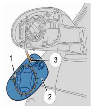

Is it just the mirror glass you want to replace?
- Posts: 14308
- x 3306
Re: My turn for a C5!
Well, the glass mirror and mounting. The fairing, etc., are undamaged.
I seem to remember they just pull off and pop/push back on.. that could just be me using brute force again though. In any case doesn't matter if you break the one coming off.. you'll be able to see how it fits then
In the photo on the ebay ad, you can just make out the loops at the end of the spring clip (at about 4 o-clock on the plastic ring). If you adjust the mirror to be pointing towards the centre of the the car and up, you should be able to reach those loops and lever them outwards to release the glass.
xantia_v6 wrote: 29 Nov 2018, 18:46 In the photo on the ebay ad, you can just make out the loops at the end of the spring clip (at about 4 o-clock on the plastic ring). If you adjust the mirror to be pointing towards the centre of the the car and up, you should be able to reach those loops and lever them outwards to release the glass.
Thanks, so they will be at the eight o'clock position when on the car.
You just gently lever off the glass with a flat blunt tool at position 1 - there's a clip. When refitting make sure the spring clip is correctly located back on the new glass and then snap it back into place.
Got the new mirror, but it does not have the circular spring clip (I will grab that off the old one when I remove it, assuming it fits). Something else astounding about the 'new' car is that she has both of her security cards, un-scratched!!!
The new mirror is not a self adhesive unit, but looks a lot like the one in Marcs' diagrams. All it is missing is that circular spring clip.
Right, well, the mirror is fitted (it just clips in, there was no spring clip on the old mirror), and she has also relieved me of around £220, due to a leaking radiator. When I was driving her down from Sheffield I pulled over to eat, and when we tried to head back out she complained about the coolant. I had to use still spring water, and (a couple of days later) she also drank some deionised water. However, PTS spotted some bubbling from the bottom of the radiator, that has been replaced (and proper coolant added), and there are no other signs of leaks. All I can now hope for is that, prior to my ownership, she has not been allowed to overheat.
