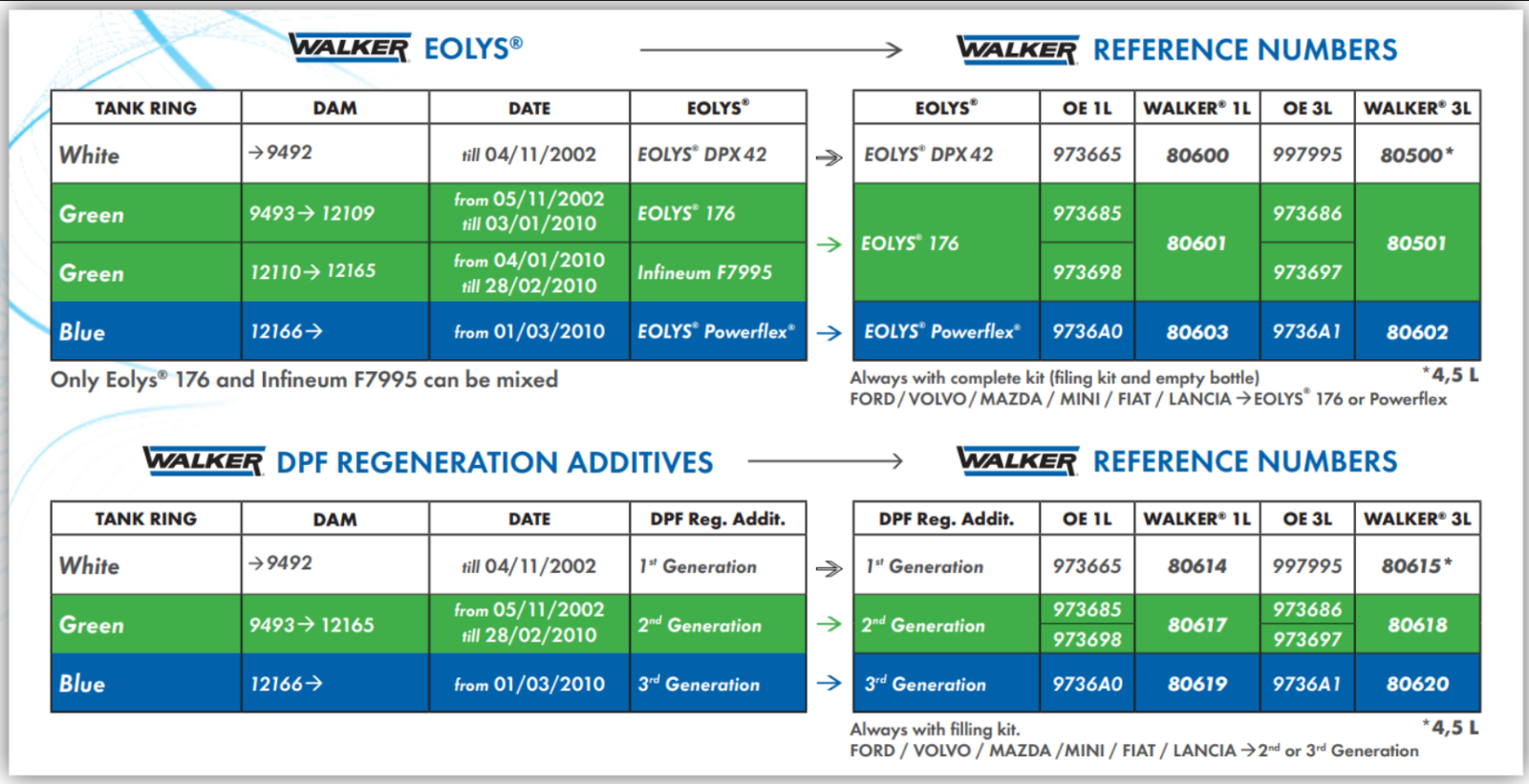

Okay guys, thanks very much. I also thought that Powerflex is the right choice, but some mechanics were confused by green color on the tank connector. Therefore I decided to check your opinion on this. Many thanks.
- x 6946
Re: DPF Fluid- which one to choose?
Yes that was the general rule official rule - but it was not reliable as sometimes they used older stocks of additive tanks up on newer models, which could lead to the confusion and the wrong fluid being added. Another reason is that if an additive supply pipes / tank unit have been replaced with a second hand part, then that can also lead to the wrong fluid being used.
So always go by the build date (RPO / DAM) as that reflects the Euro Emissions standards and engines fitted at the time. Use this guide to determine the correct additive. It shows your build date and the type of fluid.
For vehicles built from 1st March 2010 Powerflex was used. But if I had a vehicle built on or very near to this date with a 'Green' connector, I would double check with the dealer so there was no come back as it was near the switchover date.
But as your vehicle was build 28th January 2016, that is 6 years after Powerflex was introduced, so it will be Powerflex you need.

HI guys, can anyone help with some info. I need to top up my DPF additive for a 2014 DS5 but I can't find reliable information about what type of additive and how much does it go in.
Is Eolys Powerflex gen 3 the correct additive?
My VIN: VF7**************[VIN obfuscated, can be read by forum staff]
Thanks!
Thanks!
- x 6946
Re: Eolys?
@Vladm: Your build date is 13581, (14th January 2014), and your vehicle is Euro 5, so Blue Powerflex.
