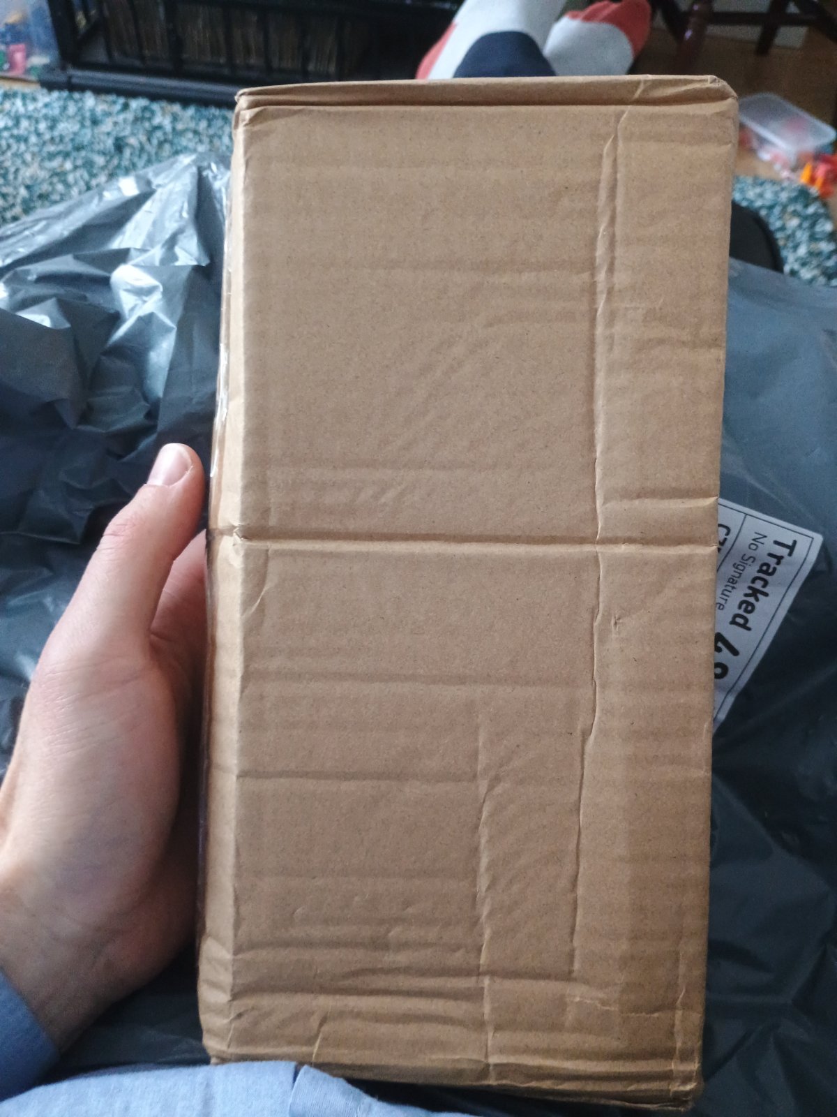

Cheap tat off the internet news update: yippee, a parcel has arrived inside which...
... Are these smaller exciting parcels...

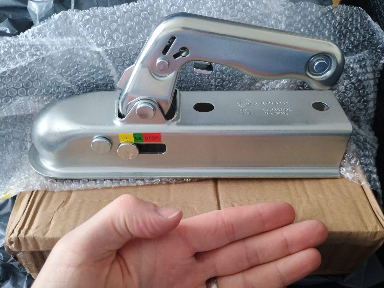

Ta da!
Seems fine! :-D

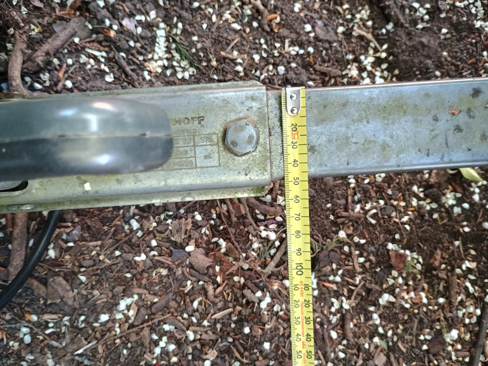

I thought I'd leap into action ahead of starting work so could fit that new towbar hitch. It seems today is going to start with one of those "assumption makes an ass of you and me" lessons.
Here is the draw bar of my daxara trailer:
50 mm box section
50 mm box section
Note: there is nothing presently wrong with this tow hitch.

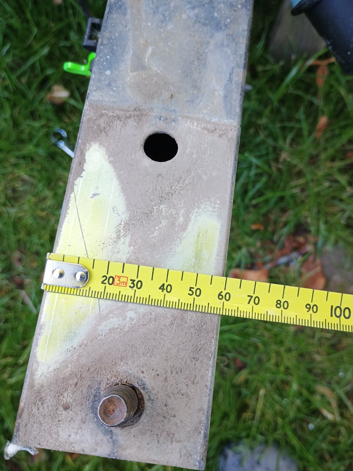

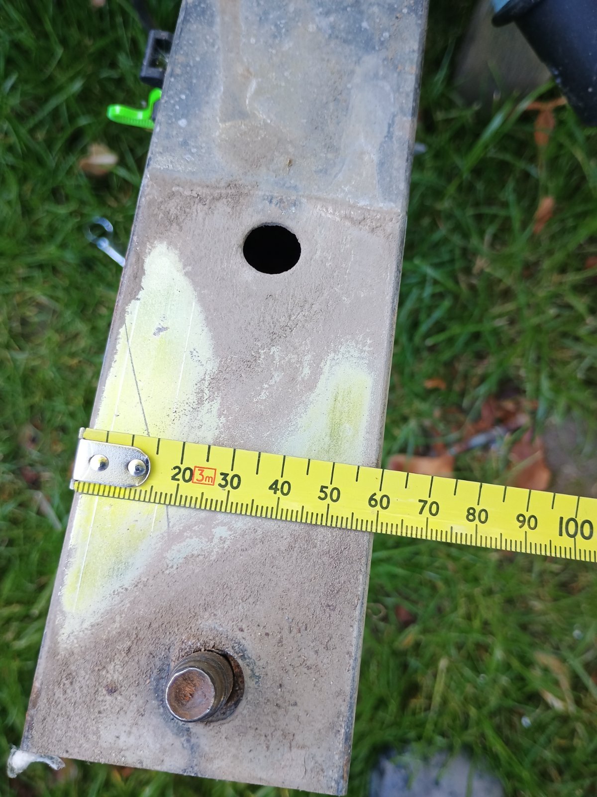

Here in contrast is the drawbar of my other Franc trailer:
60 mm box section!
60 mm box section!
This is the one with I suspect that failed spring internally.
Guess which size hitches I bought!? #-o

Potential plan:
Sleeve inside the 60 mm box action with a piece of 50 mm box section (I have some lying around from former big trailer chassis, bit rusty but should clean up) picking up the two existing hitch bolt holes as pictured and with two holes in the 50 millimeter to suit the new hitch.
Slightly lengthening drawback will slightly reduce its jacknife whilst reversing tendances so no downside in that regard.
