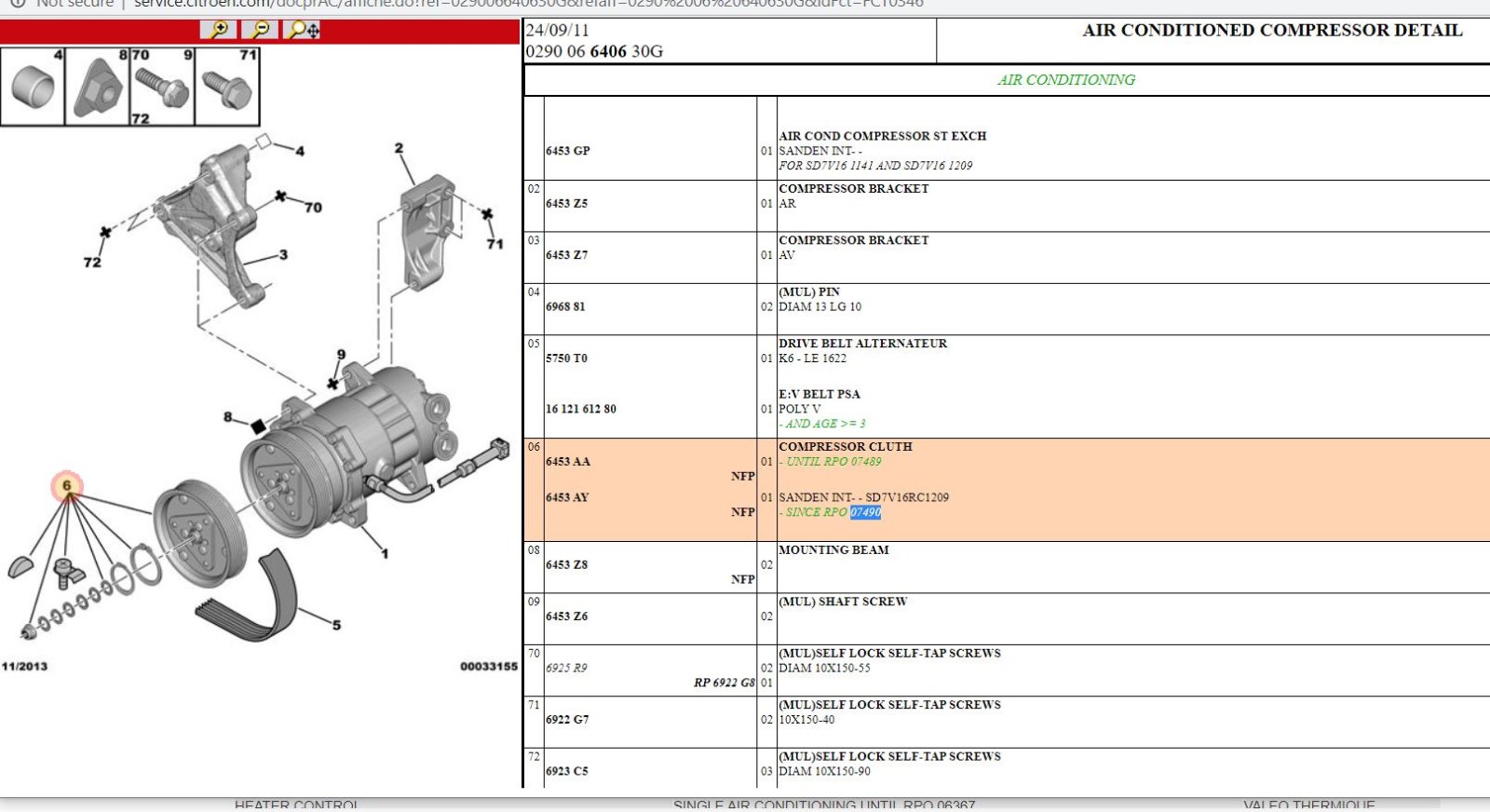

I didn't mention this before but when I brought the Xantia out of several weeks disuse on Sunday to cover for the off the road Ion I was greeted with this:
At the time I took the video on Sunday I wasn't sure what the noise was and whether it might be the bearing on an idler wheel but I've since decided that it's probably the clutch in the air-con compressor dragging, (rusty ?) as when I turn on the aircon the scraping noise stops.
However this is complicated by the fact that the gas pressure in the aircon system is low and overdue for re-gassing, as such the pressure switch doesn't quite trigger when the engine is cold and it's not until the engine has warmed for a few minutes that the clutch will engage.
Also, I can't actually tell whether the aircon is working now - it's efficiency was already down on what it should be due to (presumably) low gas pressure, it will still engage the clutch, however when it does, I can't particularly say that the aircon is working as it still struggles to clear fog off the window and I don't hear the slight "woosh" of pressure that you normally hear through the evaporator when the aircon system starts pumping.
Initially the noise seemed to go away and I thought maybe there was just some rust on the clutch due to sitting a long time in this horrible weather, but the noise has got worse during the week, and while it comes and goes (possibly because the A/C won't stay on continuously due to low pressure) it can be a bit scary sounding sometimes and it's actually starting to sound like the bearing on the clutch pulley may be stuffed as well, and maybe a stuffed bearing is allowing the clutch to wander out of true and start scraping ?
Hard to tell because even when the clutch is engaged (and thus not a source of noise) the A/C compressor itself is pretty noisy and has been noisy for quite a while even when it was working. Not sure if it's noisy because it's faulty or just due to low gas pressure.
So I'm in a bit of a bind now. I have no other car to drive so I'm forced to take the risk and keep driving it until I can fix the Ion or buy a car to replace the Ion. I was already actively looking for a 30kWh Leaf to replace the Ion before its charger went kaput but was assuming I had the option of a part trade available but with that car broken and off the road I don't at the moment so that makes buying a lot harder.
Does anyone know whether the clutch pulley assembly (including clutch bearing) on the A/C compressor can be removed and replaced with the compressor in-situ or indeed at all ? Or is it a permanent part of the compressor in which case I'm looking at a replacement compressor ?
Can the actuator mechanism of the clutch be lubricated at all in case it's sticking and not retracting properly ?
If the compressor needs replacing as well that's a job for someone else to do as they'll need to gas the system up again afterwards as well. Are second hand A/C compressors available and usable ? I've never had to change the A/C compressor before in a car so have no practical experience of this.
What a mess...two cars and they both let me down at once...

- Posts: 12600
- x 1491
Re: Simon's new Xantia V6 and Peugeot Ion blog
Doesn't sound very happy....
A replacement clutch unit used to be available, but now NFP
Mind you, at £385 for the early one, and £454 for the later one, that's no bad thing!!
This time of year, the AC is probably dropping in and out due to the ambient temp. You could wire 12V direct to the clutch so it was always on... other short term alternative is to fit a shorter belt bypassing the compressor - don't know how practical this is on the V6.
My version of the docs shows a procedure for replacing the clutch, but it is with the comp off the car, whether or not you can do it on the car will depend on how much room there is between the pulley and the chassis rail, but you will need special tools anyway.
Mandrake
- Posts: 8692
- Joined: 10 Apr 2005, 17:23
- x 695
Looks like you can get an entire brand new compressor with clutch for £213!
https://www.autopartspro.co.uk/nissens-7522507
At that price for new I'm not sure it's worth messing around trying to replace only the clutch on an old compressor when there is a question mark over the compressor itself now as well as it doesn't seem to be cooling even when the clutch engages and has been very noisy (engaged) for the last year or two when it was working... maybe replacing just the clutch and re-gassing the system would be enough, maybe not!
Perhaps I should just get a quote from my trusted local indy on fitting a whole new compressor and gassing the system up - I was going to ask them to re-gas the system before this latest clutch problem happened anyway....
