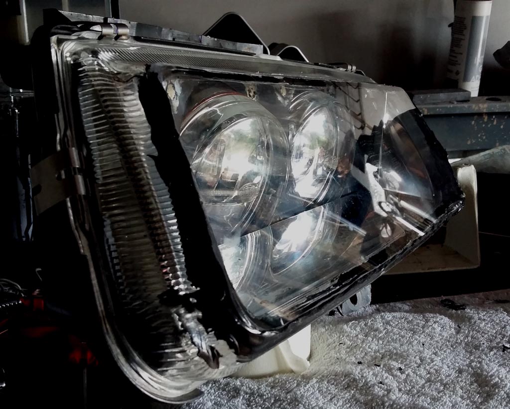

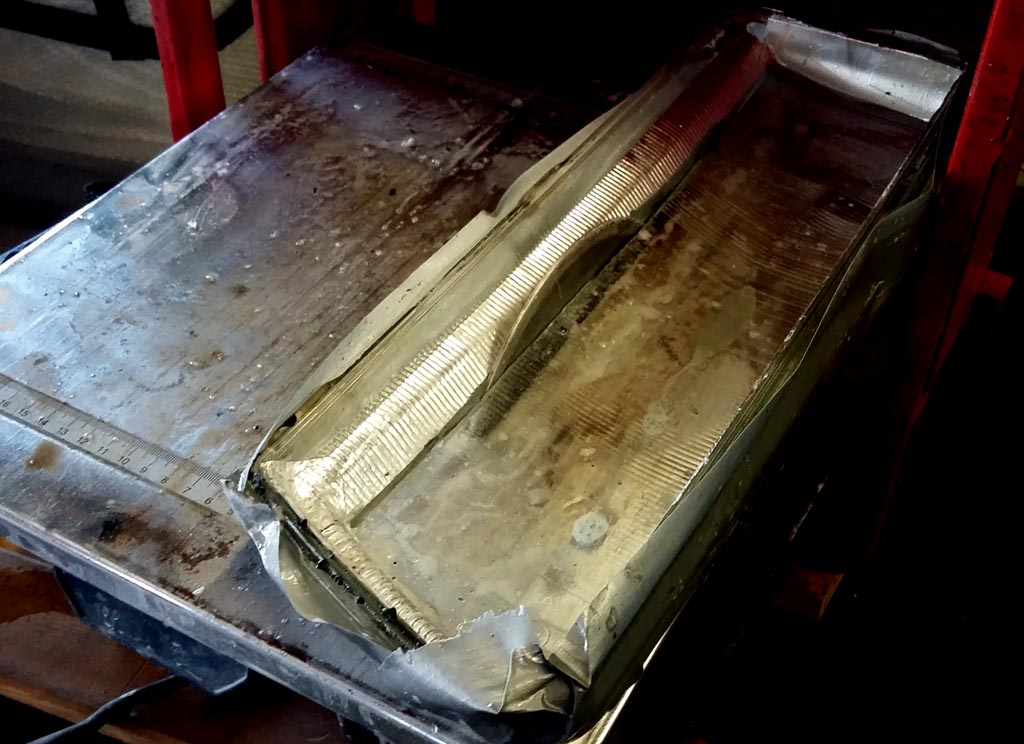

More headlamp work.
A TEST of adhesive (so not in anyway neat) strength on the 3mm clear lexian sheet I have obtained........seems to work

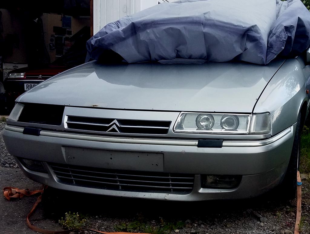

Headlamp conversion work progress....testing is getting there.

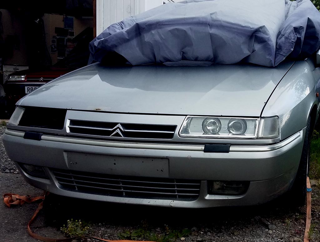

Gosh! That headlamp test has made the paint fade a bit Alasdair :lol:
And destroyed the front numberplate! They must be powerful ;)

Unread post by Stickyfinger »
the sun fades red lot..but zero lacquer peel :)

Cutting out the headlamp glass
