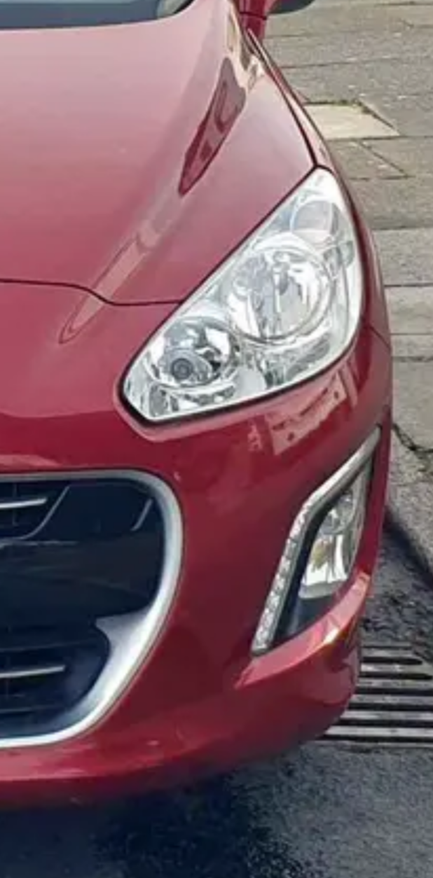

It's a good guess, I'm not sure, but I think all the "facelift" 308 had LED daytime running lights in the bumper, as per this one and I also think the "pre-facelift" first generation 308 had different headlamp units (slightly different shapes between them, I think!)
Plenty of I thinks there to be honest! :)

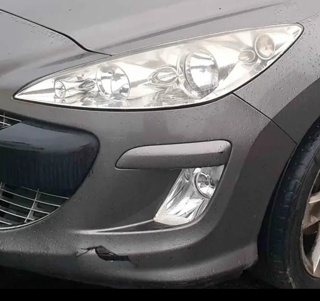

MattBLancs wrote: 21 Apr 2025, 20:20 the "facelift" 308 had LED daytime running lights in the bumper, as per this one and I also think the "pre-facelift" first generation 308 had different headlamp units (slightly different shapes between them, I think!)
Pre facelift headlights
Vs
Post facelift
Post facelift

In fact that red one shows the bonus bulb reflectors quite clearly!
