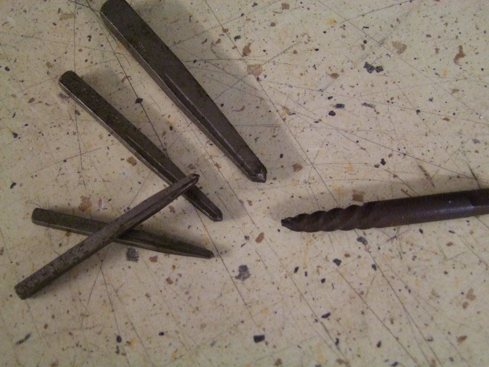

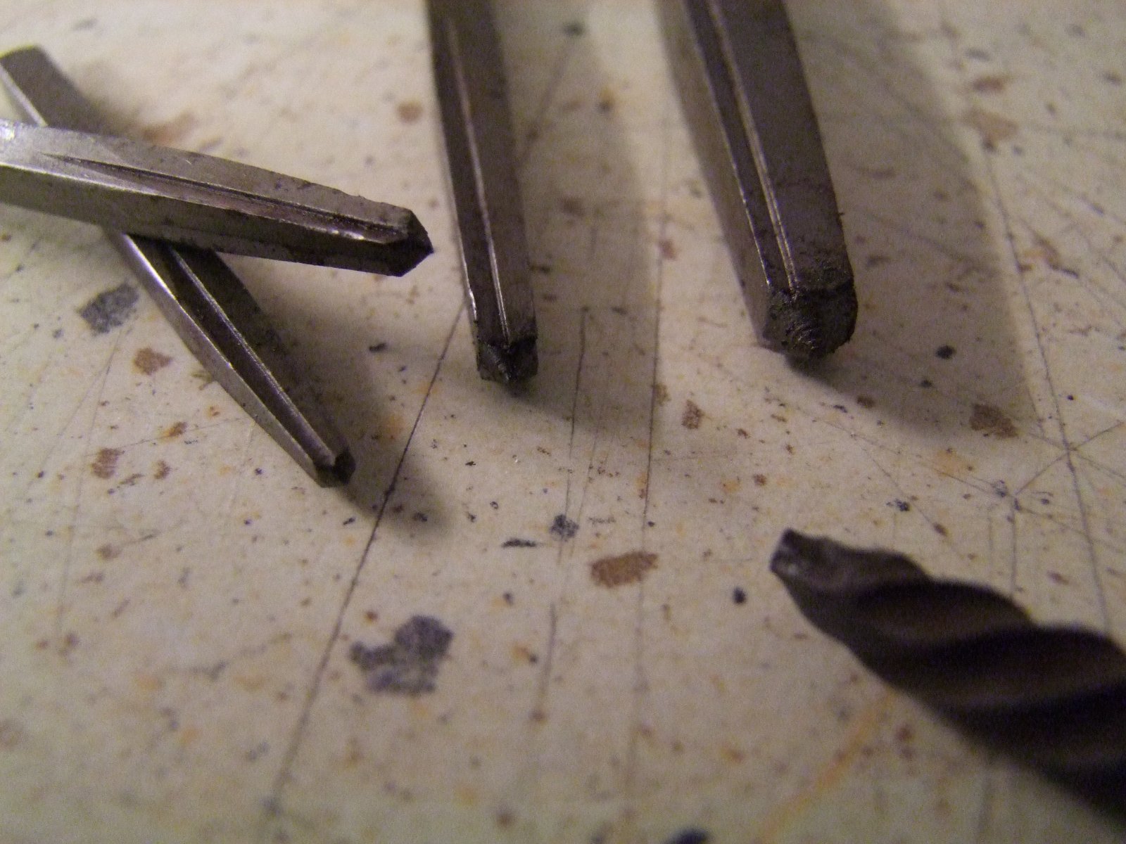

There are stud extractors...
Spiral type (usually LH threaded, to unscrew) is very old. The square-shank ones much newer, and are very good.
Drill the old stud with a drill half or two-thirds the diameter of the bolt remains.
Drilling usually disturbs and weakens the stud thread grip, which helps.
Tap in the extractor without huge force, so it grips in the hole.
Unscrew with a spanner/grips.
Use as much WD/+Gas as you like.
The square ones are on Amazon.uk.

If you can get heat on to the remains plus copious amounts of diesel or plus gas you may get a grip with vise grip and wind an odd one out. Worth giving them some lube from other side, a bit at a time over the next few days. Mapp gas torch.

It depends on how much of the thread is protruding. I have found that, with care, a Dremel can cut a decent enough slot for a blade screwdriver to get purchase, but you would also want to use a freeing spray for a few days to improve your chances.

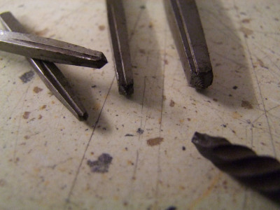

Well that's the broken bolt/screw kit I linked to earlier arrived already, so I'll have a go with it tomorrow as I'll be at home and see if I can remove a couple of the bolts. Looks like it will work (especially considering all the bolts were turning before the head snapped off) so fingers crossed.
Didn't come with any instructions at all which is a bit odd! I wonder how many people don't realise they're supposed to use the drill bit in reverse as well. (Since it's deliberately a left hand drill bit to drill the hole)

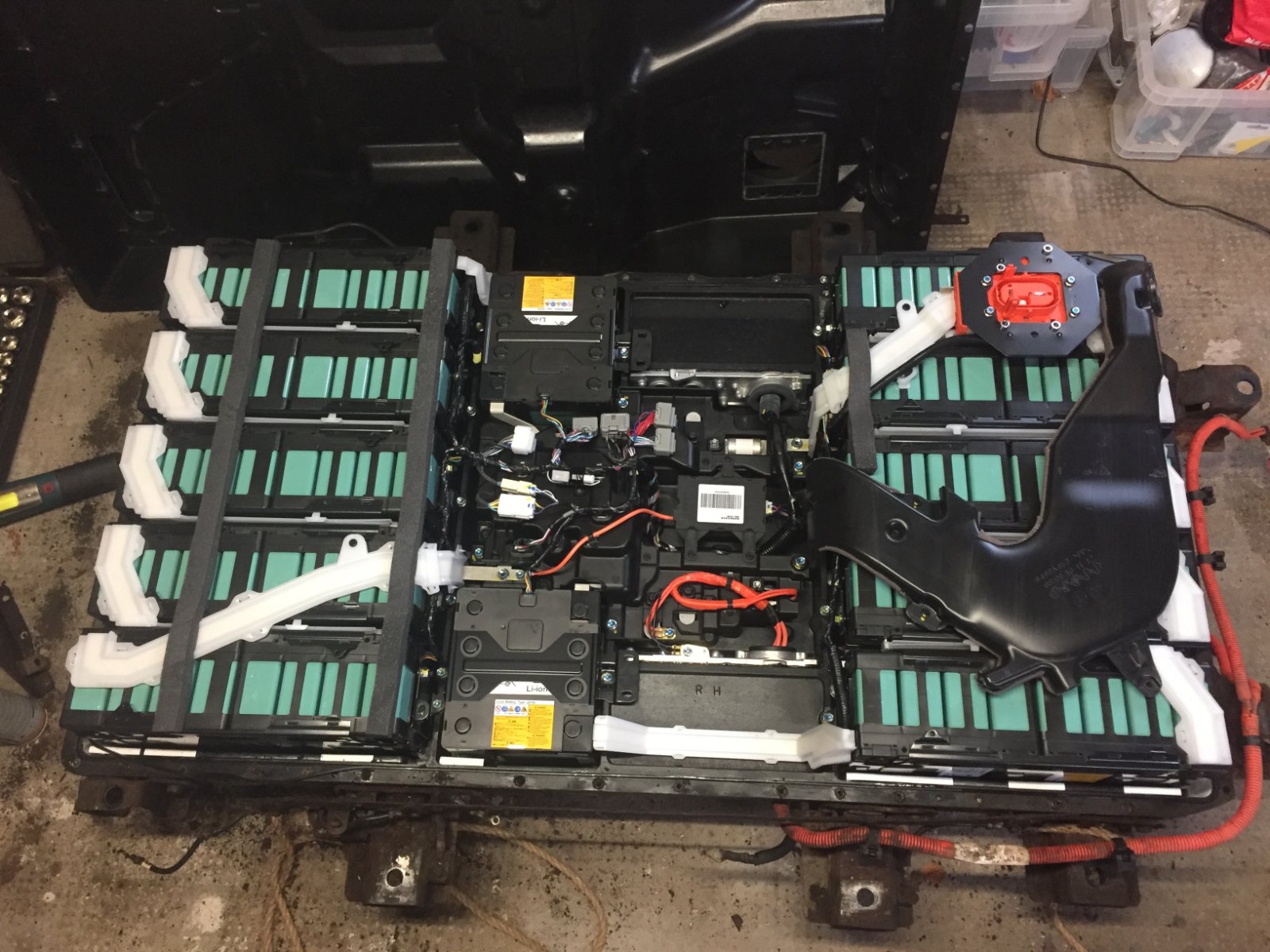

At home most of today so I did some more on the battery pack disassembly.
Most of the M6 bolts around the top cover (over 40 of them!) came out however a couple snapped off, naturally, and one was rounded off. I thought I'd try the new bolt removal kit on the rounded off bolt. First I tried the drill bit they supply to drill the initial hole - complete waste of time. Regardless of whether I tried forwards or backwards it could hardly make an impression in the bolt head...
So I tried the new 4.2mm drill bit I'd previously bought and it drilled into it like butter. So a complete fail on the drill bit half of the kit. I then tried using the reverse spiral bit in the hole I'd drilled and it gripped tight enough however.......it then snapped off and left the broken bit embedded in the bolt head...
So basically that kit is worthless. It might work for rounded off screw heads but for siezed bolts, forget it! I ended up just drilling the bolt out with a regular drill bit. Oh well.

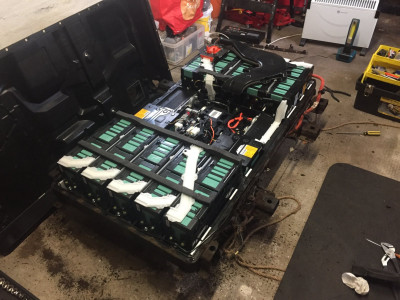

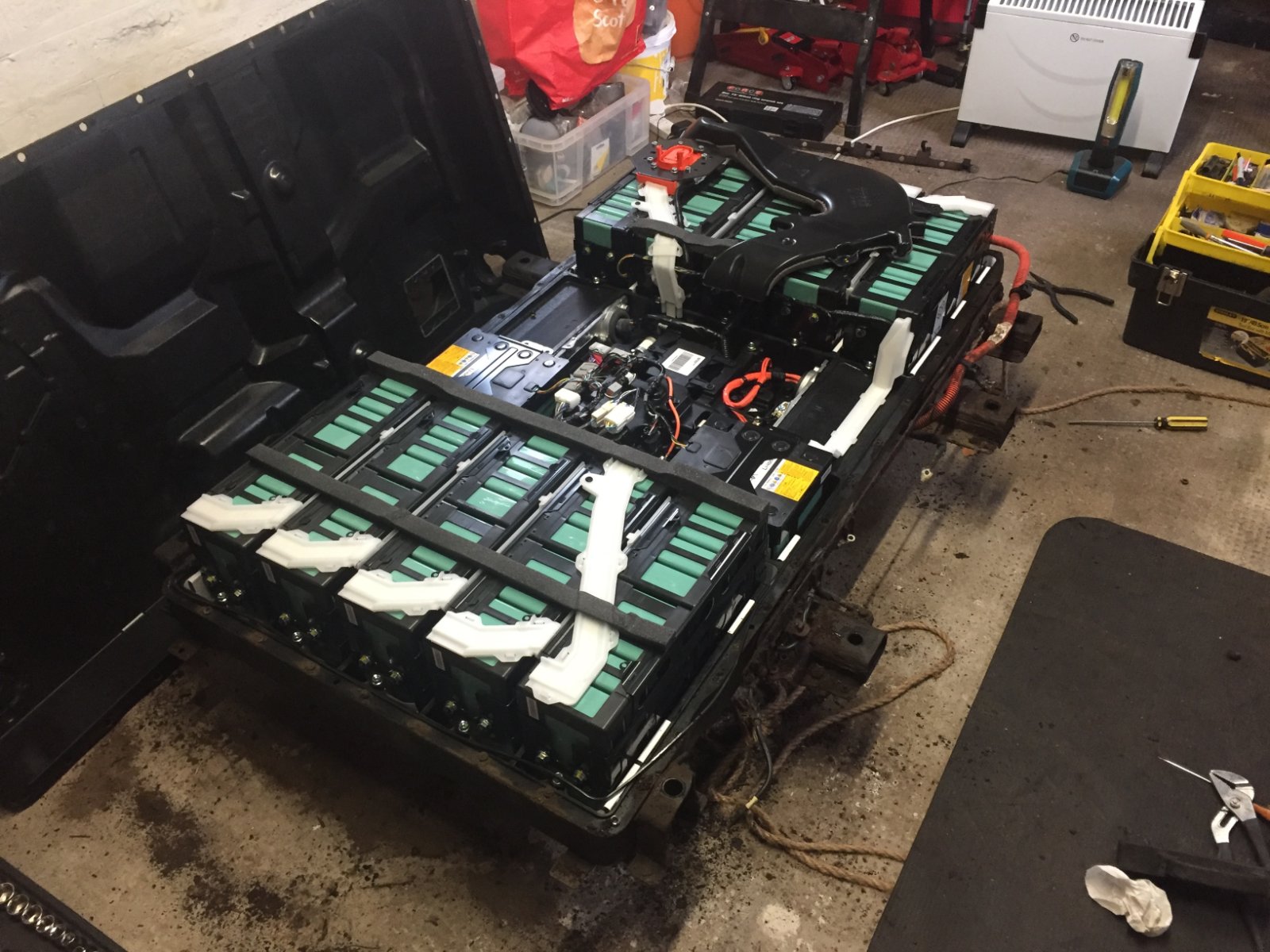

The bolts have a spacer like a ferrule and screw into a threaded insert which screws into the plastic of the case. So of course some of the bolts were seized which resulted in the threaded ferrule unscrewing from the plastic instead... As the bolts are very rusty and there's a chance I might need to do this job again one day I've bought a bag of M6 bolts to replace all 40 something bolts..!
After getting the cover off I was greeted with the insides, all in clean, dry immaculate condition, thanks to an o-ring seal around the lid and the whole enclosure except for the air vents being sealed:

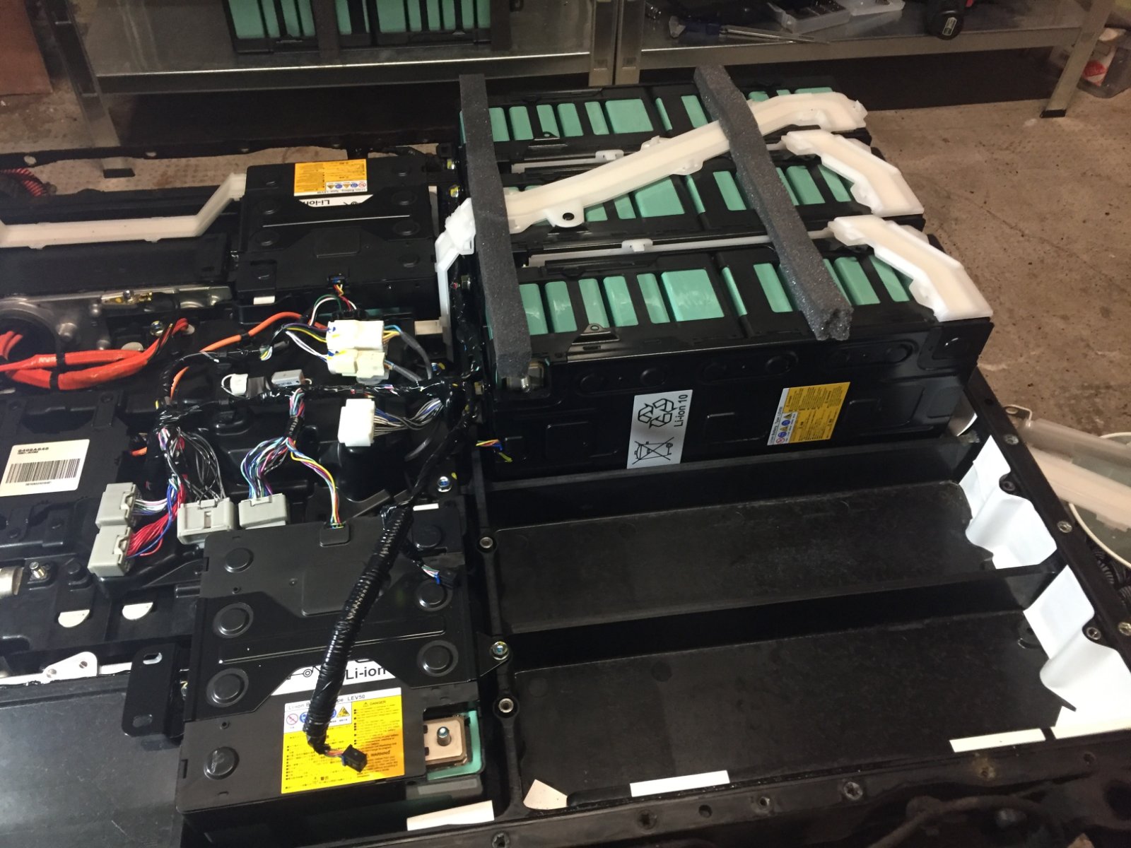

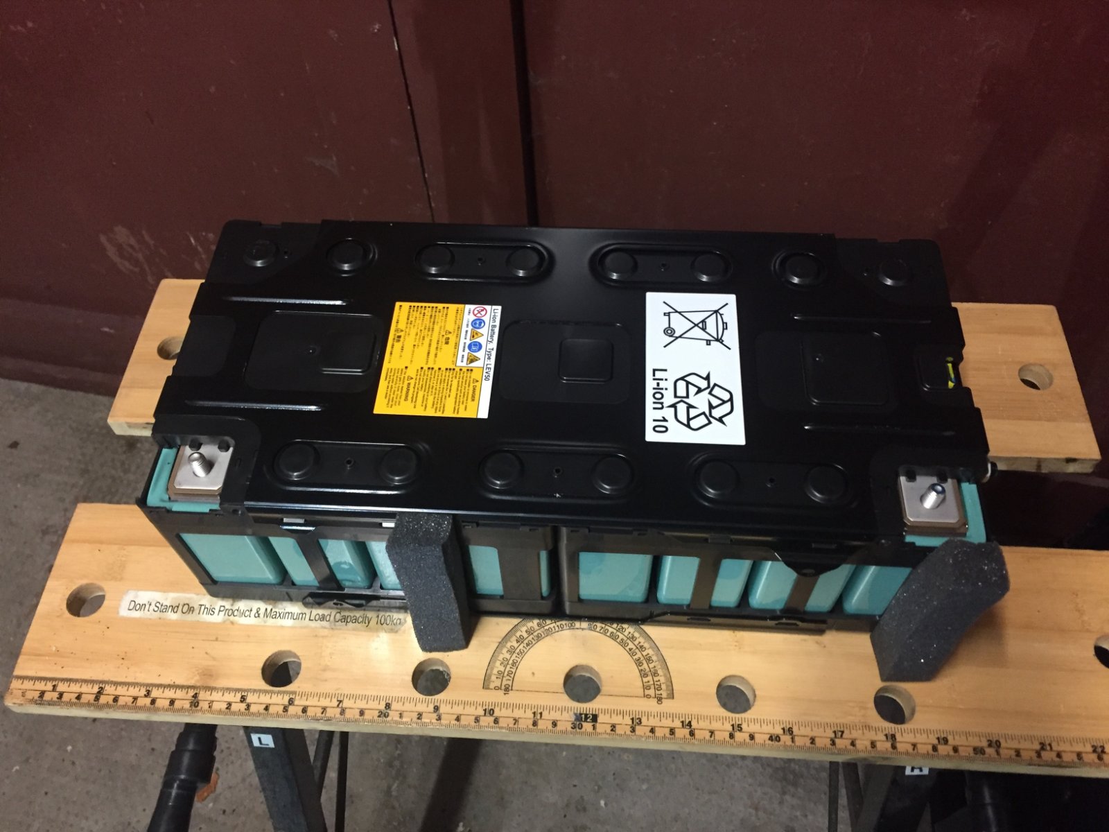

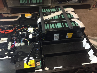

After identifying which three modules I needed to remove I removed the first two that were beside each other:

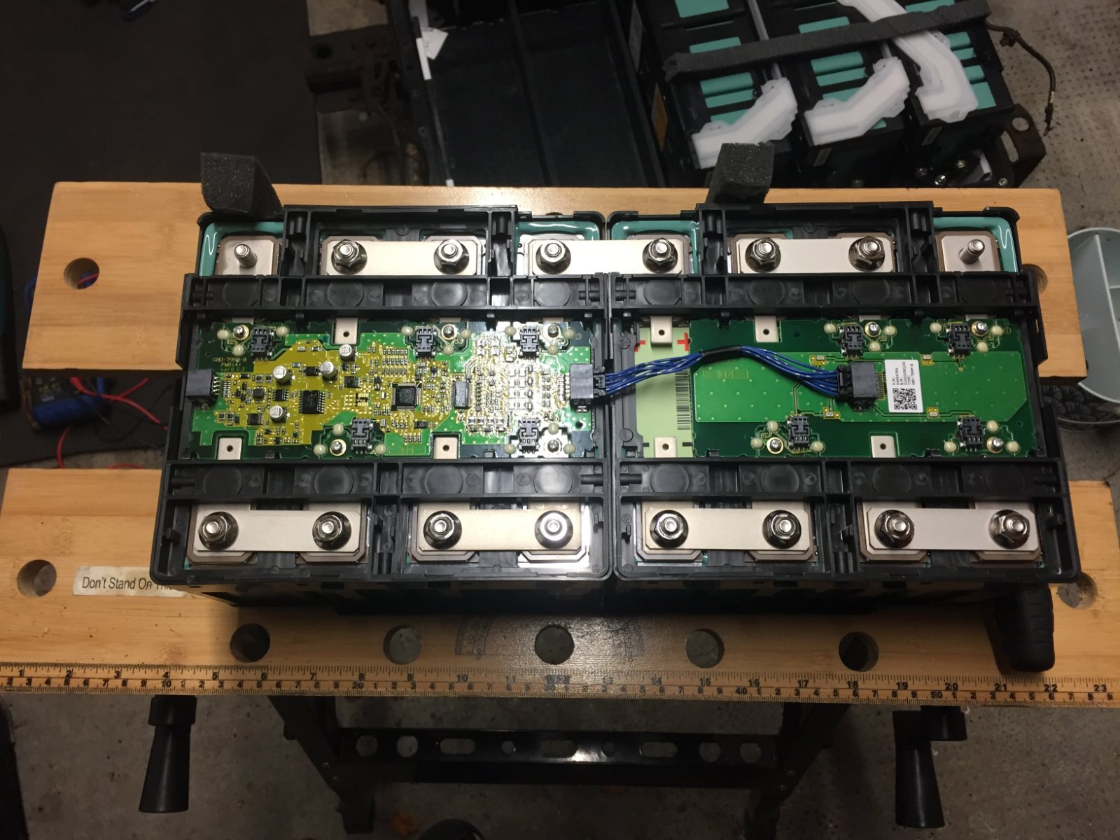

Each module has one small data connector and insulated bus bars to the adjacent modules in the string, after removing those theres two bolts and the entire module lifts out:

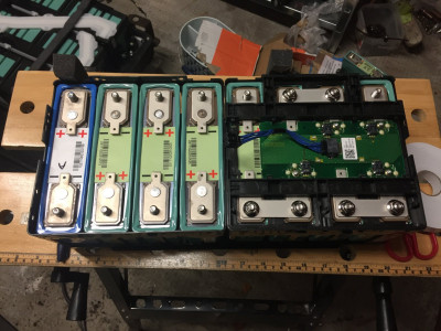

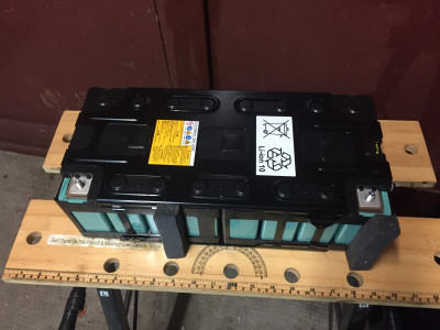

A couple of bolts and brackets come off the side then the metal plate comes off the top. Under the metal plate is a plastic cover that comes off revealing the CMU or cell management unit mounted on top of the cells:

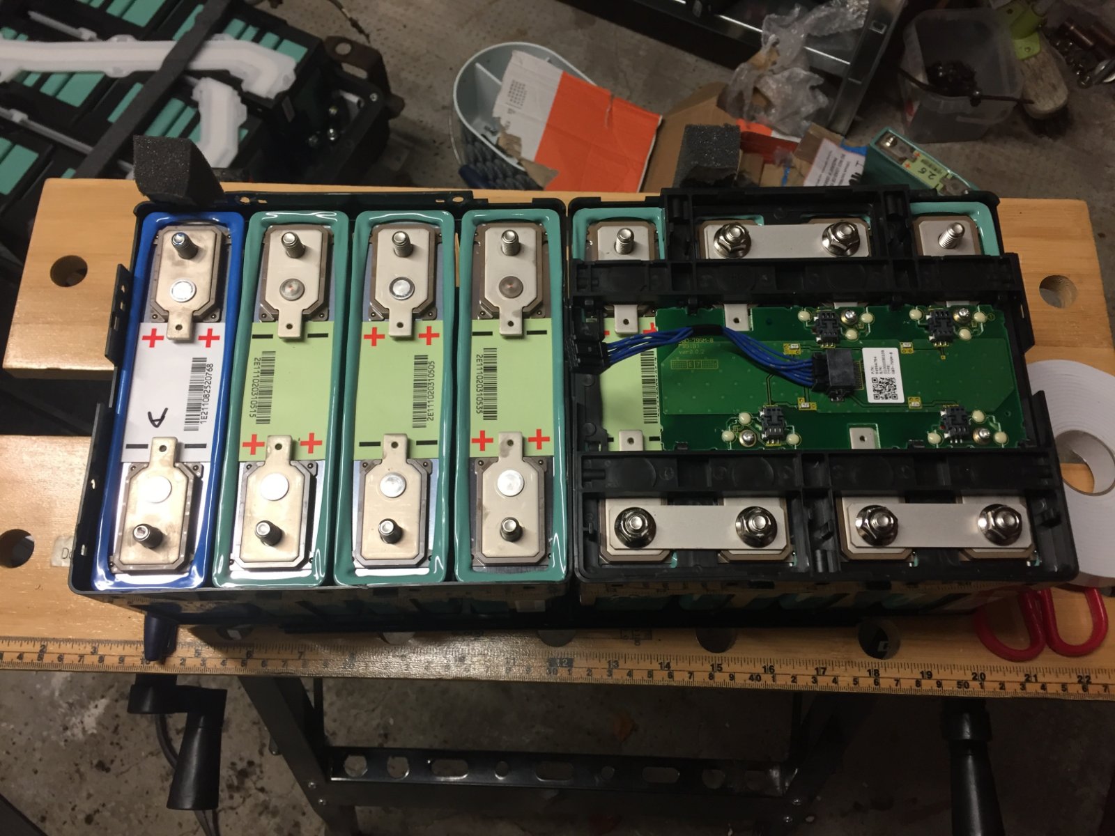

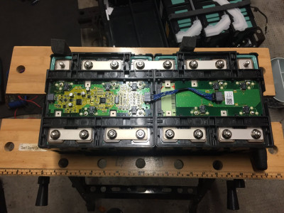

The CMU has small screws into the battery termainals that are removed, a connector to the daughter board on the right and then it unclips. Once out the bus bars between cells can also be removed. Before the cells can come out some plastic rivets have to be cut to allow the plastic grid to be removed and finally a cell can be removed:
The replacement cell is blue in the picture above - I have no idea what significance the original cells being green and the replacement being blue has! I've seen them in pictures online in green, blue, yellow and purple, with blue seeming to be the most common...

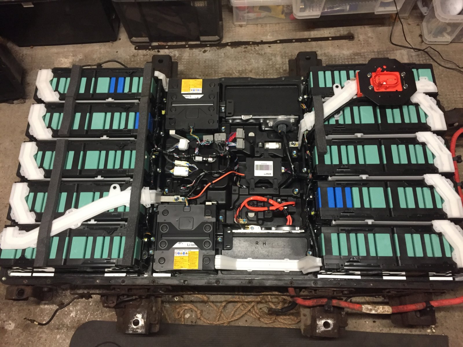

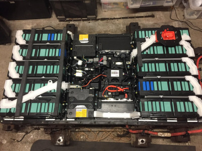

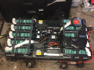

After replacing four cells (conspicuous in blue) in three modules and refitting the modules, with just the air vent to go back in yet:
So that's the cell swap basically completed. I just need to refit the air vent and then sort out the cover bolts so I can put the cover back on - I have 2 or three snapped bolts that need drilling out etc...
Once the cover is on and the brackets bolted down it will be ready to go back in the car.
