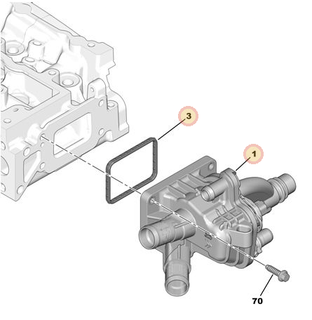

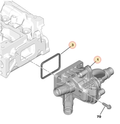

Same vin as above , needed part number for the thermostate i understand the part comes with housing and sensor ? Part numner from euro car parts ive been handed is 209540059 ?
Husky.
Huskyxantia
- Posts: 3923
- Joined: 30 Jul 2018, 22:11
- x 921
Thanks for your help marc
Husky.
- x 6946
Thats' not an official part number - but ECP's own internal number.Huskyxantia wrote: 08 Apr 2024, 14:55 Same vin as above , needed part number for the thermostate i understand the part comes with housing and sensor ? Part numner from euro car parts ive been handed is 209540059 ?
(1) Engine Water Outlet, part: 1336AX, £191.84
(3) Square Seal, part: 1623125880, £6.78
Try Here:
https://www.autodoc.co.uk/car-parts/oem/1336ax

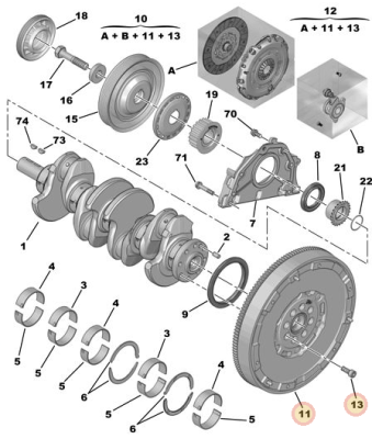

Hi There, I've just made my donation hope I can go straight to a parts request please (plus this forum is so helpful anyway)!

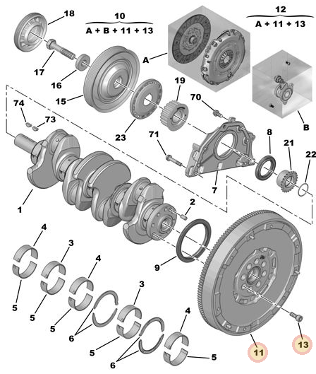

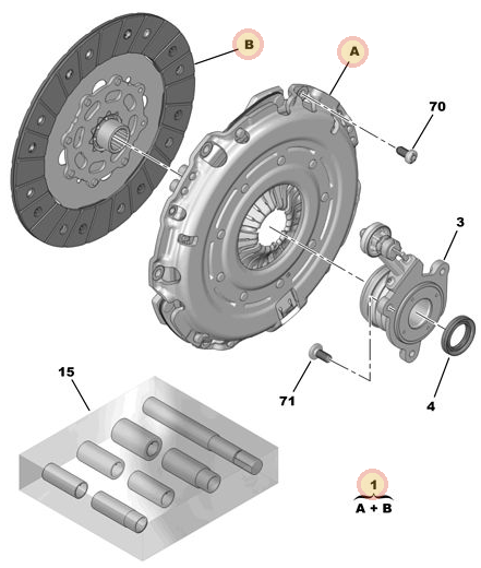

Need my DMF replacing on my Citroen Dispatch VIN VF7**************[VIN obfuscated, can be read by forum staff] and I understand it's better to do the Clutch at the same time if it's not been replaced (I'm on 138k miles on original parts). I'm looking at Autodocs for Valeo parts but there are two Clutch Kits which appear to be suitable for the van https://www.euspares.co.uk/parts/valeo/13776826 and https://www.euspares.co.uk/parts/valeo/13776821 but unsure what the difference is and if one kit would replace exactly what I have already so looking for the OEM I think to compare.
I'll be getting someone else to fit in case I sound clueless (I am!).
Thank you, Bryony
Thank you, Bryony
- x 6946
@Bryonyolney: Sure no problem, details below:
DMF
(11)
OEM Original Dual Mass Flywheel, part: 9841562380, £1202.50
Cheaper Standard Exchange DMF, part: 1649616080, £536.80
(13) DMF Bolts x 8 (must always be replaced with new ones), part: 1682800980, £1.57 each.
Clutch Kit
(1):
2 Component Citroen Original Clutch Kit, part: 1616517180, £617.82
Standard Exchange Clutch Kit, part: 1616517380, £317.63
DMF
(11)
Clutch Kit
(1):

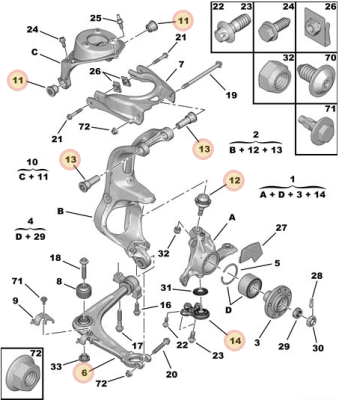

Hello,

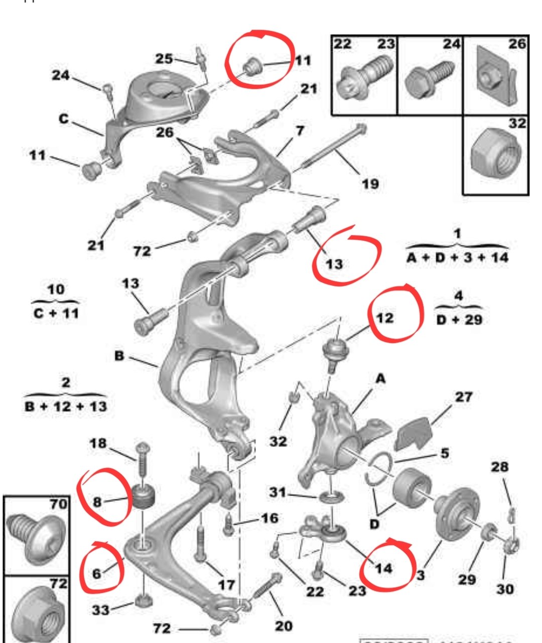

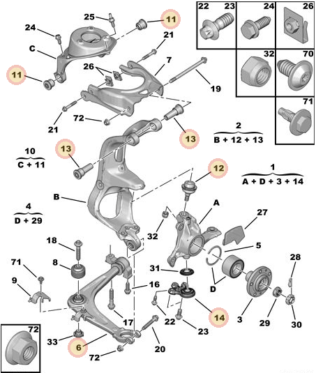

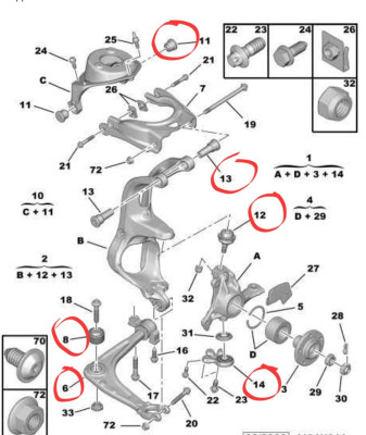

I need following part numbers (picture attached) for my C5.
Also is it actually worth changing bushes number 13 and 11? Do they have an impact on ride quality?
Thanks!
Thanks!
- x 6946
(6) Wishbones:
OEM Left, part: 9666244080, £476.41
Cheaper Alternative Left, part: 1682731680, £212.92
OEM Right, part: 9666243980, £484.04
Cheaper Alternative Right, part: 1682731380, £157.31
(11) Wishbone Arm Mounting, part: 3523CA, £18.78
(12) Suspension Ball Joint
OEM, part: 364074, £125.98
Cheaper Alternative, part: 1635771880, £46.50
(13) Front Wishbone Mounting, part: 3523AZ, £18.78
(14) Suspension Ball Join
OEM part: 364069, £196.03
Cheaper Alternative, part: 1682730080, £105.43
The one that went with me is where the lower part of the front hub carrier (B), shown to the left of (32) goes into the Wishbone (6). That's the one bush they don't supply, but they can be bought cheaply enough in after-market and they also do a reinforced one for longer life. Mine went resulting in a knock on braking and acceleration. Not able to replicate by hand - needed putting on a lift and some major effort to slide it back and forward to get the knock.

nomad123
- Posts: 64
- Joined: 24 Aug 2019, 19:00
- x 7
Thanks Marc!

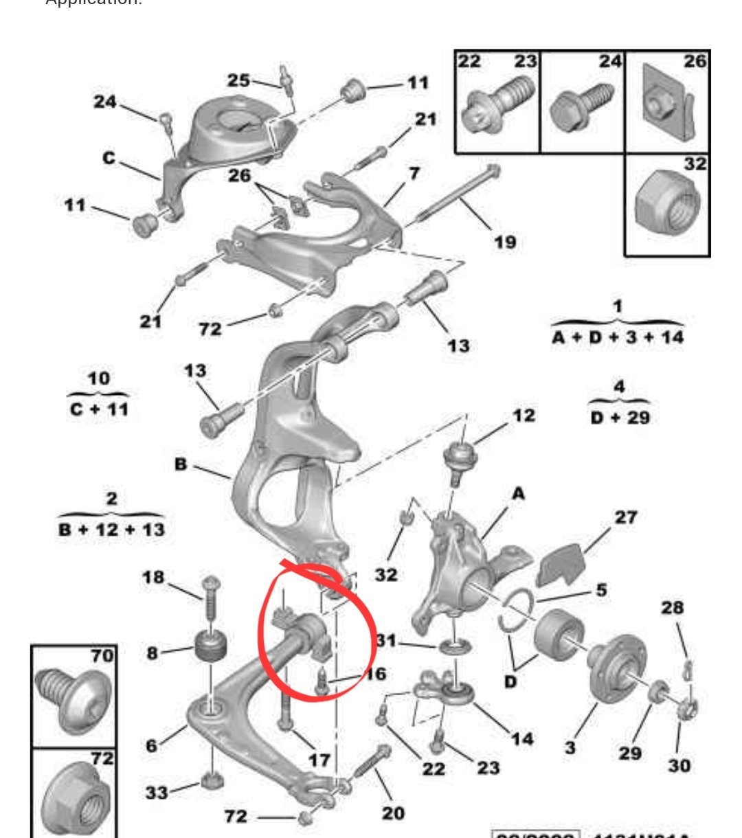

I have also changed that part a week ago. Mine was making noise on small bumps in the road.

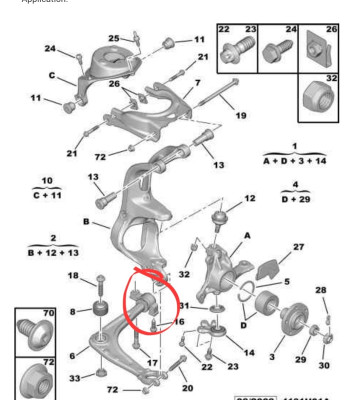

Can you tell what type of rear bush is on my C5?
Aluminum or steal?
Is there aftermarket part number for this part?
Aluminum or steal?
- x 6946
Part 6 is sold officially by Citroen as a complete unit with bush. However if you google the wishbone part number provided, you may find suppliers like Autodoc that sell the bush separately.
As for Steel / Aluminium, I'm assuming you're referring to the Subframe. In this case you could have either type as the part number is the same, but either material could of been fitted.

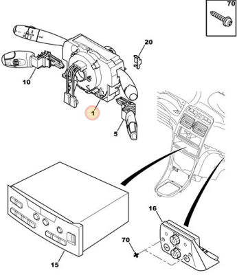

Marc, could you give me the part number for the Comm2000 please for this car VF3**************[VIN obfuscated, can be read by forum staff] . Thanks very much. Had a quick look on Autodoc and there seems many, some including more stalks than others. Also have you got a current price. I realise that it will a UK price so maybe not relevant here.
Cheers
Cheers
Pete
- x 6946
Here you go Pete, no longer available, but you can get them from here (remember to retain your cruise control and audio stalks (items 5 & 10) as they are not included):
https://peugeotpartsforsale.com/product ... no-6242h6/
(1) Multi-function control unit, part: 6242H6, (NFP).
