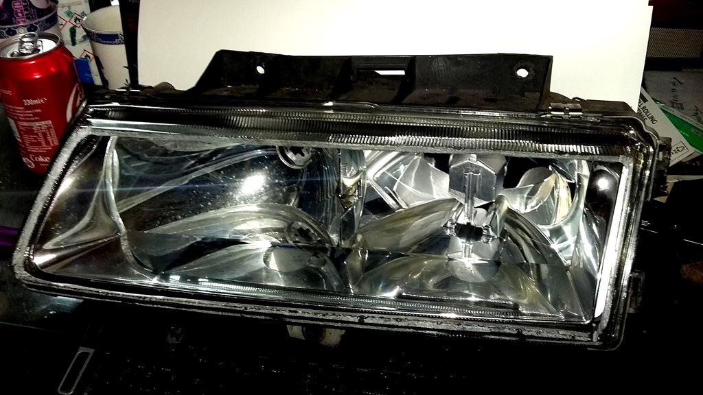

Well with all this rain....7 days now !.....I needed a project so I decided to continue with the headlamp modifications. (well experimenting)
I decided to sacrifice a LHD headlamp glass and attempt to cut out the lens section, so with a borrowed tile cutter I have managed this. The out rim is very strong (thick glass) so I think it may just be OK long term.
The next step is to take some thick lexian and cut that to fit into the "hole"......lets see how far I get !
(a reminder where I left the project)
