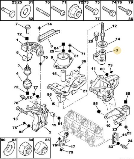

Thanks Marc. I don't suppose the fiche gives any dimensions or mentions cross referencing with 185424 does it as there is the latter on Ebay for sale. No point in buying if not compatible.
x 6945
Re: Citroen and Peugeot Parts Requests
No, 185414 is the right Anti Torque Link, no dimensions and the part you mention (185424) is not listed anywhere for any model. It may of been an older correspondence part, but is no longer coming up as valid anywhere.
x 6945
Actually - I've just checked against Peugeot and the only vehicle that had that reference 185424 was an old Peugeot Partner van with the DW10TD engine. Here, item (1) - but of course no longer available. But normally if the part number is different then there is likely to be a difference somewhere - otherwise they use the same internal parts reference.

Thanks for clarification. I have asked seller for measurement between hole centrelines and distance between the bush retaining arms of engine block mount.
x 6945
Well hopefully there will be a marginal difference and as it's just a mount some flexibility one would hope!

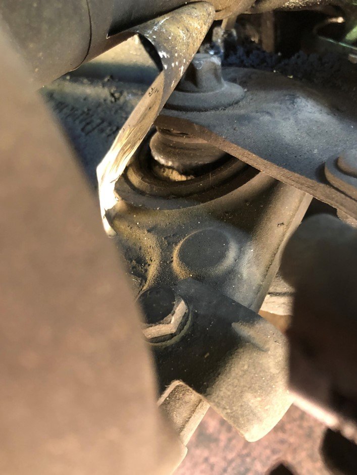

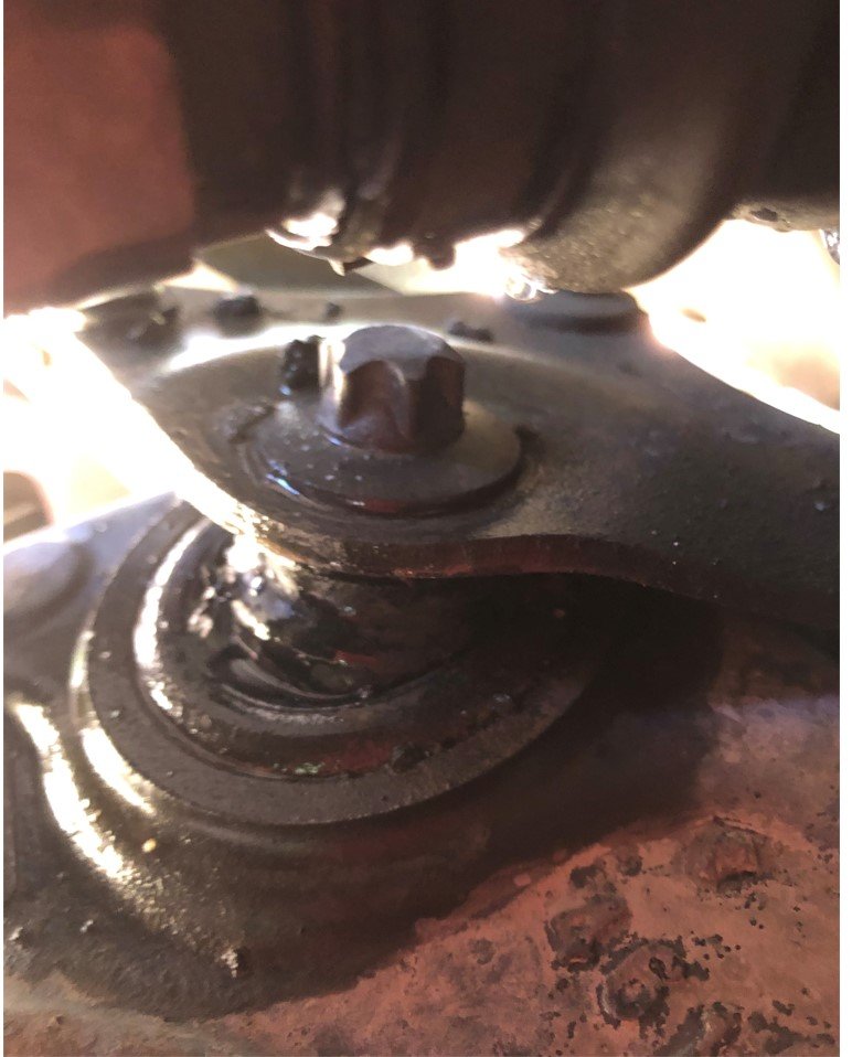

Hi Marc
On the petrol 3.0 407 VF3**************[VIN obfuscated, can be read by forum staff] I suspect the ball joint in the passenger side wishbone is knackered - just looks bad but unable to induce any movement under load
When I stop I can get it to judder a few centimeters as if something is loose.
All the other bushes / joints look okay, as do the brakes
what the part number of the wishbone (both side) and is the joint available seperetely to press in ?
regards
driver side wishbone joint
passenger side wishbone  joint

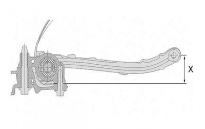

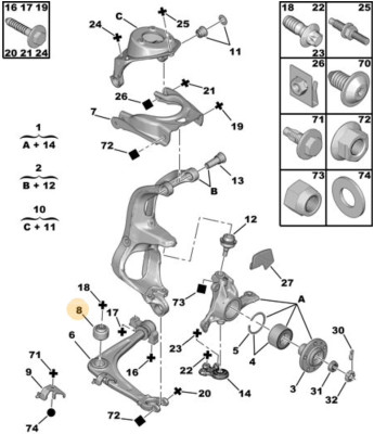

407,
You can get the individual rubber bushes for the wishbone but your one will require a press or something similar to remove and replace.
The rear bush can be done without a press but must be pushed on at the right position to give the correct height between the arm and the center of the lower susp'n arm bush.
The details are in resources.
X = 58 +/- 5mm
Kenny

Part 3523AQ price £23.30 same for both sides.
