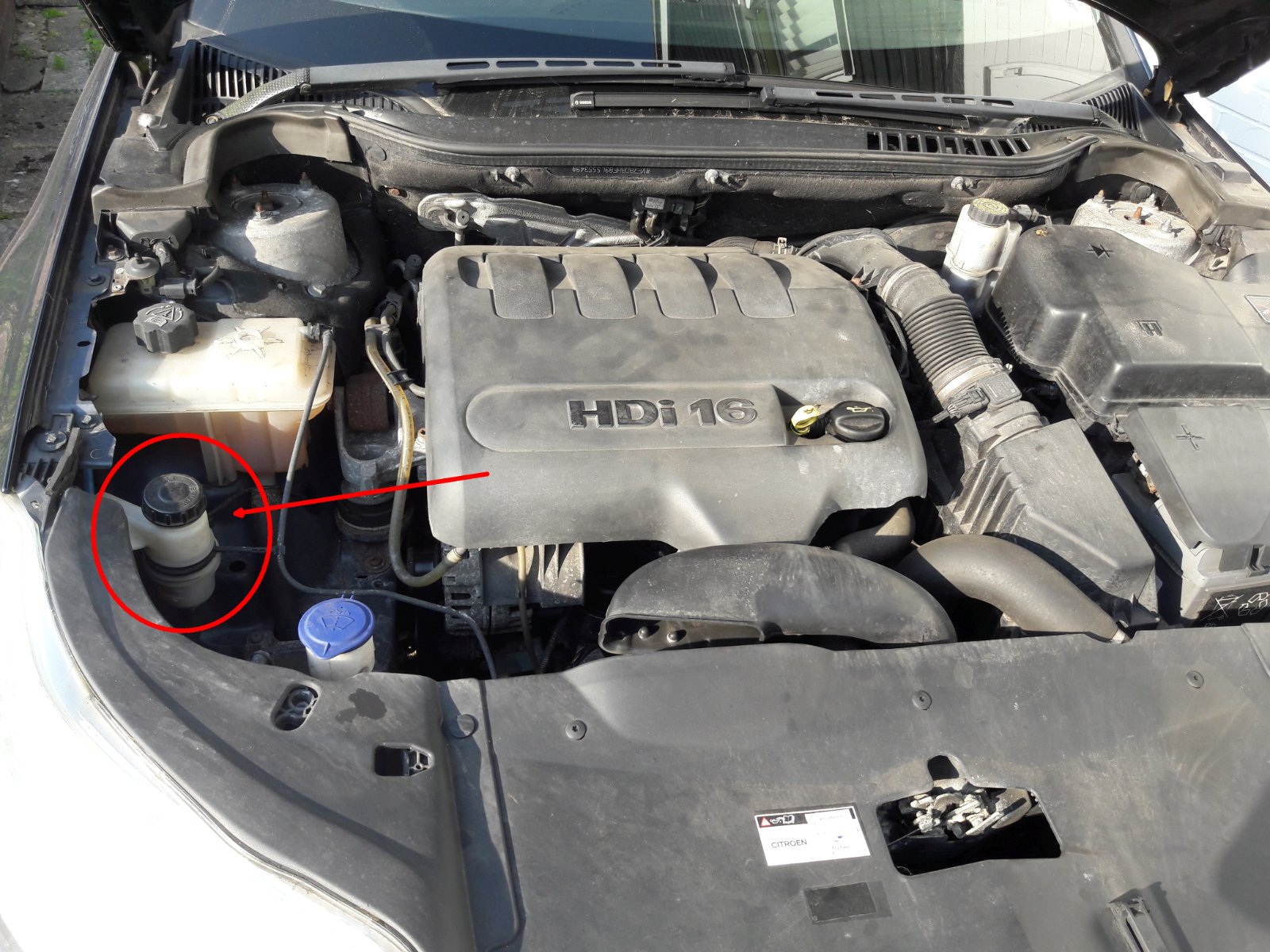

Looks like I have my first problem. :shock: Changed the engine oil today and noticed that there is oil around the steering rack, not a tremendous amount but it does look as though its coming from the rack. There doesn't appear to be a reservoir for the fluid, or at least I can't find it. Help. :?

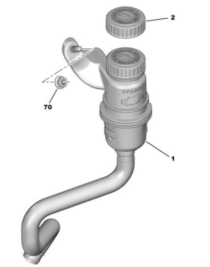

C5 Power Steering Reservoir - own work
If the rack has been replaced within the last year then it could just be the pipe seals that have gone.

I hate to be the one to tell you - but it looks like yours has succumbed to the dreaded legendary steering rack failure Peter. :cry:
The fluid has a small bottle on the left of the engine bay

That is it then, I thought that was something to do with the water, it has a pipe going to the header tank. What fluid does it use?

LDS Fluid - the same as if you had a hydraulically suspended C5

It'll also take Fluide DA - in fact it's supposed to take Fluide DA, but as they're the same - either will do :-D
