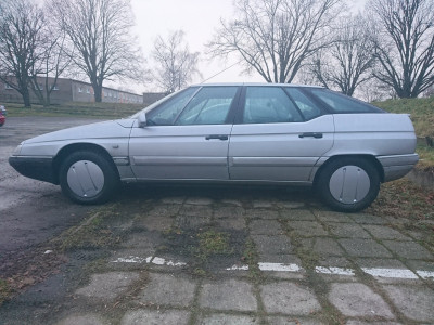

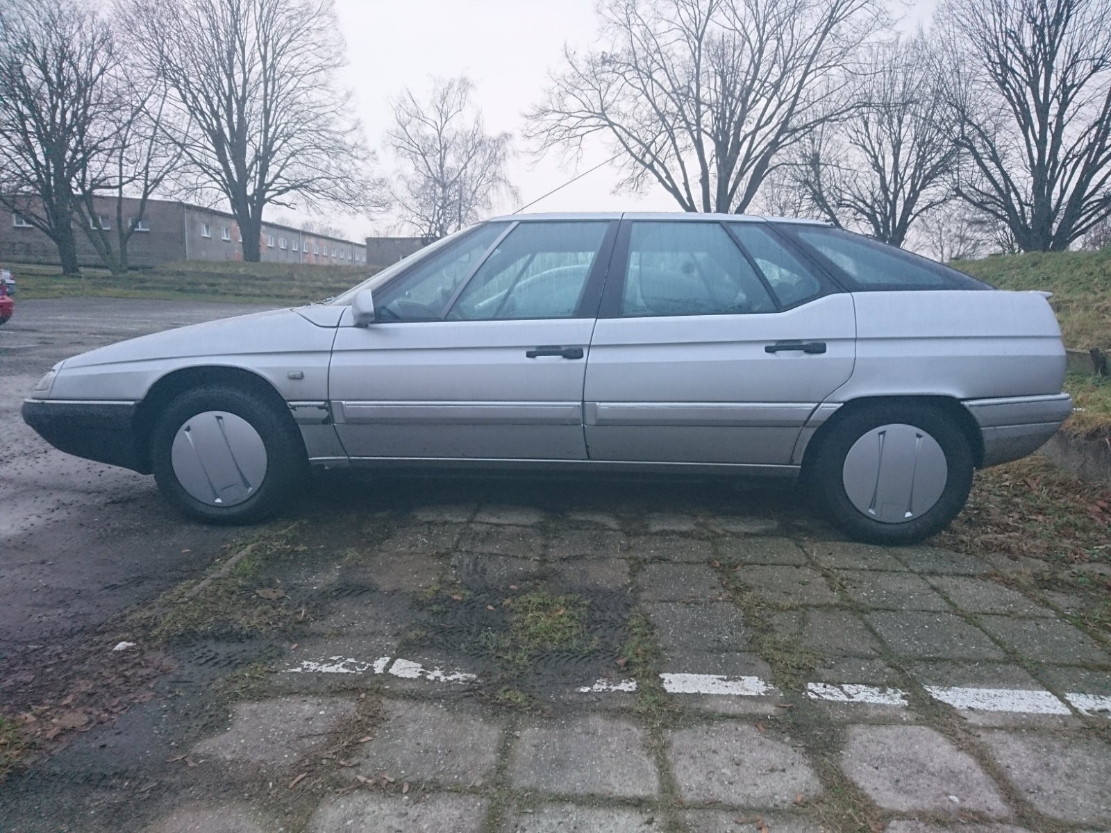

In the video, the car was standing on an inclined road and maybe that's why it seems so. I set the front at about 155mm. The lower suspension selects unevenness well, but it can bounce off the stops. I set the rear at about 450mm for the same reason.
What can I do with this excessive suspension movement if the corner spheres are with the correct bore and pressure? The HA block also has the original dampers inserted. The spheres at 500cc HA blocks currently make the rocking thing worse, but not as much compared to the 450cc I had before.
Photo after firing and leveling the suspension.

Not sure what size tyres you have on the car, but the Citroen manual states running heights (in Normal position) as follows: (all figures are +10 -7 mm)
Front
195/70 144mm
205/60 149mm
Your setting - 155mm
Rear
195/70 431mm
205/60 436mm
Your setting - 450mm
Do you have workshop manual pages starting 430-00/1, which lists the measurement checks, and how to set them? If not, I can post these as jpg's.
The unwanted softness (car presses down too easily) is either
- sphere capacity too large
- gas pressure too high
- damping insufficient (wrong spheres, or spheres that have been drilled out, or so-called "comfort" spheres)
- centre (HA) dampers (in the regulators) fitted incorrectly, maybe
With correct spheres, dampers and height, the car (at Normal driving height) should under no driving conditions hit the bump stops. Sphere gas pressure and damping will prevent this.
