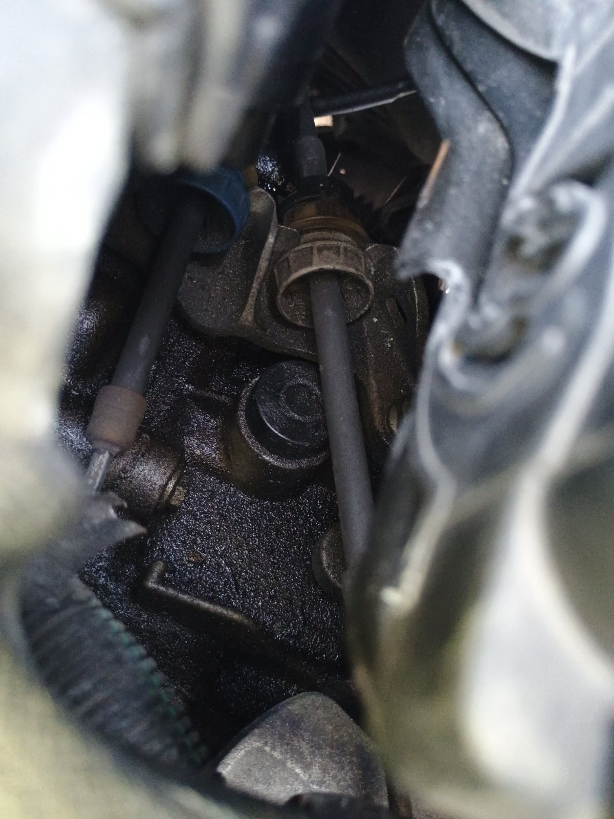

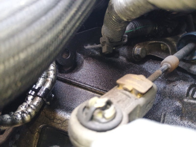

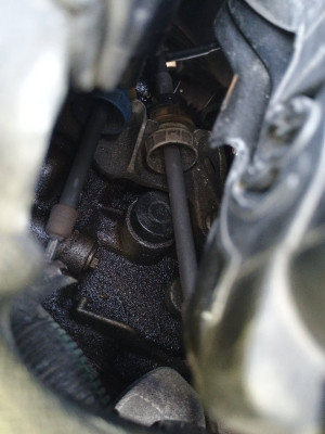

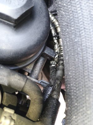

The oil should be obvious if it's engine (black) or gearbox (stinky!). If the oil cooler seal or turbo is leaking it tends to just run down the front of the block. They can leak from the rocker cover, or the cam carrier, or the vac pump, which is above the gearbox and could run down. I would expect the top of the box to be oily in this case.

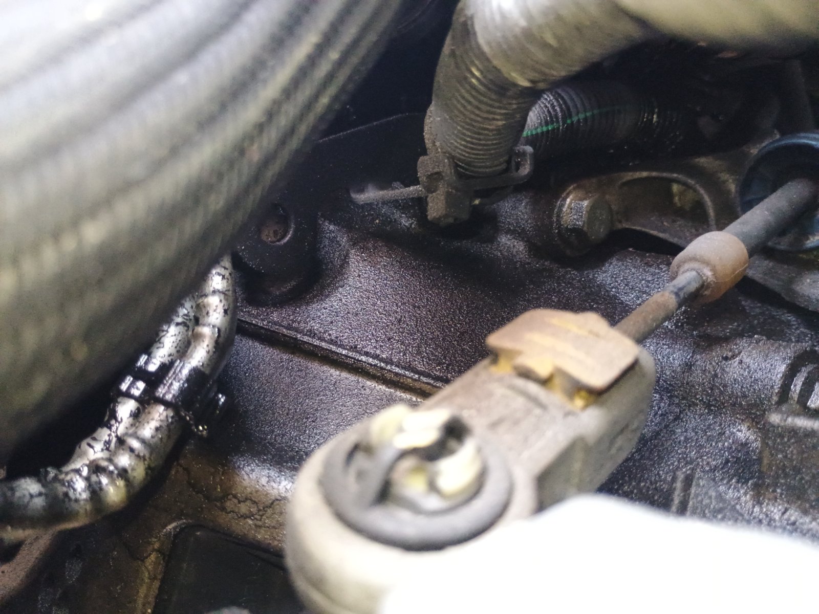

Good info, thanks. Yes seems more black engine oily than smelly gearbox oily I think.
Will have a good look from above tomorrow when digging towards the tip of the box for it's oil refill task. Can't see a load of oil on top from a cursory look. Might get my borescope on the go and see how near oil filter housing I can view.

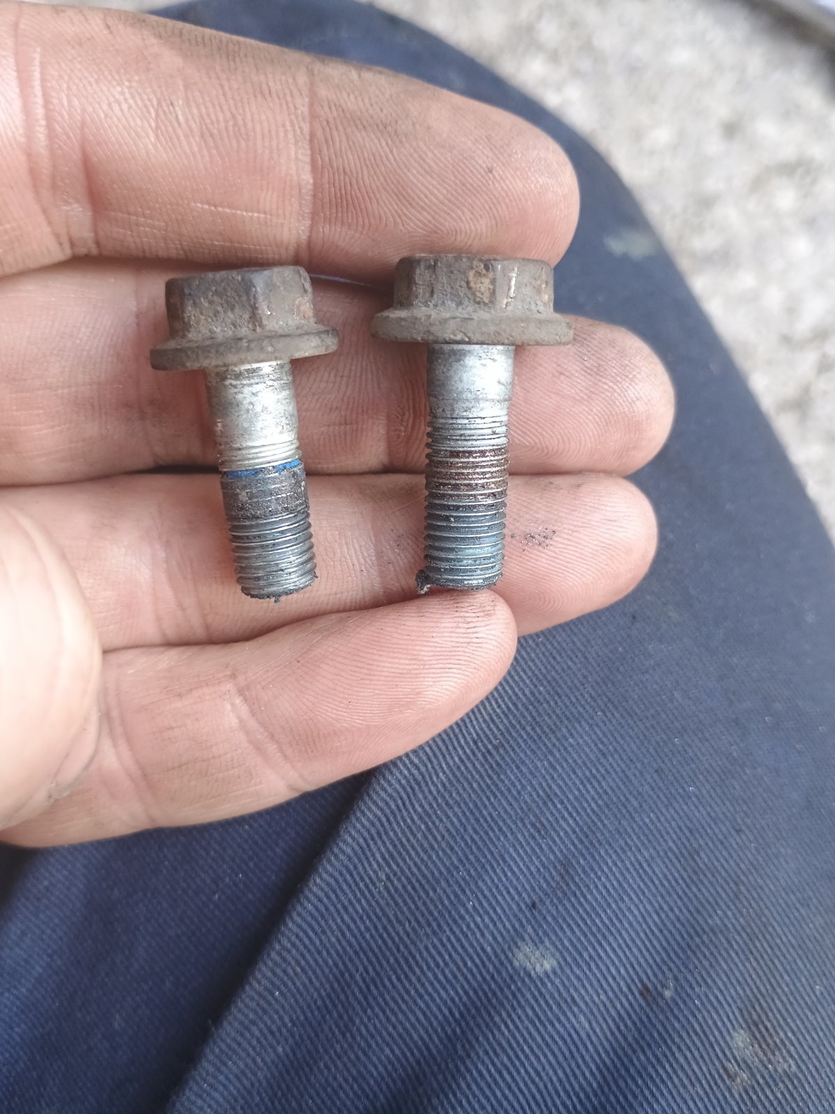

MattBLancs wrote: 08 Mar 2025, 15:14 Image
Brake caliper bolts: top one is 13 mm, bottom one is 12 mm head. Supposed to have loctite but nope it's copper grease instead.
Why does finding out how the car has been worked on in the past generally not fill me with confidence!?

Huskyxantia wrote: 08 Mar 2025, 22:01
I know how that feels,
You can see the remains of the factory "loctite" (the blue band on the top one) as well :)

Stickyfinger wrote: 09 Mar 2025, 07:03 You can see the remains of the factory "loctite" (the blue band on the top one) as well :)
Exactly, it's staring you in the face as what's needed and still got it wrong!
I'd various brake caliper bolts in my "recycling" bucket but they are all standard M8 thread pitch (1.25) these are a much finer thread (1.0 mm pitch I think) I suppose, given the apparent quality of workmanship, it's fortunate that the substitute bolt is at least the correct pitch! That would have been a bigger headache! :)

Not too oily under vac pump

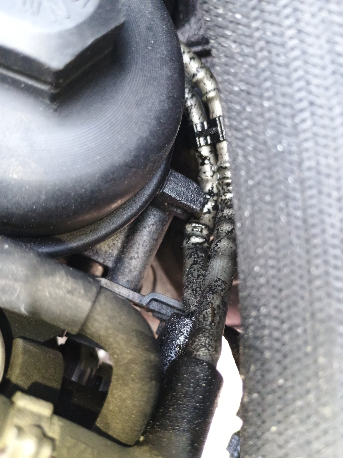

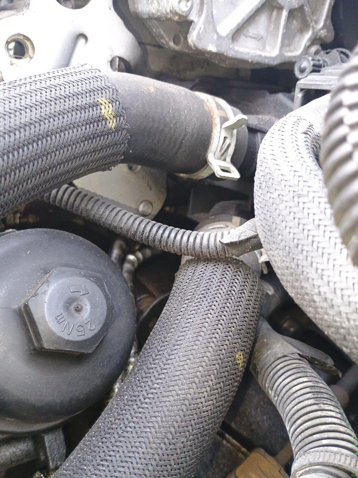

Just trying to see if can spot source of the grey 308 oil leak.
Bit grubby under oil filter cap
Top of gearbox is quite oily

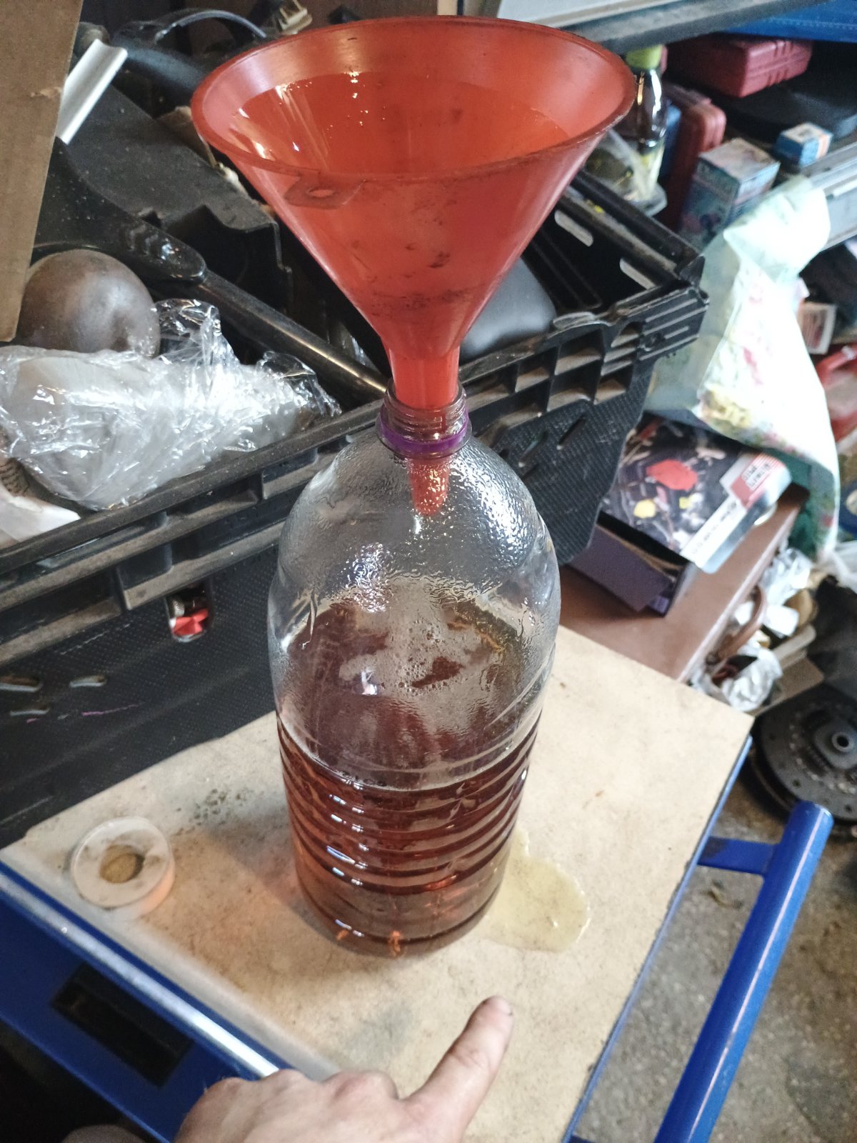

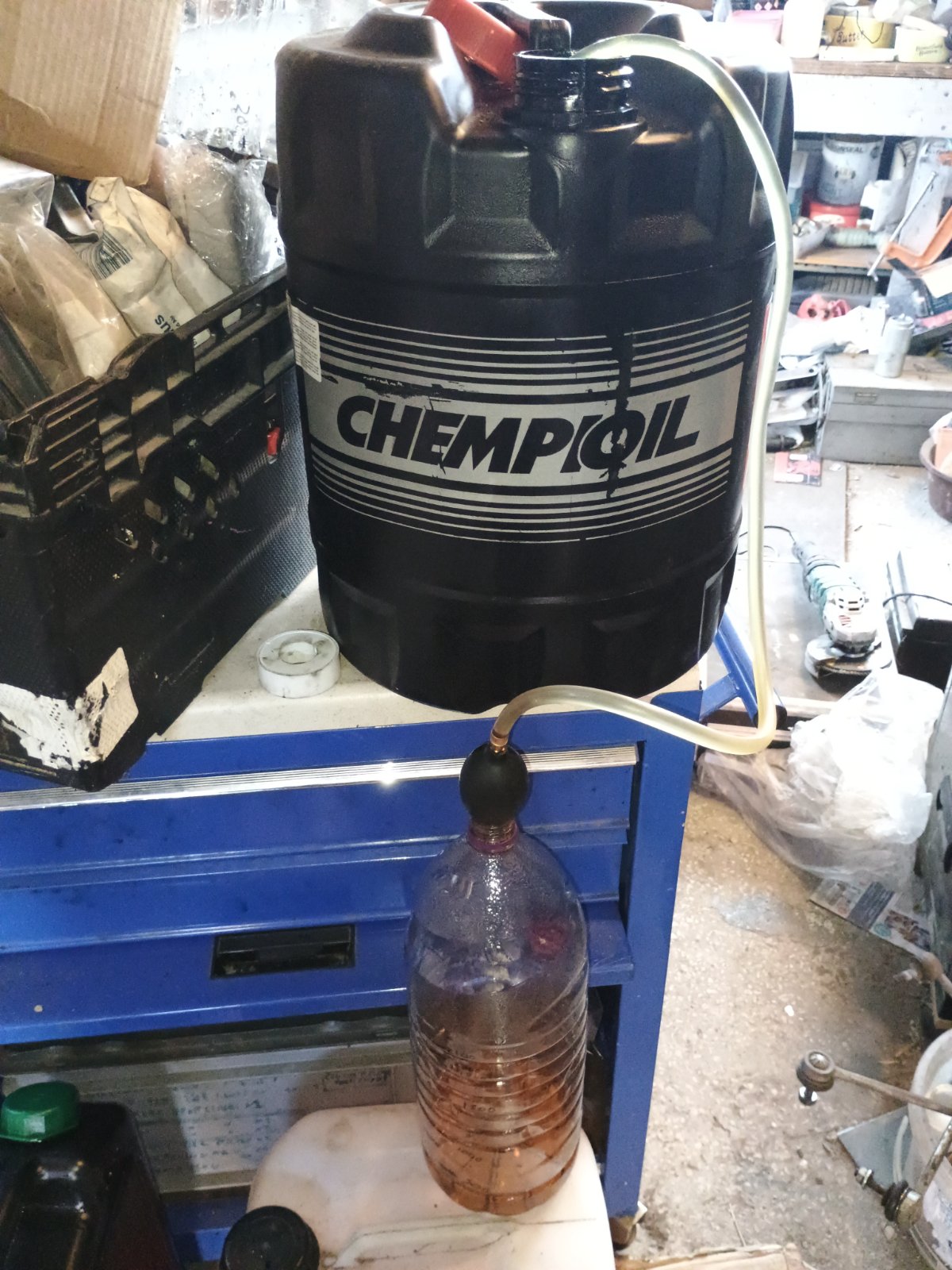

I thought I had a perfect no mess transfer system for gearbox oil from me big unwealdy 20 litre container: a syphon.
From big tub to default Vimto receptacle
Unfortunately I am not sure I'll live long enough for a couple of litres to amble its way out this method!
