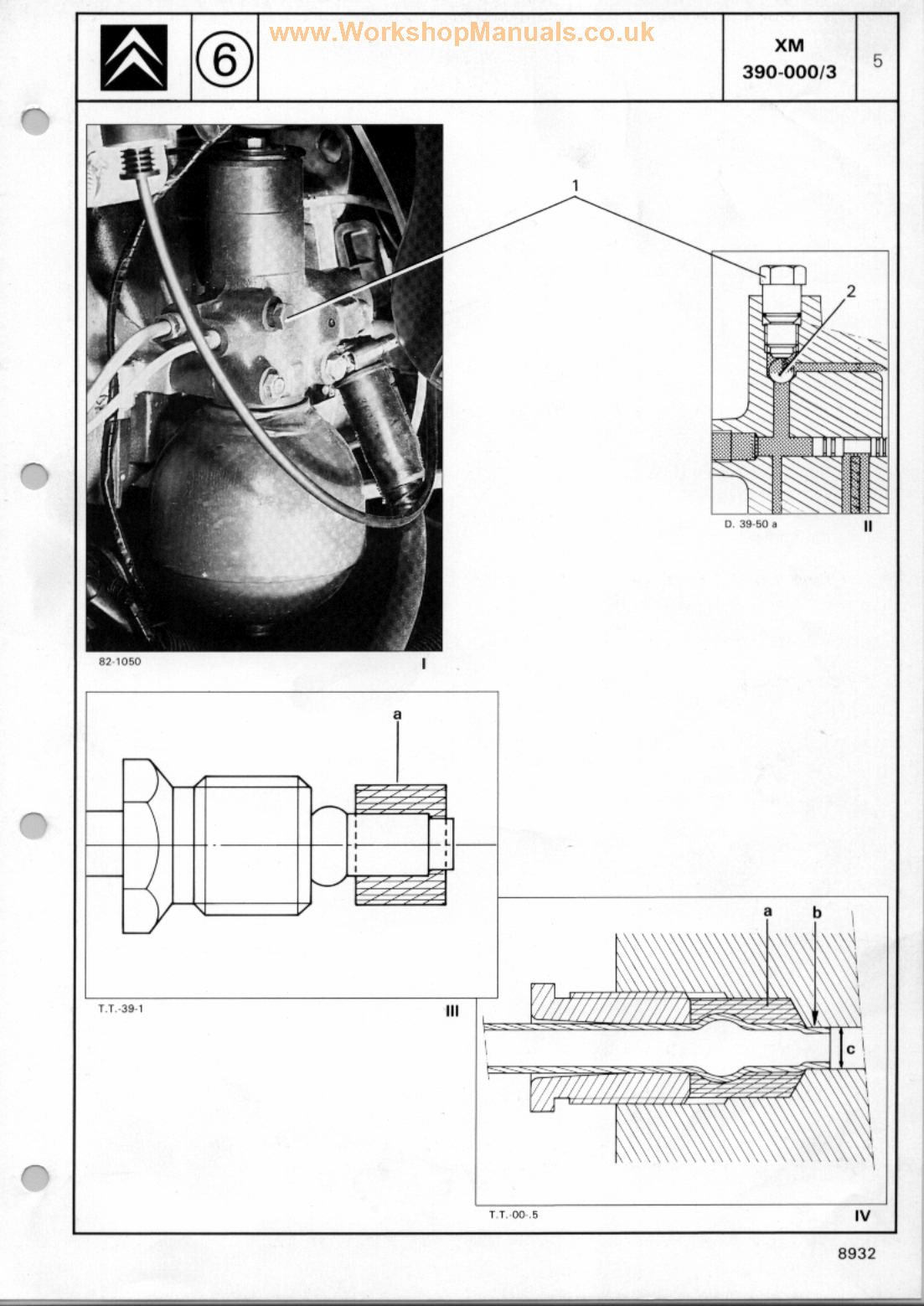

Further to the discussion on the Citroen hydraulic pipe union, these are the pages I have, and was quoting from:
Have just checked again this morning, and yes, capitals needed for the ID.
Got a captcha check yesterday (for the first time on the site), but not today.
