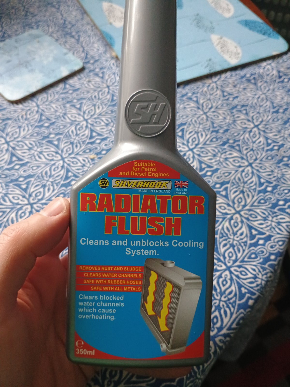

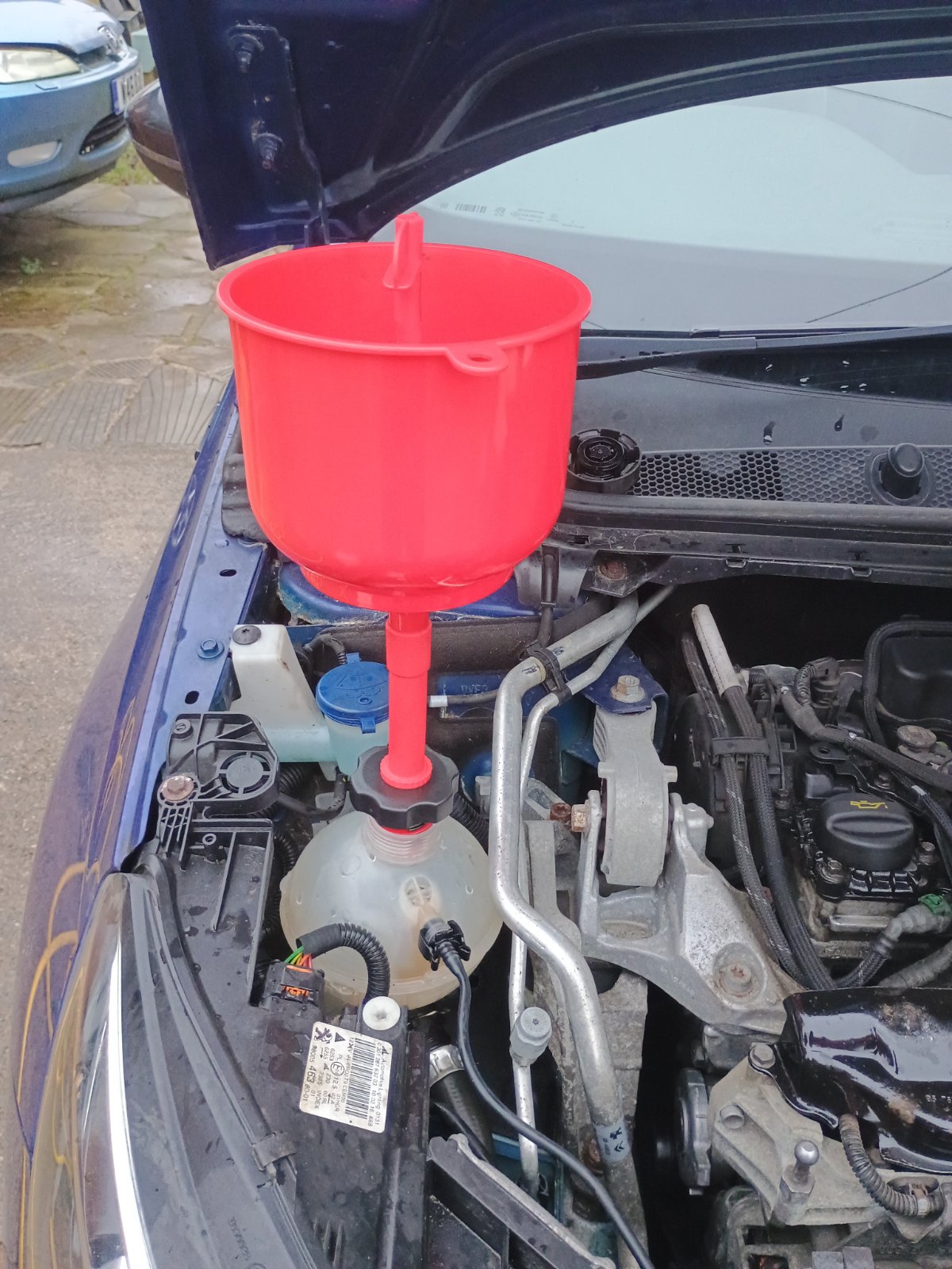

Next job on the blue 308 (with a tip run to warm it up) is to put this into the system:
Toolstation flush
Toolstation flush
Some decent and hopefully "near enough" instructions here:
viewtopic.php?p=627831#p627831

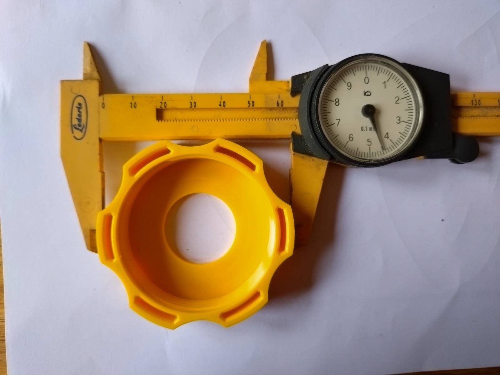

Not 100% success on the funnel sets ** (explanation of why plural shortly) - none of the supplied radiator caps are anything like the 308's header tank thread diameter. Some of the rubber seals sit in the neck of the tank ok, so looking like a slightly precarious "ram it in and hopefully won't drop off half way through!" Method coming up!

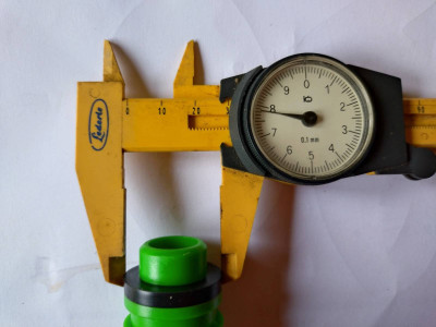

MattBLancs wrote: 15 Feb 2025, 13:16 Not 100% success on the funnel sets ** (explanation of why plural shortly) - none of the supplied radiator caps are anything like the 308's header tank thread diameter. Some of the rubber seals sit in the neck of the tank ok, so looking like a slightly precarious "ram it in and hopefully won't drop off half way through!" Method coming up!

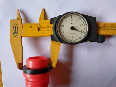

That's interesting Matt. Considering I bought mine for the Subaru which it fitted perfectly and then the MX3 which also fitted perfectly I wonder if it is a case of you get what you pay for as yours was half the price of mine? :-D Might be interesting to measure the seal diameters on yours and compare them with mine which I'll go and measure now! :)

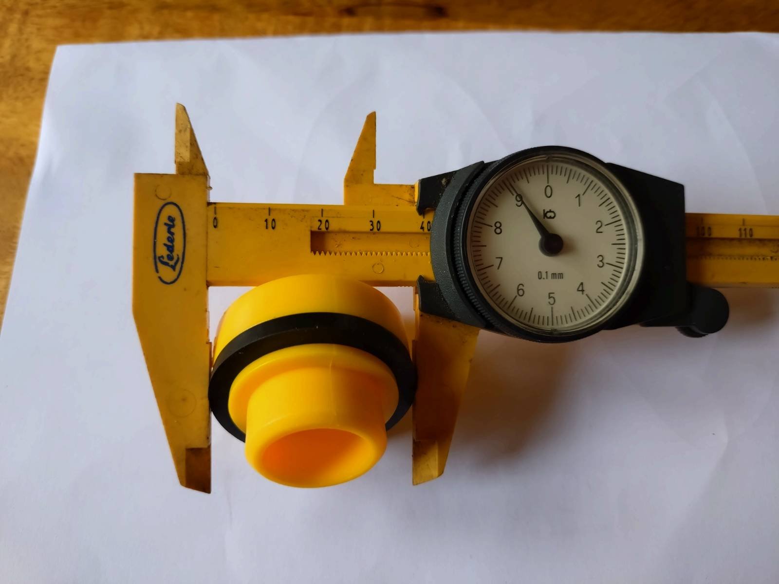

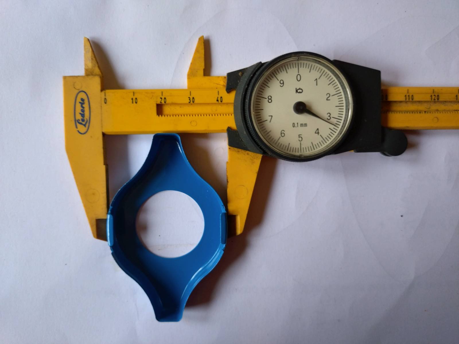

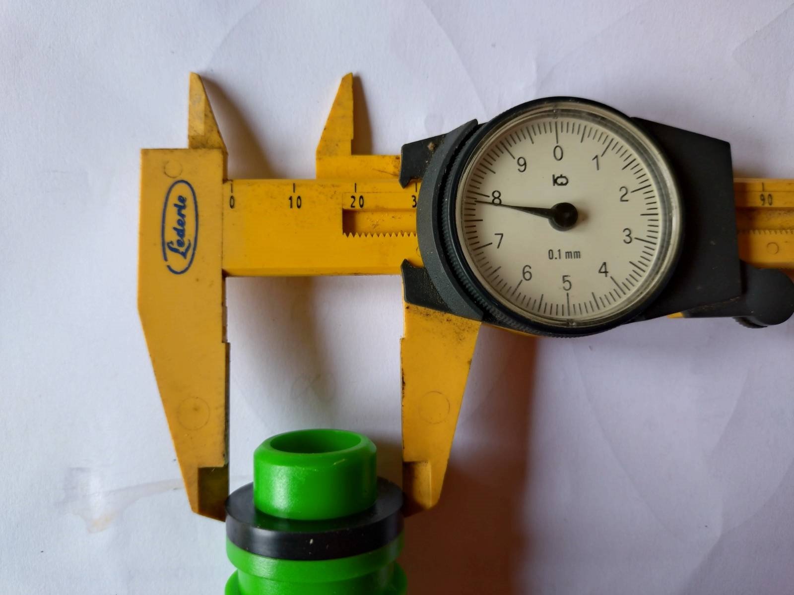

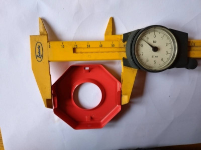

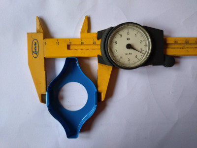

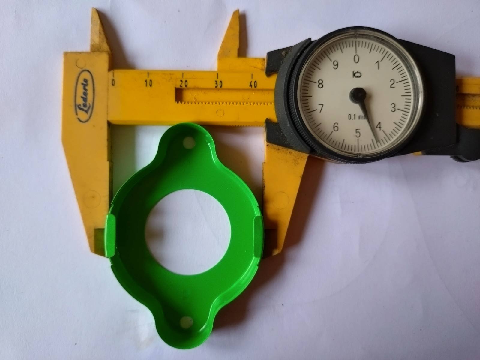

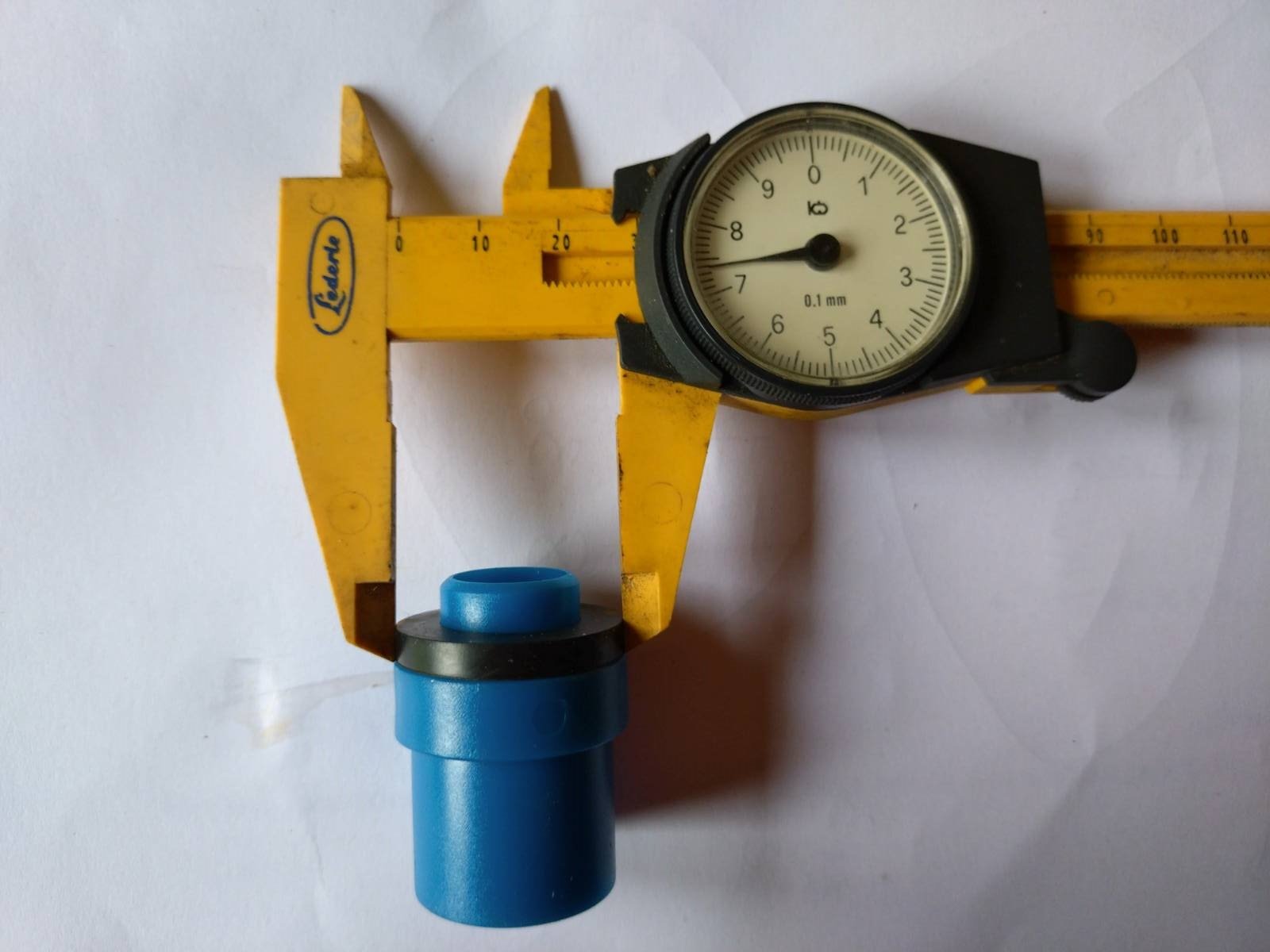

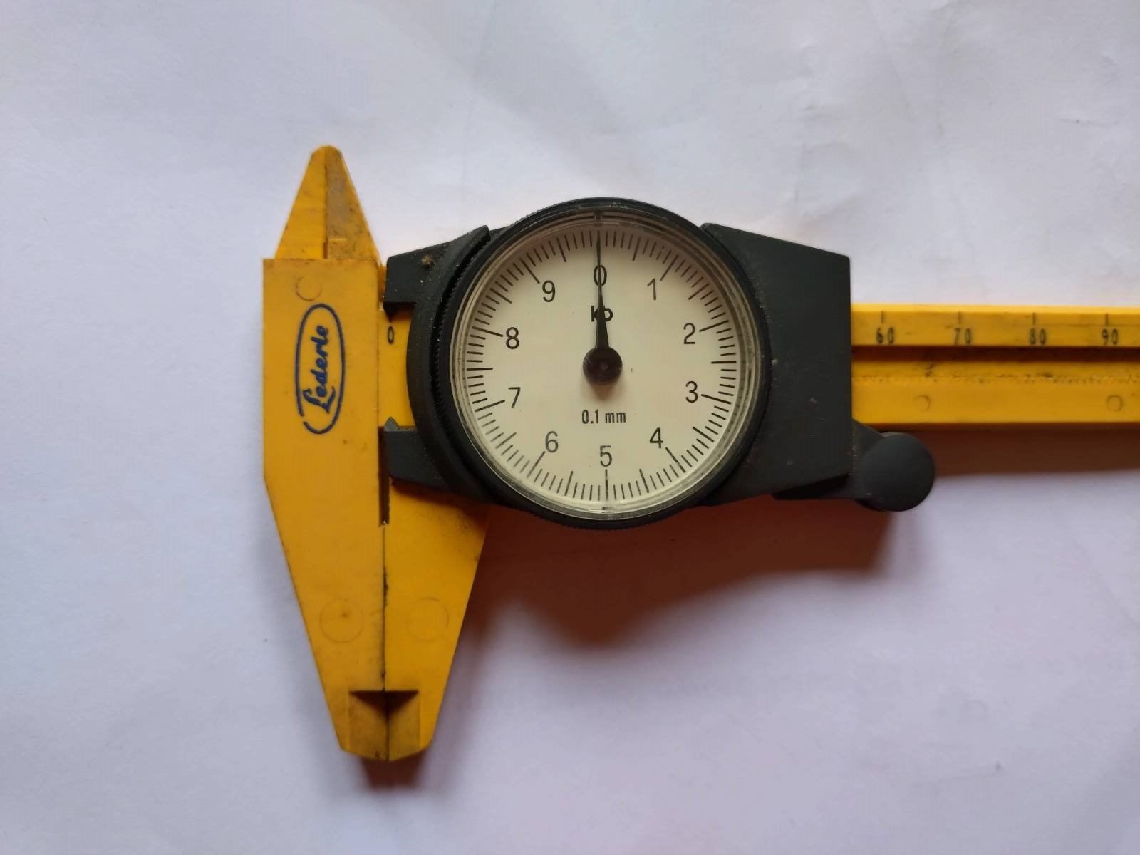

Here you go:
Calibration
Calibration
Baby
Baby
Infant
Infant
Junior
Junior
Senior
Senior
Adult
Adult
How do they compare? :-D

mickthemaverick wrote: 15 Feb 2025, 13:47 How do they compare? :-D
Sorry Mick, I've not been clear, it's the "radiator cap" bit that's not got a Peugeot sized option, the seal bits look similar to yours (will measure in a bit) - just cannot lock them on.
Posts: 21364
x 8162
Aah right!! The blue and green options in my kit have very very similar sizes but maybe that is where your bits differ. Not sure how to measure them, maybe diameter across the lugs? :)

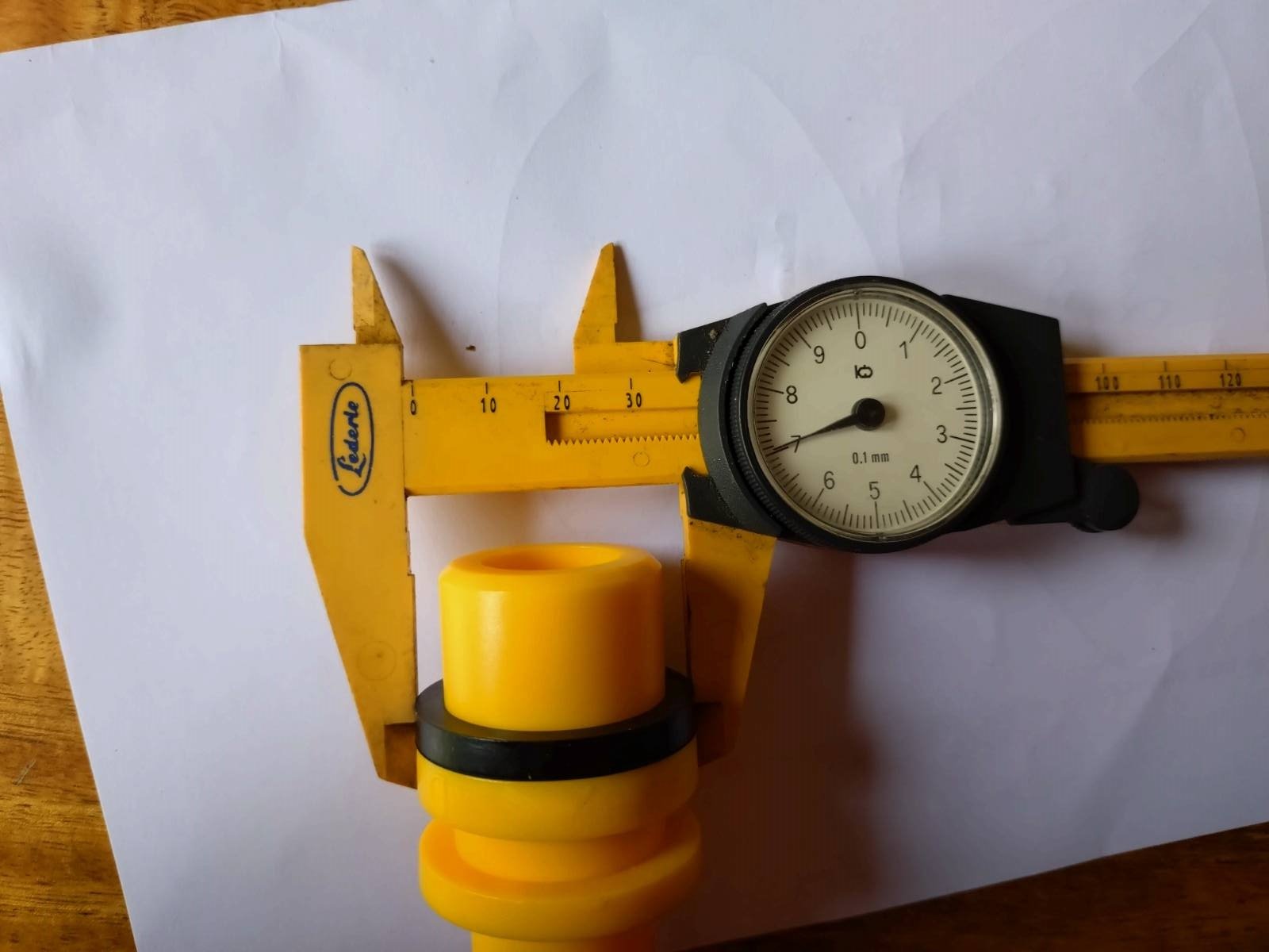

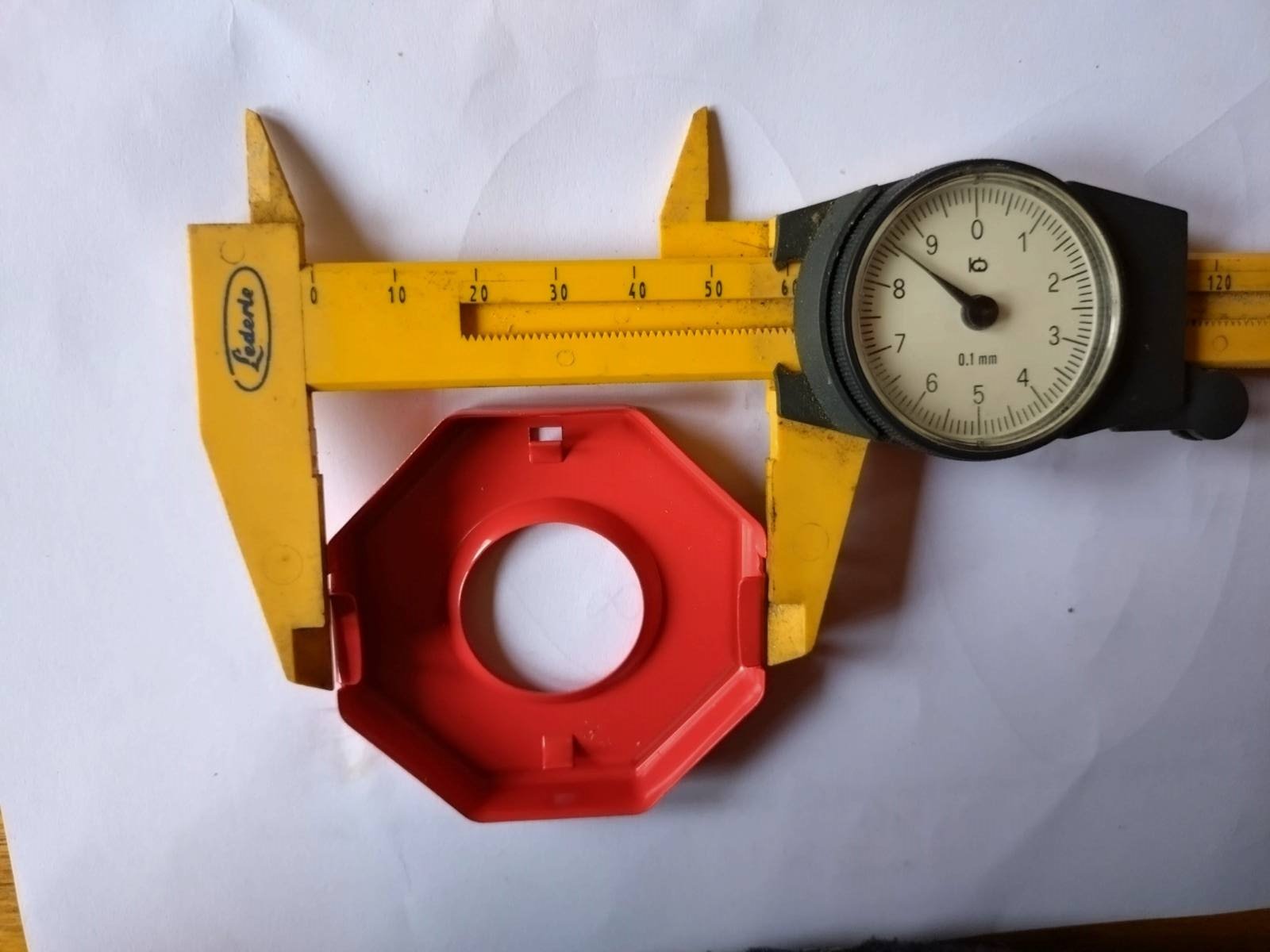

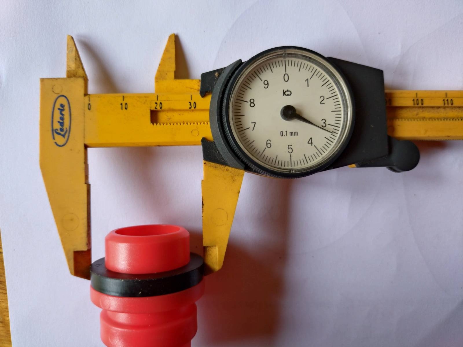

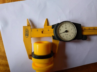

Here are mine:
Smallest
Smallest
1 up
1 up
2 up
2 up
3 up
3 up
Do any match your rad cap? :-D

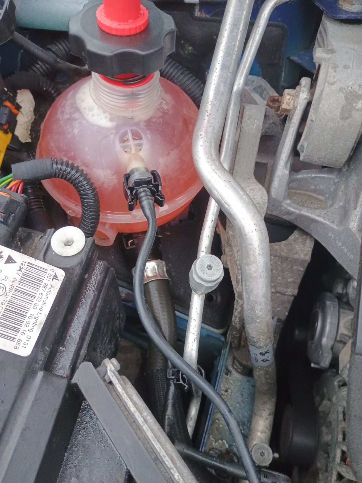

Unread post by MattBLancs »
Yes I think I have an equivalent to the yellow one and the others but mine are all black plastic / steel.
This is nearest and what I'm working with:
Posts: 21364
x 8162
I take it then that you don't have an actual radiator cap to fill from, pity cos I think it is much better that way :-D

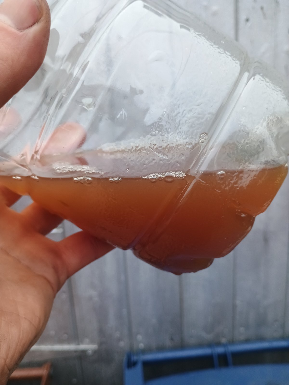

This is what was in the header tank before I started
Rusty brown, certainly not pink!
Versus new pink stuff
mickthemaverick wrote: 15 Feb 2025, 15:53 I take it then that you don't have an actual radiator cap to fill from, pity cos I think it is much better that way :-D
No, just header tank unfortunately.
Took both radiator hoses off (actually disconnected at engine end of each) and flushed with garden hose in both directions till "the juices ran clear" (as per chicken cooking instructions!!) :-D
