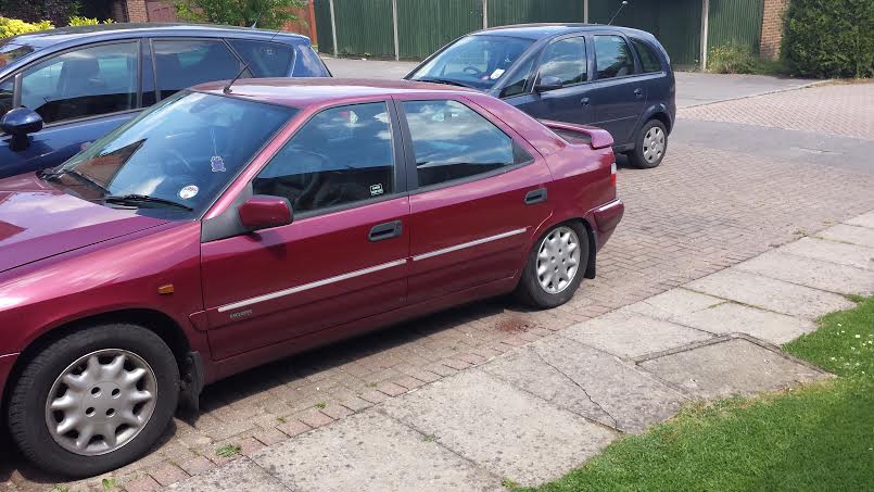

This lunchtime, I decided to take it to get clean, then I could take some pictures to send to Simon. First of all, In the interests of complete openness, I decided to see what the "rusty stain" in one of the rear door jambs really was, so poked a screwdriver into it. Perhaps I should use the words "through it" instead.... not pretty
and to make matters worse, when I started her up, she bloody well sank at the rear and refused to come up.
<insert various curses of varying offensiveness here>

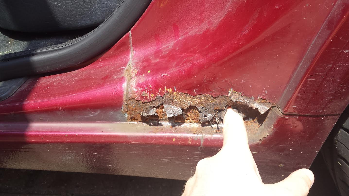

Ah crap. :( I hate rust holes... #-o
The not rising at the back is not a big deal, mine sometimes does that too if I try to go from service low directly to service high - the height corrector linkage sticks slightly and it refuses to come up. If I then put the lever back into low, then back to the middle position it obeys. It's also not very accurate at setting the rear height for the same reason - it varies up to +/- 20mm each way from what it should be. I happen to have a complete spare rear height corrector and linkage assembly unused should it be needed. I would have eventually fitted it to my silver one but obviously not now...
But damn that rust is a shame. Mine has some bubbling there on both rear door sills so I suspect if I tried I could put a screwdriver through mine too. :(
I'd be interested to see RichardW's opinion on that rust hole, given that there would be about 9 months to get something done about it instead of 6 weeks... :?

Once you get a couple of cm away from the hole, the metal is solid. I gave it a good savaging. All the flaky and rotten metal has been pulled off. I might attack it with the dremel in the morning and cut a shape out then it's more obvious.
Apart from what you saw on the pics underneath when Malcolm was repairing it, there's little, if any rust anywhere on the car. The opposite door shut is clean as a whistle.
If I could be bothered to drive it up to Lancs, I'd weld it myself. It's not a serious hole. In fact the metal around it is so solid you'd think it were a drain hole if you didn't know better. Just a massive one you can stick a finger through...

I always thought repairing that area well was going to be tough, as the metal is (was :lol: ) pretty thick and it's got a compound curve. There should in fact be the original sill directly under the top plate, and it looks like there might be a hole in the strengthener behind Mike's hand? If you look at the pics of the green one in the sticky thread: http://www.frenchcarforum.co.uk/forum/v ... 0&start=28" onclick="window.open(this.href);return false; you can see where the sill should be (but isn't anymore!!). As that has disappeared there is nothing to weld the bottom to really. So an angle plate would need to be made up, and welded into the top of the sill - either plug(*) welded, or better still, a bit cut out of the top of the sill, and then butt welded in (you can't lap it over the top as the door may not shut!! - or maybe there is enough room for that?). This will then give you something to (plug) weld the upper part to, which if you want a decent job, will need to be butt welded in to the remaining good metal. It'll be a few hours work to make a decent job of it! If you weren't bothered about what it looked like though, you could just whack a lap patch over it and underseal it :mrgreen: Best repair patch would be one sourced from a sound car.....
* Plug is the arc equivalent of a spot weld - you drill a hole in top panel, clamp them together, and then put a circle of weld on the bottom panel to hold it together.

RichardW wrote:I always thought repairing that area well was going to be tough, as the metal is (was :lol: ) pretty thick and it's got a compound curve. There should in fact be the original sill directly under the top plate, and it looks like there might be a hole in the strengthener behind Mike's hand?
My hand is like that because my finger is all the way through the hole :-)

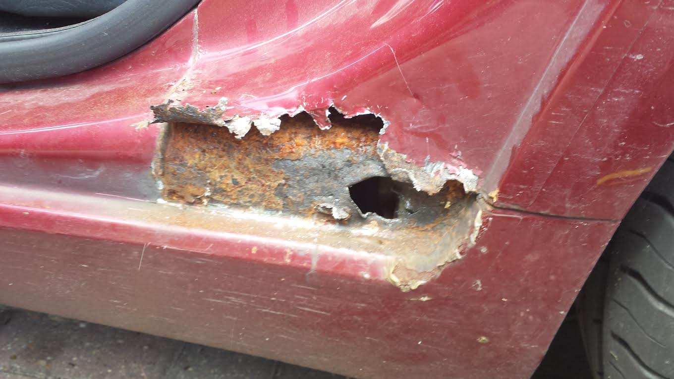

So, the whole area was covered in paint with just a couple of rust bubbles. I decided rather than waste Simon's time more, I'd find out what was under it with the screwdriver. So I picked a bit... then it looked like this..
Of course, I couldn't stop then. I had to pick more and more and more until I had got rid of all the rusty metal.
Was the final result. The main sill (the inner bit) is actually pretty solid. I've given it a good battering with the screwdriver, so it might be ok to weld to if one can fashion a repair section for it, though I think it's (-expletive removed-) to be frank.

RichardW wrote:I always thought repairing that area well was going to be tough, as the metal is (was :lol: ) pretty thick and it's got a compound curve. There should in fact be the original sill directly under the top plate, and it looks like there might be a hole in the strengthener behind Mike's hand? If you look at the pics of the green one in the sticky thread: http://www.frenchcarforum.co.uk/forum/v ... 0&start=28" onclick="window.open(this.href);return false; you can see where the sill should be (but isn't anymore!!). As that has disappeared there is nothing to weld the bottom to really. So an angle plate would need to be made up, and welded into the top of the sill - either plug(*) welded, or better still, a bit cut out of the top of the sill, and then butt welded in (you can't lap it over the top as the door may not shut!! - or maybe there is enough room for that?). This will then give you something to (plug) weld the upper part to, which if you want a decent job, will need to be butt welded in to the remaining good metal. It'll be a few hours work to make a decent job of it! If you weren't bothered about what it looked like though, you could just whack a lap patch over it and underseal it :mrgreen: Best repair patch would be one sourced from a sound car.....
There just appears to be fresh air between the top "outer sill" and the strengthener, as though there should have been foam there or something. It's just fresh air. Weird. If I were doing this repair, I'd cut out from the rear edge of the hole, to about 1" in front of it - a "rectangle" and weld a new piece in. It should be ok as the rest of it is actually metal not rust. Used to do plenty of welding, but I just realised looking at the calendar that it's more than 10 years since I last picked up a MIG!

Mike - I thought the entire top edge of the outer sill had gone, but I can see now that is not the case - so yes, just a patch on that inner sill, ground back (and probably hammered a bit under flush!), then a new bit over the top to make it come right. Best finish would be obtained by using a piece cut from a good car, and butt welded in...
Mandrake wrote:I wonder if that bit of my car is sound and could be cut out with an angle grinder or dremel or whether it too is fubared.....I'm a complete know nothing when it comes to rust repairs...
There's only one way to find out..... give it a good poke with a screwdriver and see what happens. If it is solid, then it will be just a couple of minutes work to cut out the good bit, courtesy of Mr A Grinder :mrgreen:
