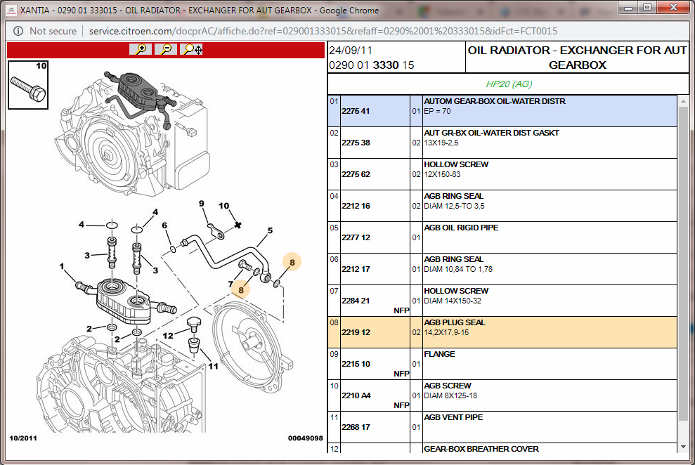

If I'm doing a gearbox oil change shortly (which I think I will have to) one other problem I want to address is that the Banjo joint on the side leaks slightly. Apparently not much because the level has not dropped in over a year on the dipstick but it's enough to make the joint wet with oil and the side of the gearbox oily all the time.
It first started leaking years ago when Mackies disconnected the Banjo to attach their flushing machine - they refitted the old badly pitted alloy washers on either side of the joint and of course it leaked quite badly. So at the time I fitted two new washers and it stopped leaking.... for a while...
Then it started to leak slightly. Some time later I think I replaced them a second time but it hasn't really helped. I assume the faces where the washers seal must be slightly pitted. I'm going to get another pair of washers and have another try but I think it may need a touch of some sort of sealant on the faces to get it fully leak free.
But what ? What kind of sealant can stand the heat and oil and seal between the faces and washers, without contaminating the oil stream of the gearbox, and not set hard enough that you can't remove the bolt without damaging the faces ? (EG probably not locktite :) ) Anyone have any ideas ? Crankcase sealant ? Only a very tiny amount would be needed.

Posts: 11838
Joined: 28 Mar 2013, 21:05
x 1996
Re: Simon's new Xantia V6 and Peugeot Ion blog
Unread post by Stickyfinger »
I would find a suitable washer type, would steer very wide of sealant in that application.

Unread post by xantia_v6 »
I would fit a Dowty washer https://en.wikipedia.org/wiki/Bonded_seal and also avoid sealant.
Unread post by Mandrake »
xantia_v6 wrote: 27 Jun 2019, 10:55 I would fit a Dowty washer https://en.wikipedia.org/wiki/Bonded_seal and also avoid sealant.
I like the idea of the dowty seal - I think that would work, but it would need to be exactly the right inner and outer diameters as the shoulder that seals is very narrow from memory. Can anyone decipher the exact washer dimensions from the part listing below ?
If not I suppose I could buy a couple of the original washers and measure them, I don't think I kept the old ones I replaced...
One other question is, how feasible is it to disconnect and reconnect the banjo while the gearbox still has a normal quantity of oil in it ? I assume that the sump level is below the banjo but there will be some oil from the heat exchanger lost, but not too much so I can just top it up afterwards ? I'm trying to decide whether I should try to perform the seal swap at the same time as the oil change while the oil is drained or to just do the oil change first and see if it actually helps with the gearbox operating symptoms and replace the washers afterwards, as the leak is very minor.

Mandrake
Posts: 8692
Joined: 10 Apr 2005, 17:23
x 695
Stickyfinger wrote: 27 Jun 2019, 10:26 I would find a suitable washer type, would steer very wide of sealant in that application.
I've already replaced the washers once, possibly twice in the past but it always starts leaking again very slightly so I can only assume that the face on the gearbox side where the washer seals is slightly eroded. So I think something like the dowty seal with a built in gasket may be the only option.

Forum Treasurer
Posts: 12600
Joined: 07 Aug 2002, 17:12
x 1491
Unread post by RichardW »
Bad news on the 'box if it is on the way out....
I would read that as 14.2mm ID x 17.9mm OD, the last part is the thickness, which doesn't quite make sense, as elsewhere for bolts this is given in mm which suggests a thickness of 15mm, but that can't be right! Perhaps it is 1.5mm. Anyway the bolt is M14, so an M14 Dowty washer will do - loads on e-bay.
Mandrake
Posts: 8692
x 695
RichardW wrote: 27 Jun 2019, 11:49 Bad news on the 'box if it is on the way out....
Thanks - it probably is 1.5mm, that sounds about right.
I guess another consideration when choosing a dowty washer is both the metal used for the metal part, and the rubber used for the rubber part - which needs to be something like viton for oil resistance.
The original washers are aluminium alloy same as the gearbox housing however I was able to successfully replace them with copper washers on the old V6 - although I only ever considered that a temporary fix...

Mandrake
Posts: 8692
x 695
Ordered a pack of 10 of these for a few quid:
https://www.ebay.co.uk/itm/Bonded-Seal- ... sLFUDzLwJw
Doesn't say what metal it is but the rubber is oil safe nitrile so should be OK.
