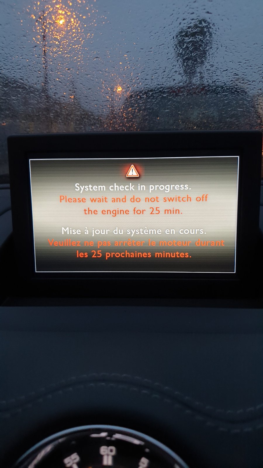

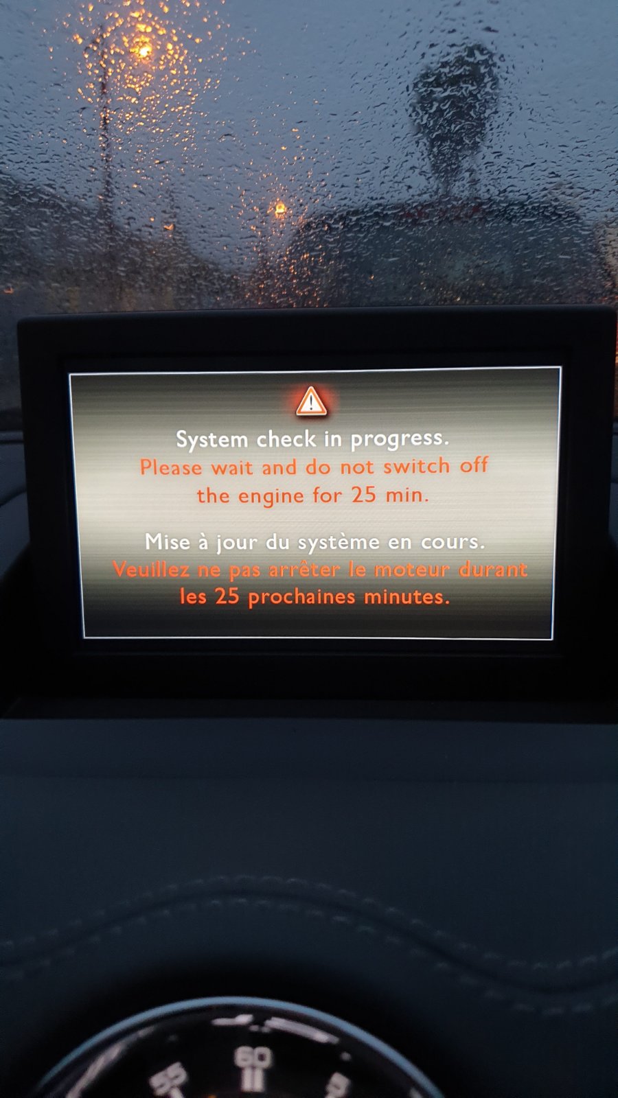

I´ve got here a problem on the NG4 of my RCZ and i need your opinion, if you can. On the radio LCD it appears a message says: "System check in progress - Please wait and do not switch off the engine for 25 min"
It stays like that forever.
I tested de 1+2+3 and 1+3+5 buttons but nothing. Sometimes the radio shuts down and turn on again but the message are always there.
Do you have any aidea what could be? It´s a new one?

When you say it’s a new one, do you mean you have replaced the head unit?
It can be several things. It needs to be coded to the vehicle if it was from another vehicle.
Or it could be a corrupt hard drive. Best to get the latest firmware on USB and insert that into the USB port and see if it will correct the errors.
Lastly it may be an internal fault with the head unit.
Try the firmware first and see if it will reinstall from it, but it may take nearly an hour to do so make sure the car in running.

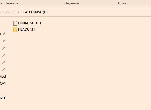

I have a fat32 usb stick with the ng4-n42c unzipped.
Just insert it on the aux usb input and turn on the car and the radio? It will appear any kind of message?
I´ve googled an HDD that probably fits there. How can install a new image and where can i download it, to put it on the new hdd (if the old one have problems of corse)

Once you fit the new hard drive insert the firmware on the USB and start the car.
