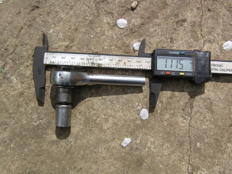

an absolute doddle with one of these.ekjdm14 wrote: awkward cambelt cover bolt at the back
Just a cheap 3/8 Drive Ratchet, cut down
with a 1/4 Dr' 11mm socket and 3/8 to 1/4 adapter
NB: interesting to see the pix of the engine 'carnage', saved the offline pages for future reference. Not a step I'm ready to take, going into such detail myself, but will probably happen in the future
Puxa
- Posts: 55066
- x 8391
Re: Black Xantia NA Diesel auto... She lives!!! :D
Ahh! Just like me
If a tool for the job does not exist I make one... I have a massive collection now...
