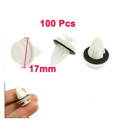

The white clips (I don't think I have any photos at hand of those) are made of really hard plastic, I needed to use a big flat screwdriver, and aim at the right side which unhooks them ... there should be a tool available that does this with ease, but I don't want to order something like that for a maybe-once-in-a-few-years procedure ...
The clips are similar to these below (but the actual clip part is slightly different)

Tools - The plastic tools are worth the little they will cost from Ebay, yes there are cheap bits from China, but if the only last one job they would still be worth it.
Clips - I just bought 10 pieces from Ebay, broke 2 when removing the rear book cross-panel with a flat screw driver, hence why I now have the tools, Clips were "Citroen Relay Fiat Ducato door trim moulding panel clips C73" for £2.99 delivered, ones listed for the C5 were dearer but were exactly the same!!

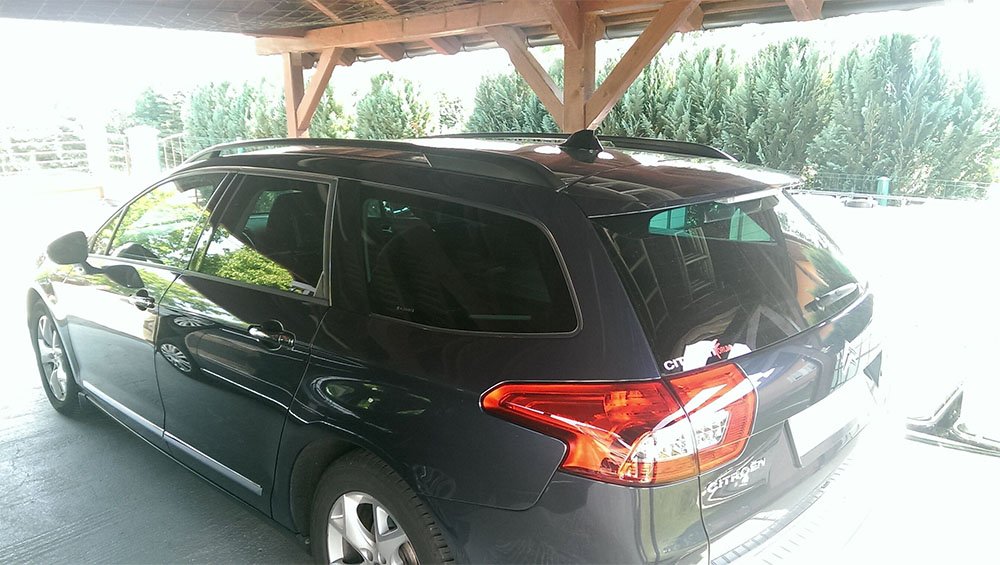

New exterior treatment ... shark fin antenna (actually for a C4) ... it's not fitted, just put in place, I'll need to modify the plastic base (it's line follows the roof of a C4, not compatible with a C5), or I'll need to figure out how to glue it (with what), instead of the 3M layer which is currently unusable as is on the bottom (since it is in the air). What do you think?

If you don't have a tool and can't wait, an old biro type plastic pen, a hot air gun, a screwdriver or similar to shape the softened plastic, maybe a file to finesse the edge once they have cooled, make your own in moments. Yes they break, some more easily than others and pen plastic varies in quality, but free and can easily do custom shapes.Sloppysod wrote:Comments to the above.
