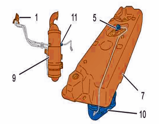

There are no tests as such I am aware of, but this is the info I have on the components and the pin-outs you may find useful.
So the issue is with (10) which contains the pump inside. The unit is overheating, so is disabled.

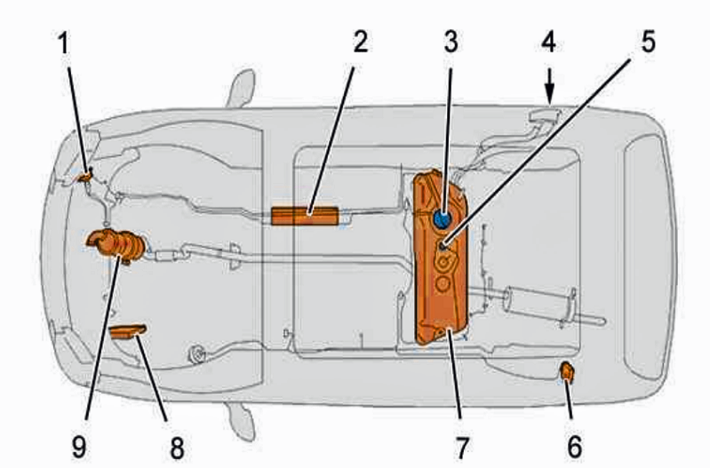

| Reference | Designation | Electrical diagram number |
| (1) | Particle filter differential pressure sensor | 1341 |
| (2) | Fuel cooler | - |
| (3) | Fuel tank unit | 1211 |
| (4) | Fuel filler cap - incorporating: | - |
| (4) | Fuel tank cap presence sensor | 4320 |
| (5) | Fuel additive injection valve | - |
| (6) | Fuel additive ECU | 1282 |
| (7) | Fuel tank | - |
| (8) | Engine ECU | 1320 |
| (9) | catalytic converter + Particle filter (FAP) | - |
| (10) | Additive tank | - |
| (11) | Downstream exhaust gas high temperature sensor | 1343 |

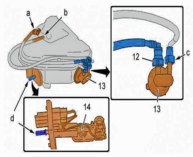

Now on this model you have a separate additive ECU (EAS200), so the addive function is NOT controlled by the engine ECU as on some other models.
| "a" | Fuel additive filling inlet |
| "b" | breather |
| "c" | breather |
| "d" | Outlet to fuel additive injection valve |
| (12) | Filling union (by the Customer Services) |
| (13) | Filling union (at the factory) |
| (14) | Fuel additive pump (1283) |

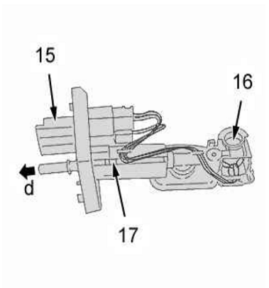

| (15) | Connector |
| (16) | Fuel additive level sensor (*) |
| (17) | Positive displacement metering pump |

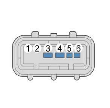

Fuel additive pump connector
| Channel of the fuel additive pump connector | signal | Terminal at the fuel additive ECU (1282) |
| 1 | - | - |
| 2 | - | - |
| 3 | RCO signal | 9 |
| 4 | Earth | 8 |
| 5 | Fuel additive level measurement signal (*) | 6 |
| 6 | Fuel additive level measurement signal (*) | 7 |
