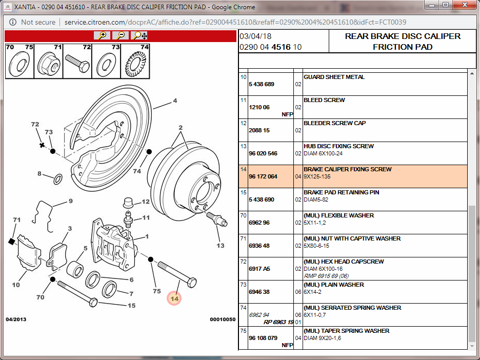

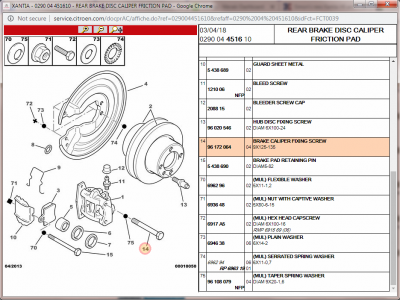

Service Citroen seems to be having problems for me today - lots of errors and timeouts but I eventually managed to look it up and as far as I can see the bolts are still available ?RichardW wrote: 29 May 2019, 15:37 Bolts are not listed as NFP by Citroen, but when you click on them it says part number not known![]()
Although it doesn't show it on the diagram its two bolts per side, surely ?
Unfortunately they are M9x1.25 which is an odd size,so might be difficult to source elsewhere.... go very gently to avoid breaking them!!
Yes.

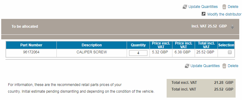

I ordered rear discs and pads from AEP yesterday - £55 all up including delivery to work, and Bosch branded so not too bad I think. Should have them in about 3-4 days as they have had to back order them.
I just need the caliper bolts now which I think are Citroen only although at around £25 for a set of four I'm wondering whether to chance it and only order them if I run into trouble with the original bolts... as its not the end of the world if the Xantia is off the road for a few days. That £25 could be put towards something else like a much needed coolant and oil/filter change.
