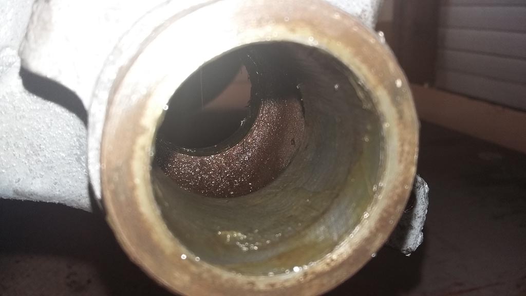

Stickyfinger wrote:I cannot Jim, I have yet to look with my 10x loops on but with normal eye sight...not a thing. The joint was tight and the metal "O ring" was there.
I thought that might be the case and that is my experience exactly of such failures... They only have to be microscopic to wreak absolute havoc...
It'll be by the flare or by the head of where the union nut sat. Both are potential stress-risers.
Don't chuck the old pipe. They are NFP and thus valuable now...

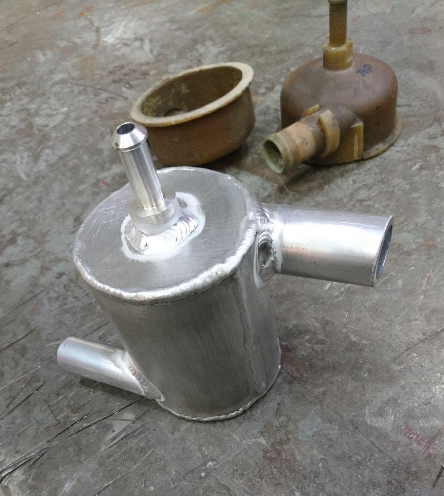

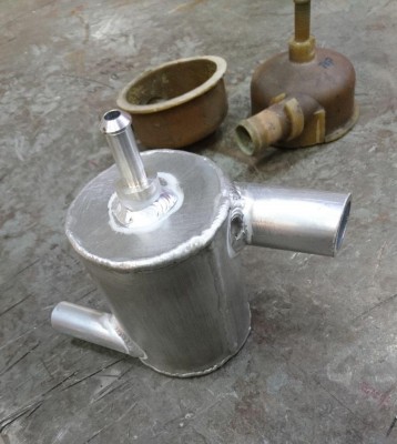

On a more positive note I will not have any "coolant swirl pot" problems now. This is from scrap pieces of stainless and made by a friend who builds warships so should be suitably strong.
Maybe I should change my resistance to car names and call the Activa "Pugwash" from now on :)

That new swirl pot is sweet 8-)

No bend/kink, the pipe tail was perfectly straight, it came out of the hole easily as per the other pipes have. I cannot see any scuff marks or pressure points on the pipe. The pipe looks perfectly round. I tried tightening it roadside, it did not help. There is zero corrosion on either the pipe or the threaded collar.
Looking at it there is an incomplete (not all the way around) marking from the metal collar, maybe it was not seating correctly ? I have yet to look under magnification.

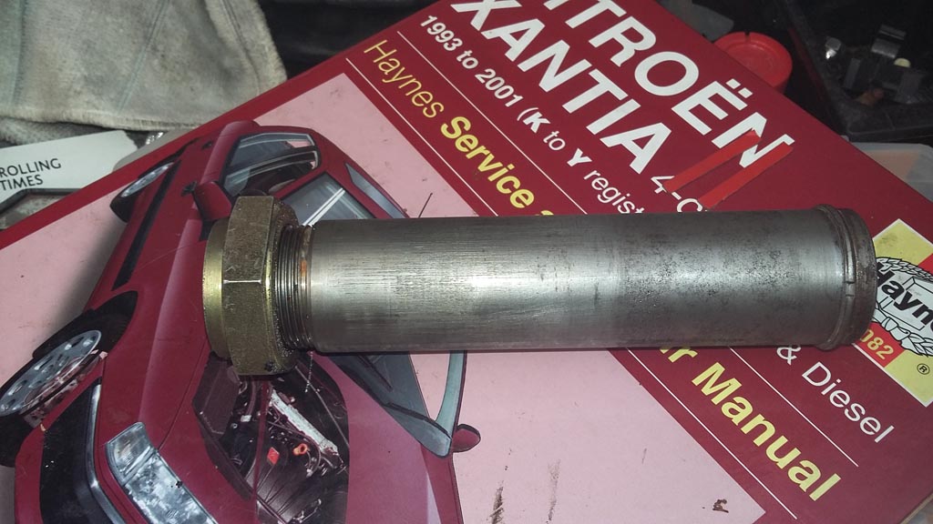

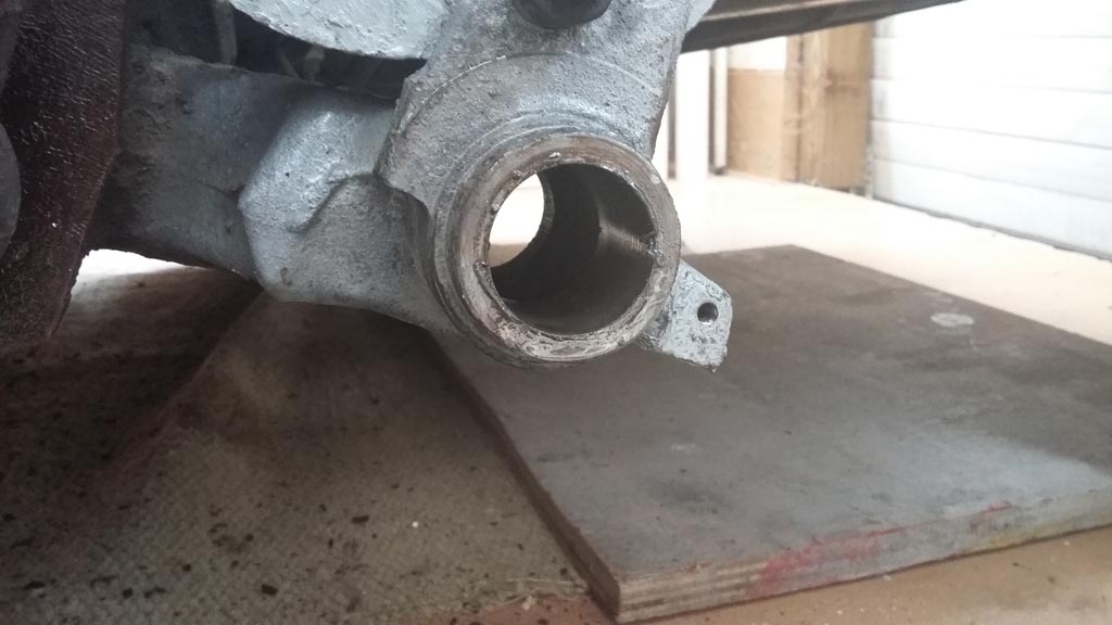

So today I embarked on replacing the rear left side bearing/hub.
So, as per advised on here I pulled the hub off and removed the remaining race.
On inspection I found this

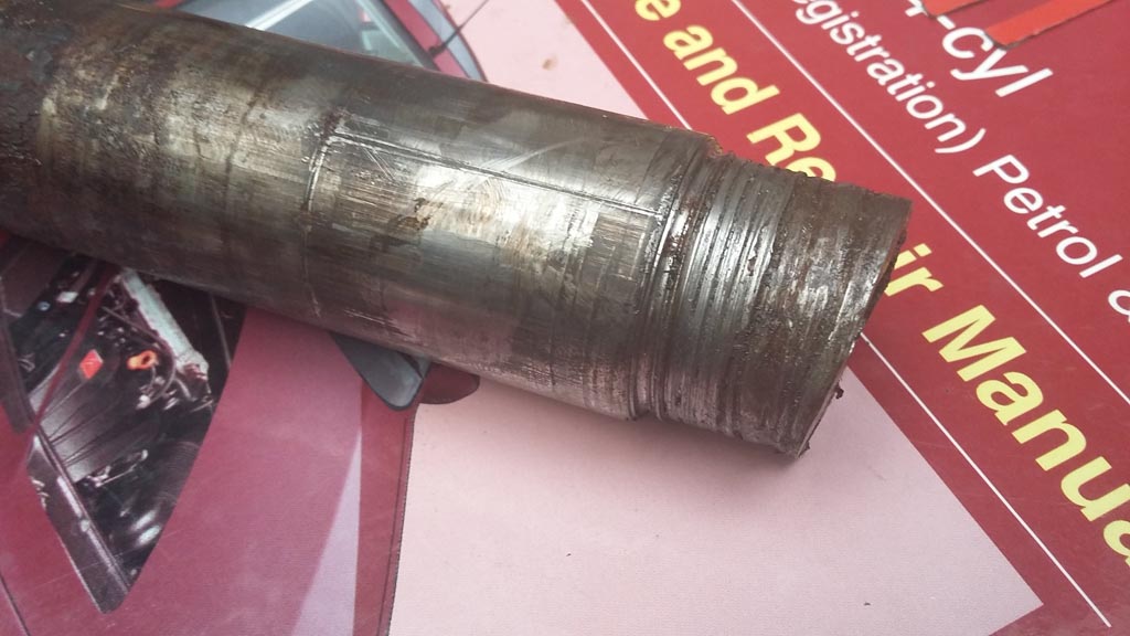

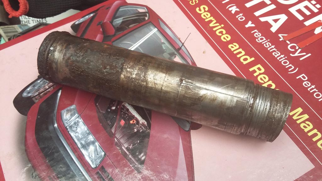

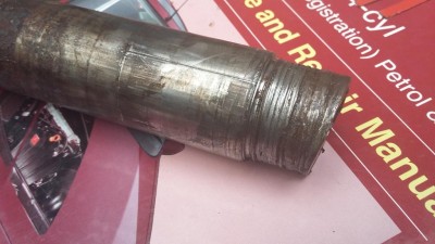

Stripped sub shaft threads, lots of thread lock....a LaBodge ! Lucky I kept the wheel I think.
Two points found on removal....Haynes BoLies is wrong.
The shaft drifts from the outside inwards towards the car, there are NO splines or circlip, just a "snap ring to prevent it pulling through. It is hollow on both sides to enable a long drift to be inserted for insertion and removal.
(Note:....I hit the end as it was already scrap, that is why it is bent....note the threads however)

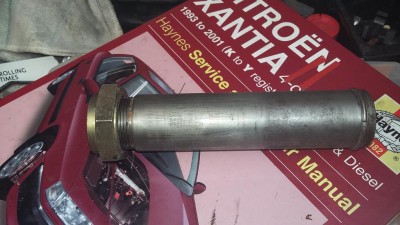

The Arm and the new stub shaft
Posts: 55135
x 8415
Re: I am an Activa owner...a V6 and I am an addict
That was a blessing you did the bearings and found this bodge Alasdair... You could have lost a wheel at any time under enthusiastic cornering...
Good to see how to replace duff stub-axles :) Easier then interference-fit splined ones for sure... That is a bit of good design for a change!
