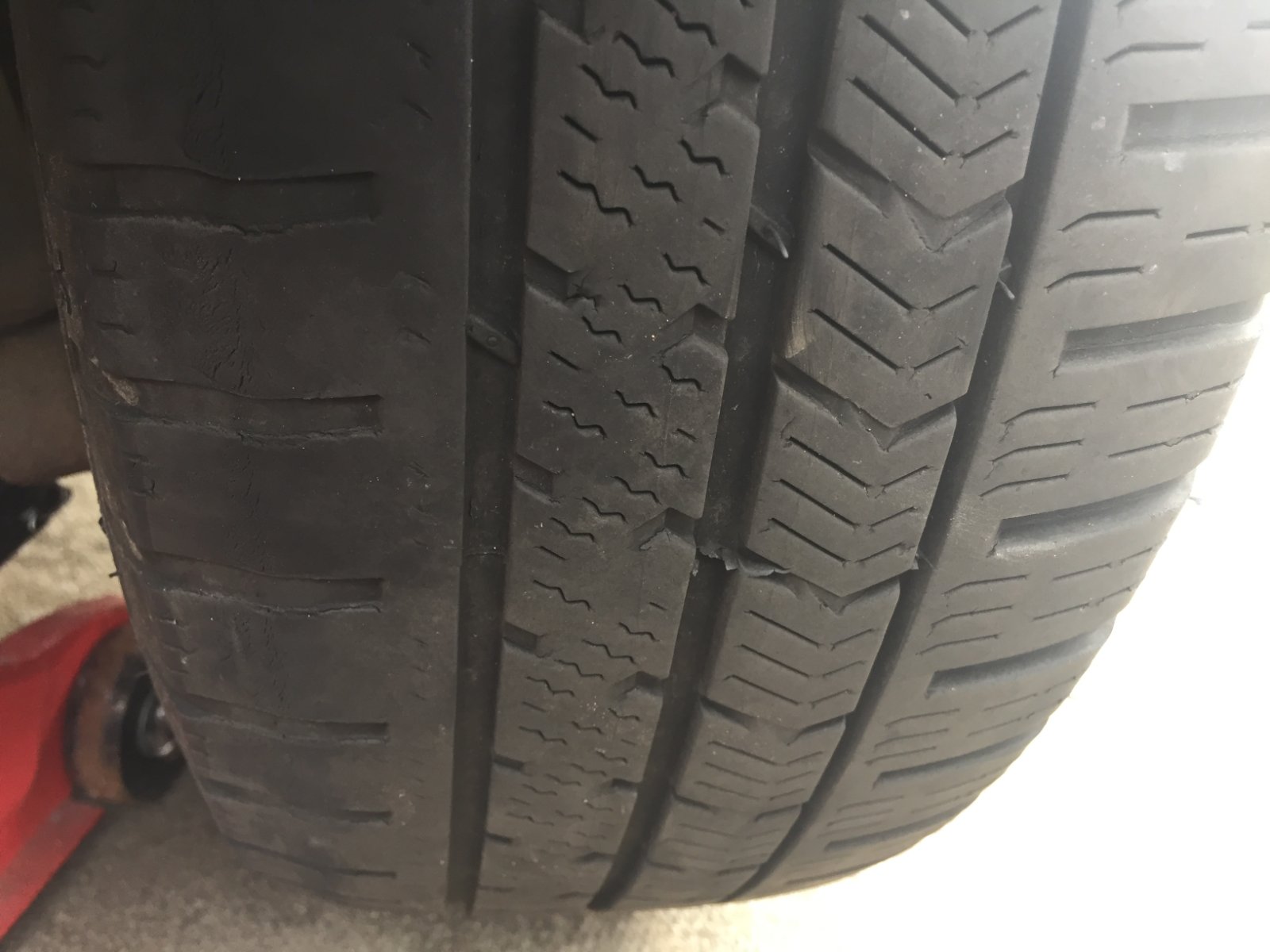

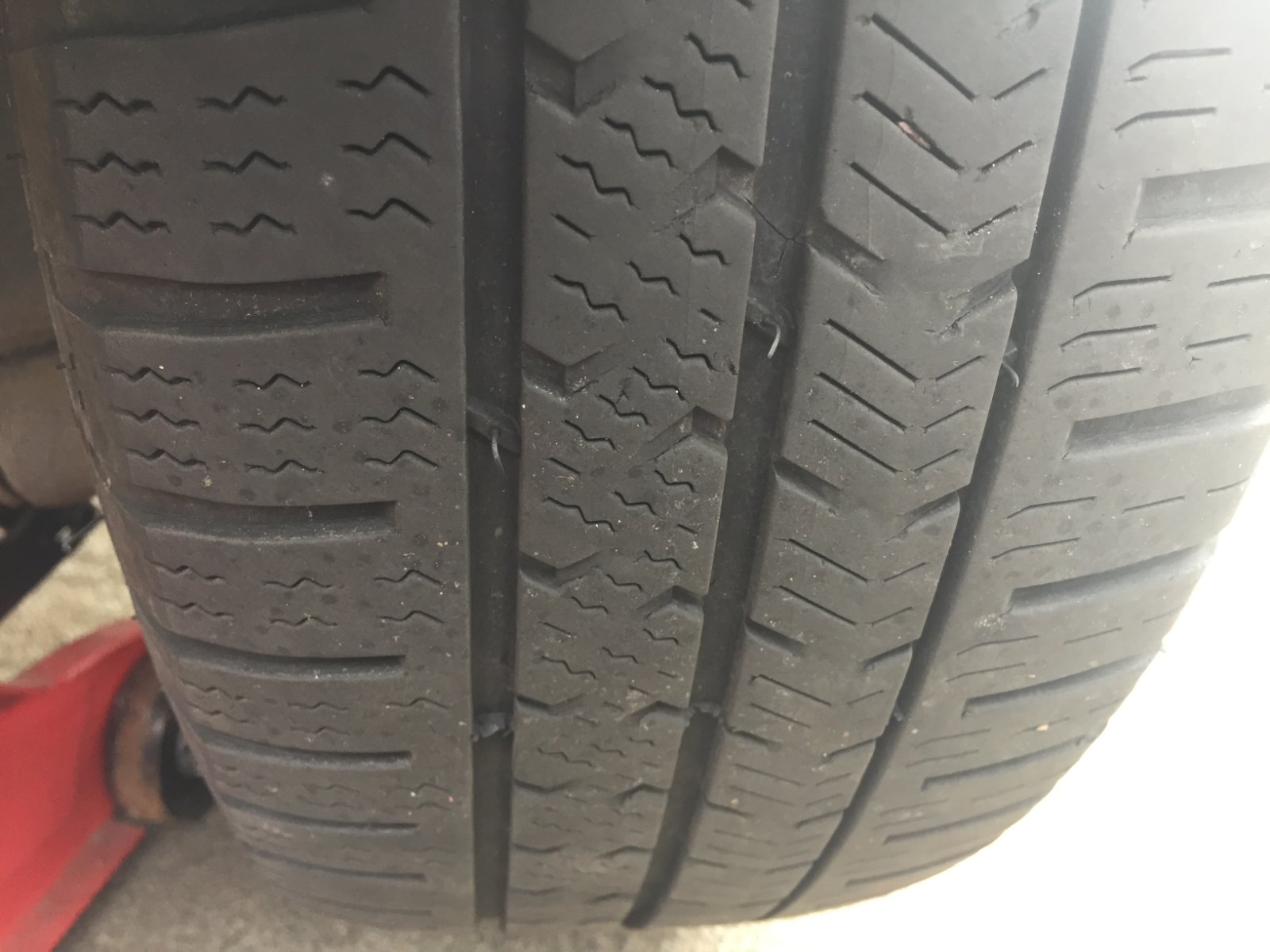

Looks like my run of bad luck continues! #-o
Despite just passing its MOT I happened to catch a glance of the inside tread of the right rear tyre and it looked completely bald! :shock:
Jacked it up to have a closer look and discovered something very odd indeed - it's almost bald on the inside edge over about 1/3rd of the rotation but OK on the rest!
The two pictures below are the same tyre just rotated 180 degrees:
Wow, never seen anything like this in 25 years of driving... The tyre has done about 20k miles and the tread depth measurements are:
Outside tread block - about 4.1mm all the way around the circumference.
Centre groove - about 5mm all the way around.
Inside tread block - varying between 0.97mm where it looks bald to 3.2mm where it looks OK. The bald bits also show cracking.
By comparison the other rear tyre which was replaced recently due to a puncture and has probably only done <5k miles is:
Outside tread block - 6.53mm
Centre groove - 7.76mm
Inside tread block - 6.36mm.
And is even all the way around as it should be and has no abnormal wear signs.
Ever since these tyres were fitted the balance has never seemed right and I took it back to be re-balanced 3 times, despite that under full acceleration from 30-50mph there is a distinct vibration from the rear which goes away when lifting off the throttle. Keeping in mind it's RWD so additional weight is thrown onto the rear driving wheels when accelerating.
I was about to chalk it up to a defective tyre when I noticed the rim is bent on the inside edge: #-o
Given that the vibration has been there ever since I've had the car and 3mm of abnormal tread wear doesn't happen over night the rim must have been bent either before I got the car or not long after! #-o Strangely the bend in the rim is about 30 degrees rotation from where the tyre is worn but I'm sure there's some scientific reason for that... :lol:
So it looks like I need to track down a new wheel rim, and while the i-Miev rims will fit they're a totally different style of alloy that won't match so it needs to be an Ion/C-Zero rim, and they have different badges in the middle, so I'd need to check if the badge in the middle is removable if it was a C-Zero rim.
And of course it will need a new tyre. It's perfectly driveable at the moment so it's not urgent however I think I'd like to get a replacement rim and new tyre before next winter as the inner tread is the winter side of the tread pattern and there is not much of that left now!
I jacked up and checked the other three wheels around their full rotation - both the inner and outer edge of the alloys and the tread of the tyres and they're all fine so it's only the one wheel that has an issue.

Simon I presume the rears are the regenerative brakes, so could be the bent wheel rim is concentrating the forces braking and acceleration + cornering excessively in that spot - just a theory :?:

Yes the rear wheels do both acceleration and regenerative braking as it's RWD. The regenerative braking is not particularly strong though - maybe 0.2G maximum, the rest is done with friction brakes.

It's possible to have a wheel/tyre perfectly balanced but geometrically non-circular, which will produce a smaller or larger amount of vibration. Years ago I rejected a couple of brand new Avon tyres which were non-circular, and where no amount of balancing would rid the car of vibration. Am now in the habit of taking a peek at the lower circumference of the tyre (under the cowling on the balancer machine) to check that there is no run-out.
That uneven wear of yours really is grim.
