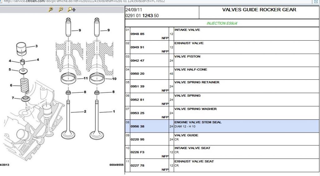

Re: Xantia V6 broken exhaust (update: and rough low rpm runn
Thanks Richard, obvious in hindsight.
I assume part number 3 "Valve piston" is the hydraulic bucket. Yours for a mere £25 each from Citroen, so £600 for 24 of them.
I think I'll just try the thicker oil...

I don't know, but realistically replacing any of them is only a mental exercise.Hell Razor5543 wrote:I wonder how much these are?;
Apart from probable cost its a camshaft out job which I would only contemplate if I had the camshafts out to seal the bottom cam box seals.
If the change of oil doesn't do anything for them they'll just have to stay noisy and I'll cross my fingers that the engine still passes the emissions test come MOT time.
I have to say though, the improvement since cleaning all that silicone grease out of the spark plug lead boots has persisted all week, so it looks like despite all the multiple goings over the ignition system has had in the last year that the engine has still been experiencing intermittent ignition misfires.
And the "lean" reading on the O2 sensor may have simply been caused by an ignition misfire passing a lot of unburnt oxygen into the exhaust. I certainly haven't seen any lean readings on the O2 sensor since I cleaned the plug wires and I'm tempted to change the fuel pressure regulator back to normal to confirm the diagnosis.
It makes me want to thoroughly clean out any silicon grease that I had previously put in the spark plug boots as well - I did wipe the spark plug top electrodes clean of grease last time I had them out but getting the inside of the boot completely clean and free of silicone is difficult unless I could find a solvent for that kind of grease that wouldn't hurt the rubber - but from my quick searches it appears there is no good solvent for silicone grease and that manual cleaning is the only way to get it (mostly) off.
