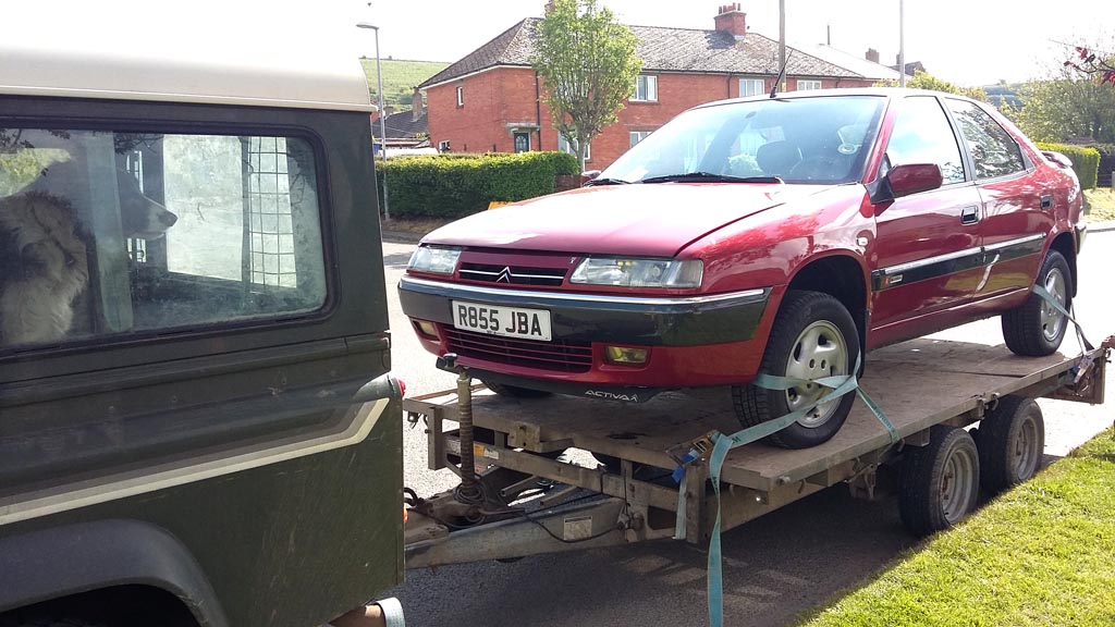

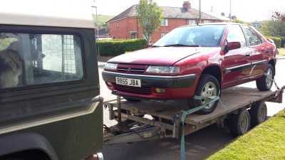

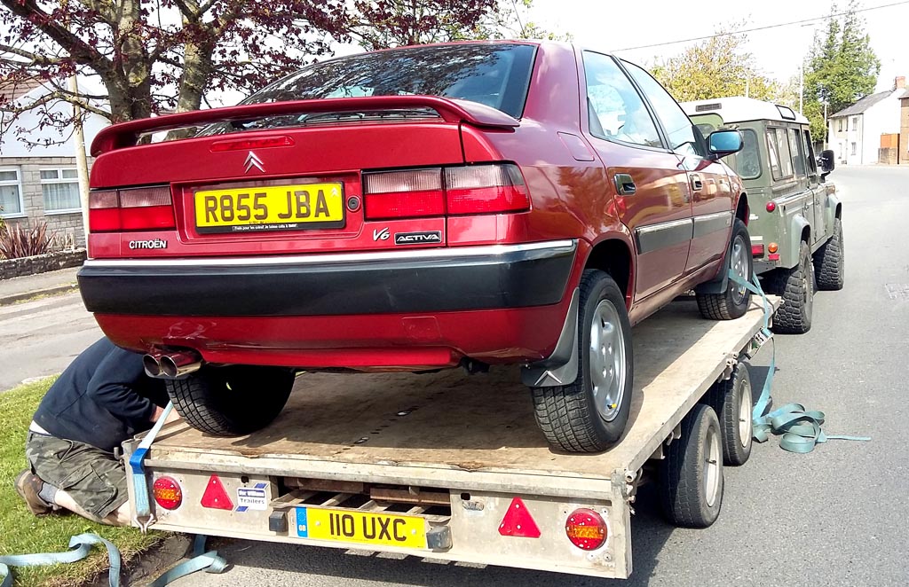

Well she let me down today, I have had to abandon the Activa in the middle of Dorset in a tiny village with LHM spewing out like a jet wash from/past the main accumulator pipe union.

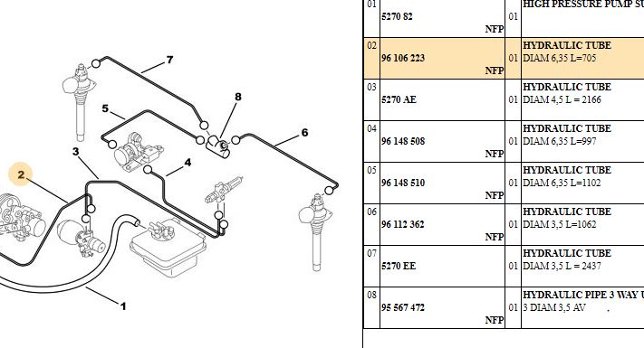

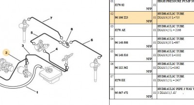

Jim assures me it is a micro-fine stress fracture just after the flair/bulb at the accumulator end.
Rescued by my fantastic friends up the hill.
I have a spare from the Green Goblin, so off with a trailer in the morning to drag the old dog back and change the pipe........booooooger

Seen this exact fail in the past - mainly on BXs - and honestly, the split can't be seen with the naked eye but it sure leaks well under pressure.. It'll be around the flare...
A brazing repair is possible and do keep the old pipe as they are NFP and like rocking horse poo..
All the best for getting home OK today...

I think that the issue here is metal fatigue, that of the original pipe and that of any repair. The pipe flexes due to engine vibration, especially if a fixing clip has been left off, and that pipe also flexes with the pressure pulses from the pump (especially if it has run with a flat accumulator).
Soft solder joints are very prone to failure due to fatigue, silver solder and braized joints much less so, particularly if well sleeved, but try to avoid just shifting the flexing to the end of the sleeved section.
