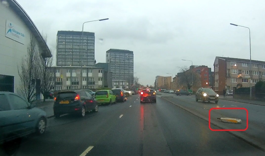

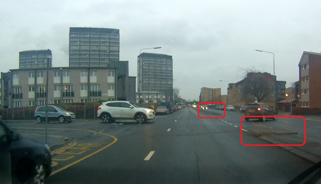

You have a really good case against the council/highways authority.
As well as your dashcam footage, try to get several photos (day and night) of that island too, a.s.a.p.
Apart from a warning bollard (arguably illuminated on something like the A74 in a lit area), the island's kerbing should have had some white paint on it.
I would be claiming on insurance, and also submitting a claim on the authority.

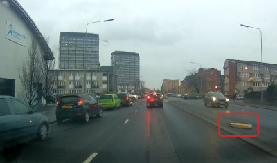

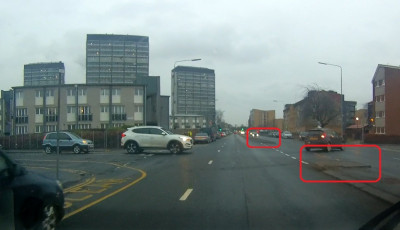

It's a real pain to get back there to take photos as it's a long way out of my way, however I have plenty of footage from my Dashcam from earlier in the day which I've saved that I can capture pictures that show they are missing before I got there, such as:
Hurrah for Dashcams!
I've reported the location on fixmystreet.com which publicly reports the problem on the site and also sends the details directly to the council. My public posting is anonymous but the council get my name email address and phone number so let's see if they reply...
By the way fixmystreet.com is a cracking website for reporting problems, you can also look up a location and see everything other people have reported - it's amazing how many reports of problems you can find in your own area!

Re: Simon's new Xantia V6 and Peugeot Ion blog
Bummer
Certainly worth a try claiming but you'll need to pursue it to death ...short term answer fingers crossed for the garage and hope for minimal costs / delay
Good Luck
Good Luck
I ran over one of those traffic calming things unlit, and a filthy night, jutting out into a road I was unfamiliar with, right over two kerbs.
Ripped both nearside tyres to shreds, and damaged the nearside steering tie rod. That caused my steering wheel misalignment and the heavy but still drivable steering.
If its just that hopefully not too expensive/difficult to fix.
Onlinemyglaren
- Posts: 28690
- x 5674
Daughter #2 did that in Newcastle with one of those that sneakily curves out from the side of the road, no chance of avoiding it, smashed the wheel on he new Punto.
The rest of it fell to bits soon after
I did too on the A1 near Kettering. Also ruined a wheel and the airbag warning beeps up now and again - not the airbag light though so it has passed the last three MOTs like it.

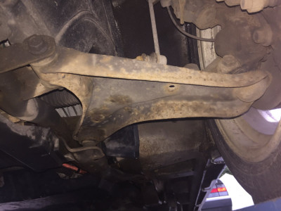

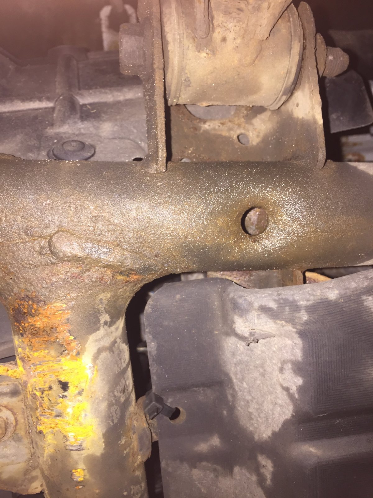

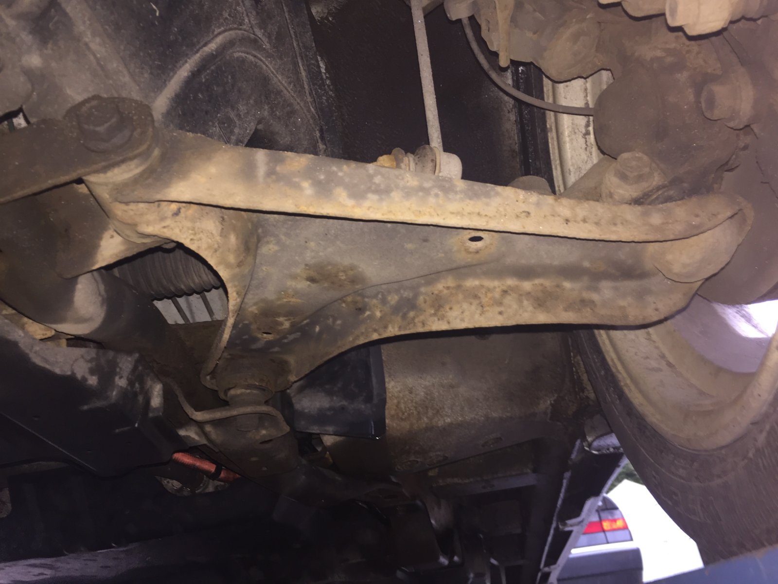

That's a bugger, Simon! You've probably just bent the track rod and / or the lower arm. It takes some force the bend the sub which usually renders it undriveable. Add up the costs of claiming on the insurance carefully - the loss of NCD and loaded premium will have an effect for a few years, and could well far outweigh the cost of repairs. Sad, but true these days....
Mandrake
- Posts: 8692
- Joined: 10 Apr 2005, 17:23
- x 695
Normally I'd agree with a wheel impact against the curb, but it's actually the front cross bar of the suspension sub-chassis that runs under the radiator that has smacked directly into the curb before the car bounced up and over the island. The towing eye which is welded onto the middle front of this cross bar is completely mashed flat, (although on the plus side maybe that absorbed some energy!) and on the left hand side of the cross bar the front/bottom side of the bar has had a hard impact as well. I'm worried that the front to rear lower bar on the sub-chassis has bent a little. I'll try to get a picture of the damage to the crossbar tomorrow before I take it to the garage.RichardW wrote: 20 Feb 2019, 20:22 That's a bugger, Simon! You've probably just bent the track rod and / or the lower arm. It takes some force the bend the sub which usually renders it undriveable.
I couldn't see any obvious bend in the lower wishbone, but I'd overlooked the possibility of a bent track rod, so maybe that could be an issue.
Yes, claiming unnecessarily and ruining no claims etc is certainly something I've thought about. I dithered about reporting it to insurance today but decided to see what the verdict was on tomorrow's inspection first.
While I'm no doubt required to report any incident involving other people or damage to other cars/property, I don't think that I'd be required to report something relatively minor like running into the curb all on my own at 10mph, when that sort of incident would typically just cause the wheel alignment to go out a bit.
Immediately after the incident I pulled over and inspected under the car as well as I could and made a judgement call that the car was still OK to drive home, and it wasn't until I'd driven a few blocks that I realised the steering centring was a bit out. I didn't notice at first because the steering centring was already out a little on the car since I've had it for as yet undetermined reasons, so it was just out by more than it was before...

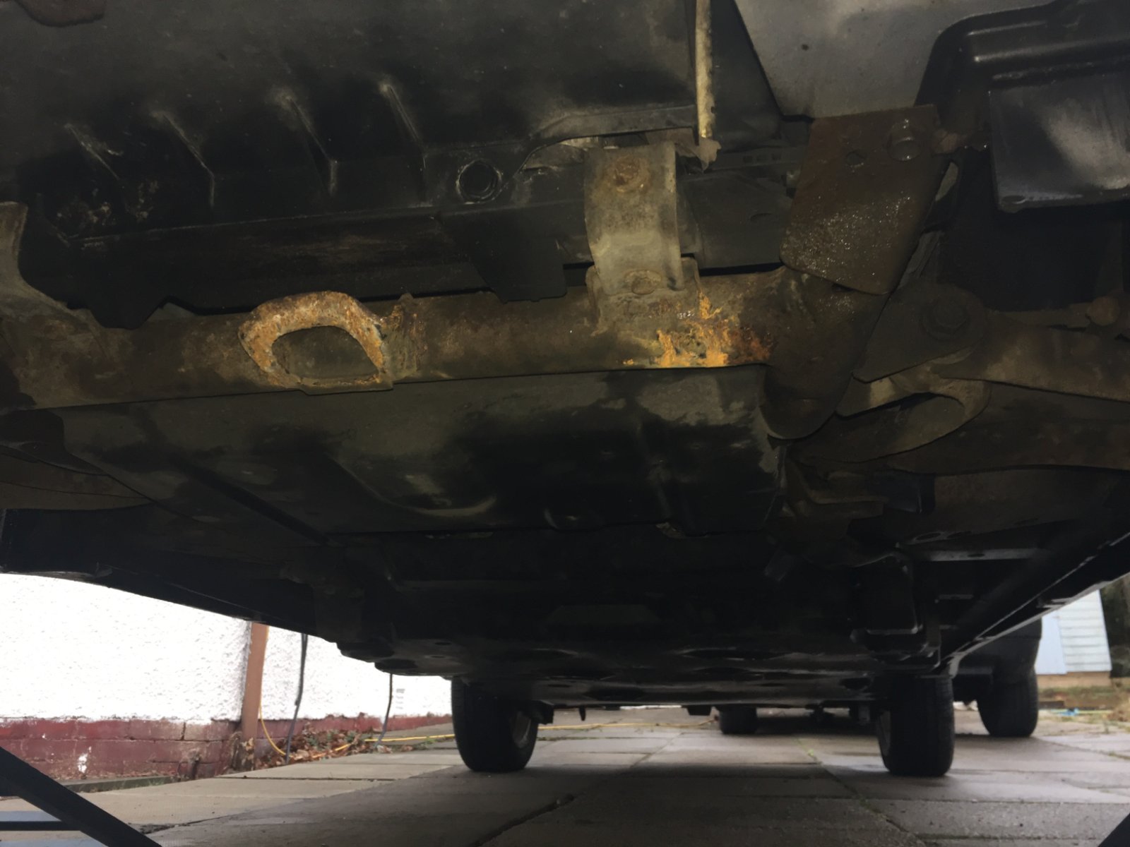

Left the car at the garage this morning and have just heard back from them - they say the lower wishbone arm is bent and needs replacing, which I guess is the outcome most of us probably expected and probably hoped for to be honest as it's a lot better than a bent subframe!
They say after checking, the wishbone is only available through Peugeot which sounds about right as there are no pattern parts suppliers for many key parts on this car...(Mr Auto doesn't even list the car at all for example!
) and are quoting £248 all up for the job, which is only a little above my excess.
Given I already looked up the wishbone on Peugeot service box and know its a hefty £136, I think the difference in labour is reasonable for the inspection and measurement time, replacing the wishbone and then having to do a full wheel alignment and check afterwards, and I trust them to do a good job so I told them to go ahead and I should have the car back on Saturday as all going well they said it should be ready tomorrow but I won't be able to get home from work in time to pick it up, especially given I have to catch a bus from the house to get there to pick it up as a certain someone isn't a driver.
As the MOT is due and was about to be booked in anyway I asked them to do that at the same time as well. So that's a fair chunk of money at a difficult time of month but it's just one of those things that has to be done and it could have been so much worse!
Now I think about it as the steering was slightly off centre before and the edge of the left tyre is worn more than the right one I think the car may have already had a curb or pothole impact on the left hand side previously either before I got it or some time during... and the tracking was already out a bit...so it will be good to have the tracking correct.
I took some pictures of the impact damage underneath before I took the car to the garage, while the cross bar has had a good smack from the curb it looks like that has only caused cosmetic damage and the real damage was the wheel impact bending the lower wishbone...
Looks like the wee car is tougher than I gave it credit for.

Don't be surprised if you find yourself doing that wheel bearing in the near future, if that much force has been transmitted through it, it could well have pitted the surface of the race slightly, obviously only time will tell.
