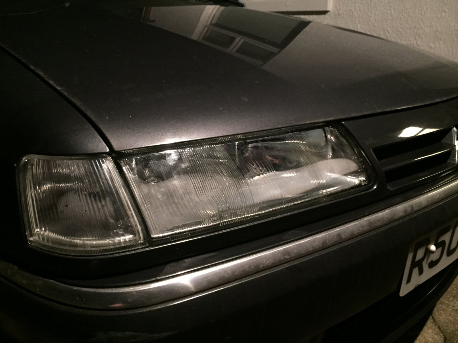

Got it all back together and was satisfied with my work - headlights and grill looked spotlessly clean, presumably the headlights are now properly sealed, and four new bulbs. What could go wrong ? Later that night after it had cooled down a bit I was greeted with this:

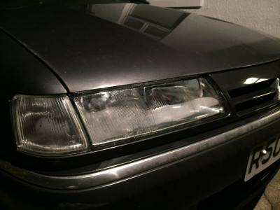

Both headlights severely fogged inside including the one that didn't have any prior fogging problems. #-o
I'm not sure whether it was a result of residual moisture from washing the headlight glasses (I did dry them very thoroughly including with a hair dryer!) or because I was working in humid conditions. At the time I had the headlights apart the weather was 10C at about 90% relative humidity, the ground was wet and it was heading towards dusk by the time I was finishing. In other words there was a lot of moisture around, so I realised I'd probably trapped moist air inside the headlights and as soon as they cooled down it condensed on the glass and had no way to escape. Bugger! :evil:
I figured that I could pop open the bulb access hatches at the rear and leave them open for a couple of days to let the air inside equalise with ambient, unfortunately the weather stayed stubbornly at 8-10C, 80-90% humidity and wet so it had no effect, nor did running the headlights for a while. Drat.
What I needed was some cold dry air with a very low dew point. Last night I noticed the weather report was for -3C overnight which would result in a dewpoint of -3C or lower, and the surroundings were very dry. Both headlights were still fogged so I decided to open the rear access hatches again over night during the very cold dry night air.
Success! :-D Over night it got down to -4C with 90% humidity so about -5C dew point. In the morning it was still -3C but the headlights were completely clear of condensation or fog inside. I then closed the rear hatches to seal them back up again.
In theory the air now trapped inside the headlights (if they are indeed airtight now) is very dry with a dew point of -5C, meaning they shouldn't be able fog unless the ambient temperature went down to -5C or lower, versus them probably having air with a dew point of about +8C the first time I sealed them up. In fact I'm not even sure it's possible for liquid condensation to form if the dew point of the trapped air is well below 0C ?
Hopefully that is the end of it!! Moral of the story - if headlights are air tight its no good sealing them up during wet, humid weather or you will trap a lot of moisture inside them no matter how hard you try to "dry" them out! :roll:

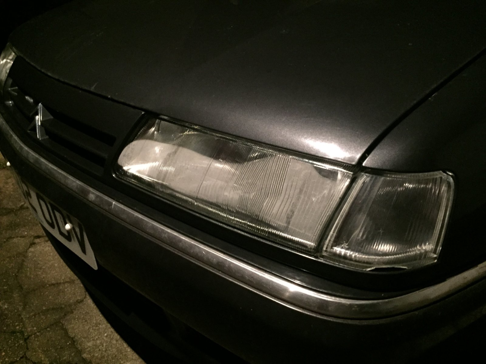

Spoke too soon, temperature has dropped to 1.5C so far tonight and the left hand headlight has condensation in the bottom left corner again! #-o
None in the right hand headlight. So I can only assume that the gasket around the glass is not sealing properly on the left hand headlight and moisture has got in again. Ho hum...

Chuck in one of those little sachets of silica gel . . .
I think I read somewhere that the DS headlights were equipped with vented warm air?
Posts: 28742
x 5674
Re: Simon's new Xantia V6 and Peugeot Ion blog
I wonder if flushing them out with the exhaust from a warmed up vacuum cleaner, followed by silicagel, would be any help.
Not if the seal is breached of course.

I believe part of the issue is that air can’t get in. Had the same issue with Ford Puma tail lights. Owners club fix was to drill a very small hole in the top side of the lamp housing. Worked for me on 2 Pumas
Zelandeth
Posts: 5328
Joined: 16 Nov 2014, 23:36
x 1607
Unread post by Zelandeth »
If it were me I'd drill a small hole in the covers low down. That way the lights can breathe.
You're always going to get it pulling in air from outside when the unit cools down, making it so the moisture can get back out again is a lot easier than trying to get them hermetically sealed.

Michel wrote: 03 Jan 2019, 00:52 I believe part of the issue is that air can’t get in. Had the same issue with Ford Puma tail lights. Owners club fix was to drill a very small hole in the top side of the lamp housing. Worked for me on 2 Pumas
Easiest place to drill a hole would be in the plastic access hatch on the rear which can be removed with the lights in situ, and also be less likely to pick up road dust than a hole in the bottom of the main housing. Hmmm.....
No condensation on the right hand side light. But is the left hand one the leaky one or the right hand one ? If the left one is getting moisture because it's leaking, will drilling another hole really help matters ? Then I just have two leaks! :lol:

I think that headlight units should be able to breathe, rather than be pretty-much sealed. The heat from the bulbs can then have a drying effect on any moisture in there. Front gasket needs to be a good seal, though, to prevent weather getting it.

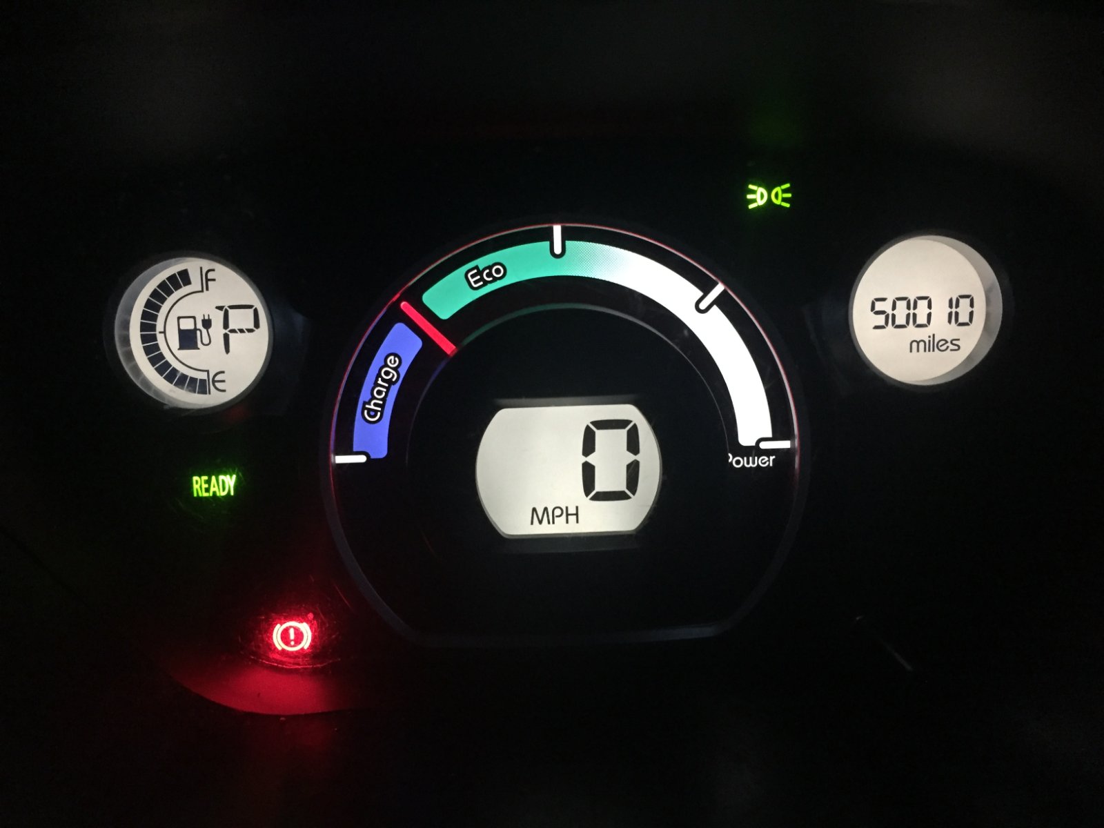

After 2 years and 22k miles of daily commuting and doing 90% of all our driving the Ion has hit 50k miles and 8 years old:
Work done during ownership, much of which was probably due before I bought the car, as is usually the case with second hand cars:
* New front discs and pads - the old pads had plenty of thickness left but the discs were badly corroded and slightly warped due to exploding rust. Same as the Xantia! Can't seem to keep these discs rust free and they always give that rusty grinding sound first thing in the morning for a couple of miles of use in anything other than dry weather. Not sure if it's regenerative braking reducing friction brake use so much that the surface rust can accumulate, or whether Apec discs just have poor corrosion resistance. Might try different brand discs next time, if there is a next time.
* Replaced the front brake caliper guide pins - the original ones were worn enough to cause the calipers to rattle noisily on rough surfaces. Also fitted the optional anti-rattle shims and ditched the lower rubber bush caliper pins for all metal ones. No more rattles from the brakes. :)
* Replaced drop-links in search of a clunk over certain potholes - didn't make any difference so I suspect the clunk is from a track rod end!
* Rear left drum brake was sticking on and/or being grabby in wet/cold weather, did a clean and service of the drums a year ago and seems mostly OK now, however in cold wet conditions the rear brakes are still a little bit grabby when coming to a stop. Not sure what the solution is there - it's not bad enough to warrant more effort on it at the moment, and the drum brake linings have nearly new thickness left. This just reaffirms my dislike of drum brakes!
* Replaced a broken rear left seat tilting handle where the hole had split/stripped.
* Replaced 12v battery recently which was almost dead - despite this the car still functioned normally.
* One set of tyres the first year I had the car - which still have about 5mm of tread left. Unfortunately the rear left has been replaced twice more since then due to un-repairable punctures! #-o
* Traction battery has degraded about 10% in the 2 years and 22k miles I've had the car, which is about 3x faster than expected. (Expected would have been about 3% over this mileage) This seems to be down to 3 specific cells that are much "weaker" than the other 85 cells, and the usable capacity is limited by the weakest link in the chain when you have a series string of cells. Other Ion's of the same mileage as mine generally show significantly greater usable capacity remaining so I suspect it is a case of bad luck and a couple of defective cells rather than normal degradation.
I am keeping an eye on these weak cells and considering my options to see whether the effort replacing those three cells would be worth it or not. The cells are only available on the second hand market from wrecks and it is difficult to find cells with equal or better remaining capacity than the cells I already have in the car. A dutch guy collects and strips EV batteries packs and had some recently and was offering four cells for £200 delivered, however when he tested them they had less remaining capacity than the cells already in the car - so were of no use to me. To be useful they would need to have at least as much capacity as the worst cells that were not being replaced.
The car still drives fine but I think I've lost about 3 miles of range, and rapid charging speed is a little slower due to higher cell resistance, most likely. As the range is already very marginal in winter for my daily commute I think I'll keep it two more years until its loan is paid off then see if I can move it on and replace it with an EV with a bit more range - not sure what yet though! EV second hand prices have actually gone up in the last two years - I could sell it today for £1000 more than I bought it. :shock: However the EV's that I would potentially replace it with have all likewise gone up as well, pushing them tantalisingly out of my reach at the moment.
All in all, it's been a good little car and a toe dipped into EV land, I've learnt a lot about EV's, and now know what to look for and what to avoid etc... and most of the work I've done to it has been "elective" work rather than work that it absolutely needed, however I am finding the range just a bit too tight in the winter and the drivers seat just a bit too uncomfortable for the 35 miles a day I do despite trying various cushions and padding etc... I suspect also as Joshua gets a bit bigger (coming up on 3 soon) and starts wanting his pals ferried around in the car with him that we will need a bigger car anyway! By that time the Xantia will be banned from the roads due to low emissions zones so it won't be around anymore.

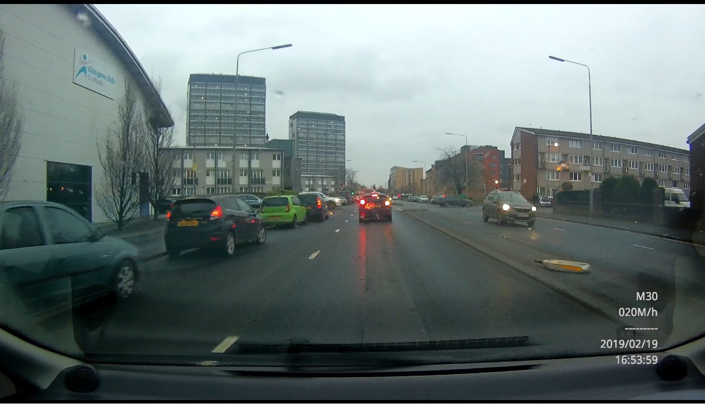

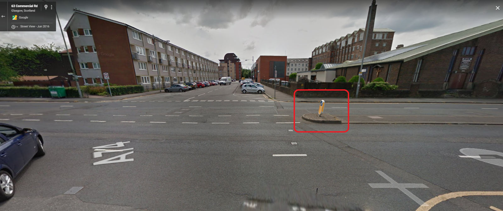

Had a bit of an oopsie with the Ion last night that could be anywhere between an approx £200 repair and a write-off. :(
Without going into a lot of detail I drove into an unmarked traffic island in the rain and dark while turning at a junction. I say unmarked, because on Google street view (picture below) it shows a warning arrow post as being present there, but my Dashcam recording will happily confirm that the warning arrow/post is long gone before I got there! :evil:
The end of the traffic island is double curb height and was directly in my A-pillar blind spot, so in the dark and rain I didn't have a chance of seeing it when I'm busy scanning the horizon for oncoming cars. It hit pretty hard (albeit at only 10mph) then went right over the top. I pulled over and checked underneath, the only visible damage is the tow hook in the middle of the suspension sub chassis just below the radiator is flattened and there is also a dent/scuff mark in the same chassis rail to the left of the tow hook.
