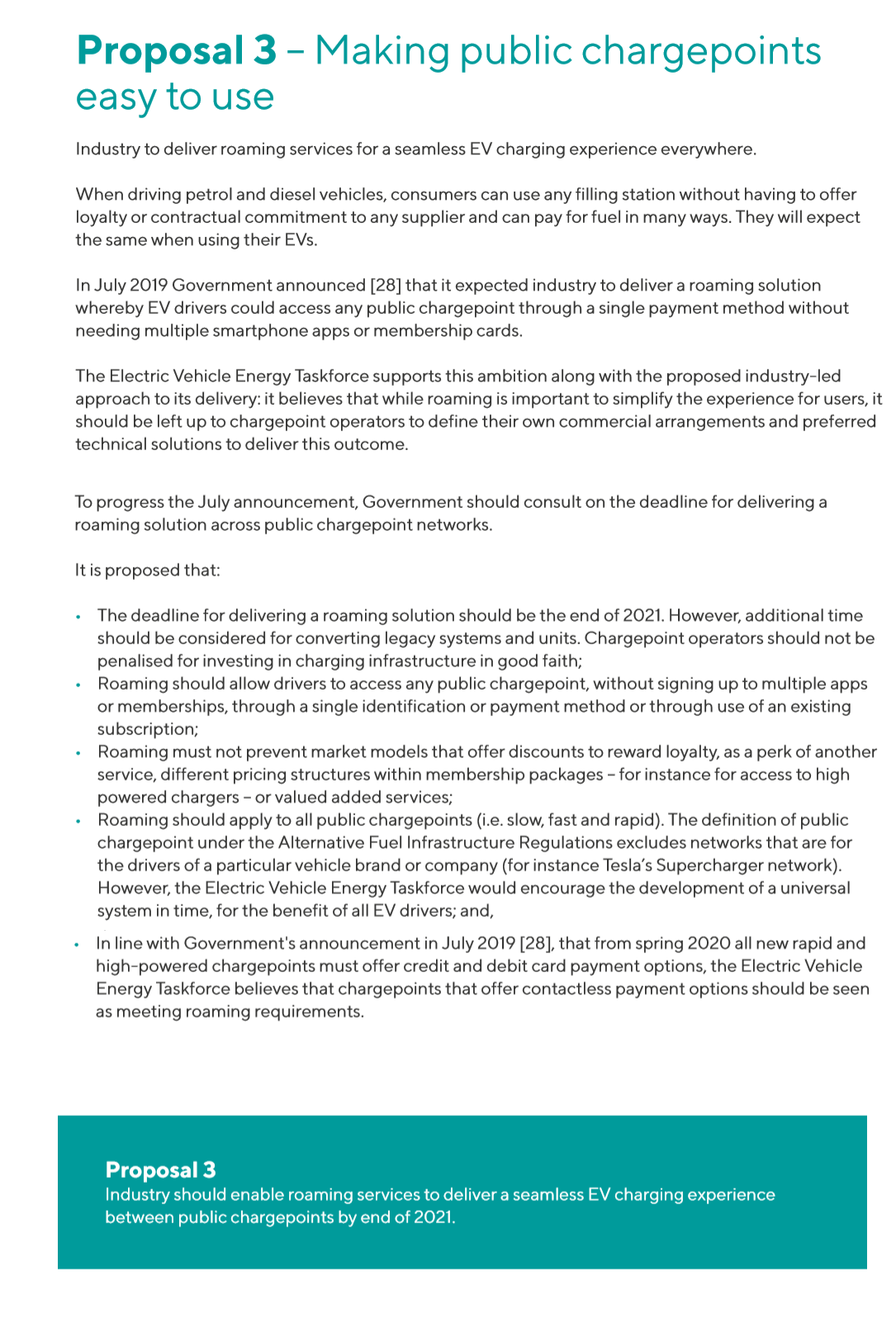

^^^^^ even for the most enthusiastic EV Infrastructure enthusiast that is heavy going. It comes up with 21 Proposals each with a bit of "government commissioned report" babble but this is what they propose on the obvious matter of making Public Chargepoints Easy to use, and requiring universal availability.....for new installations starting "Spring 2020".
In line with Government's announcement in July 2019 [28], that from spring 2020 all new rapid and high-powered chargepoints must offer credit and debit card payment options, the Electric Vehicle Energy Taskforce believes that chargepoints that offer contactless payment options should be seen as meeting roaming requirements
From a user point of view that's probably all you are bothered about, enough chargers in place, and you can access them all without being a member of a club, and pay for it with a bank card.
The report obviously goes into weightier matters than that, including many items with that "smart" adjective placed in front of them...smart grid, smart charging, smart meters. Dumb would satisfy me if they worked, and simply dispensed electricity and let me pay for it. :-D but then again I don't run the national grid, am totally uninterested in my own "data" or anyone elses, and don't have to think about how to protect the network from cyber attacks orchestrated from a Nissan Leaf plugged into a charging point :-D

NewcastleFalcon wrote: 11 Mar 2020, 08:56
Is this document fully up to date ? I know that contactless payment options being mandatory was originally proposed, however as far as I know this requirement has now been dropped and it is sufficient for a charging network provider to offer "pay as you go" use of their services, (as opposed to requiring a membership etc) and that doing so via a smartphone app meets the criteria for pay as you go access to the charging network.
In short, as far as I know contactless is and will not be mandatory, and I think this is a massive mistake if true.

Mandrake wrote: 11 Mar 2020, 09:30 Is this document fully up to date ?
The report is January 2020 Simon, and "launched" Mid February...pretty much bang up to date, and they are proposals to be considered by the Government to implement or not as the case may be. The proposal as stated is for all new installations from "Spring 2020".
