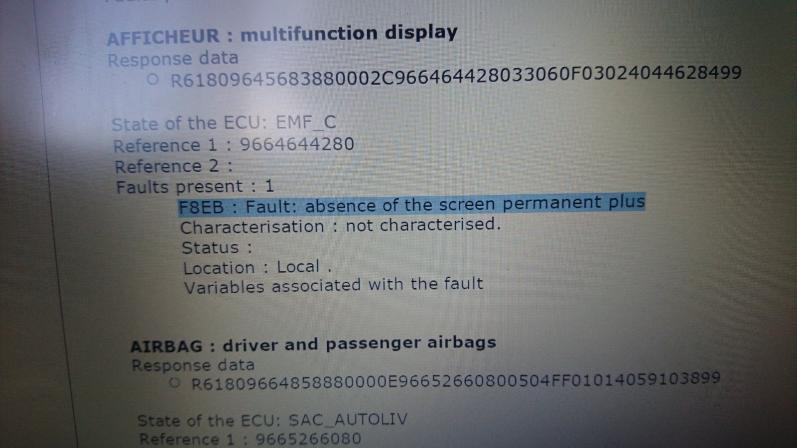

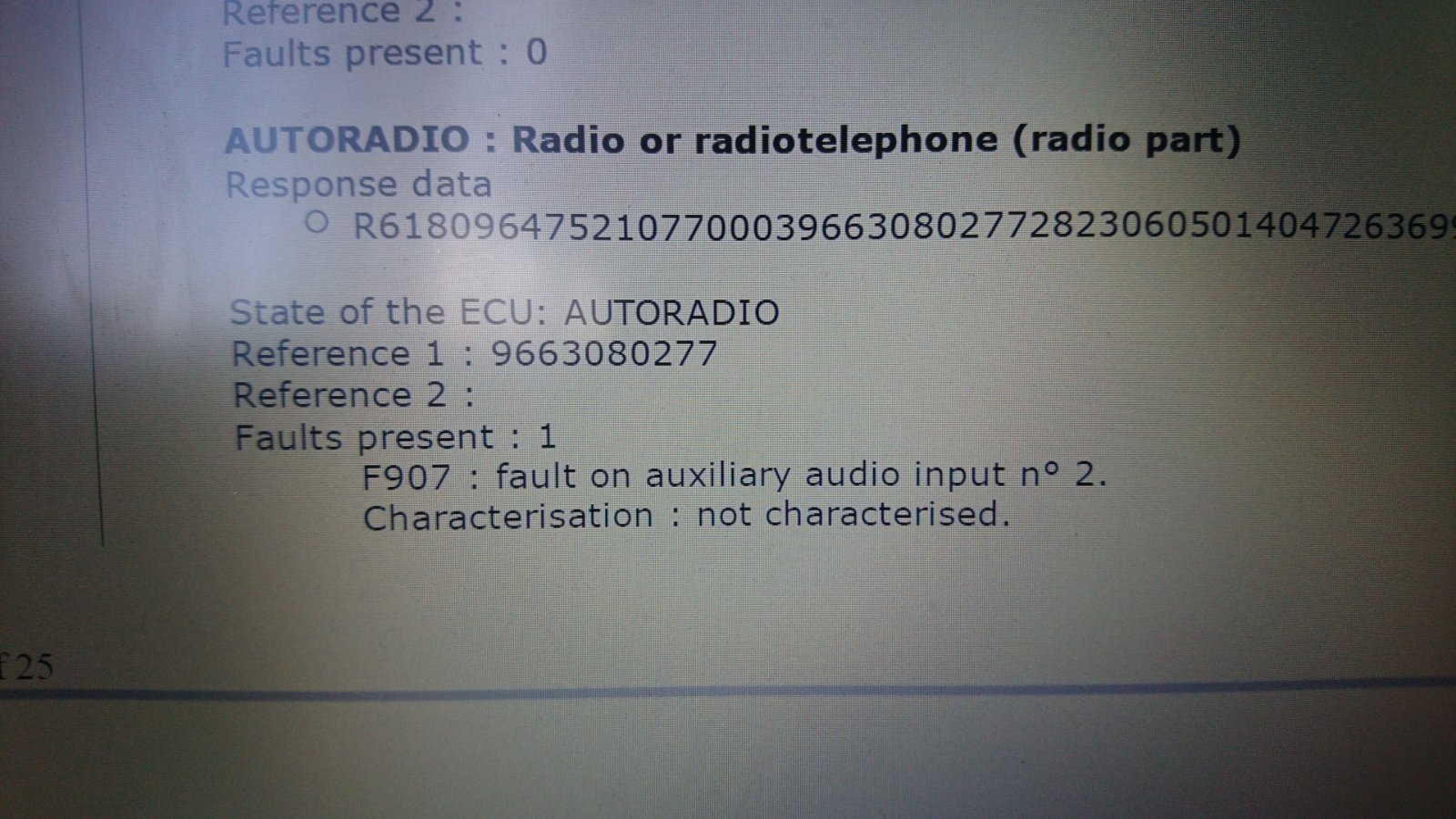

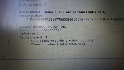

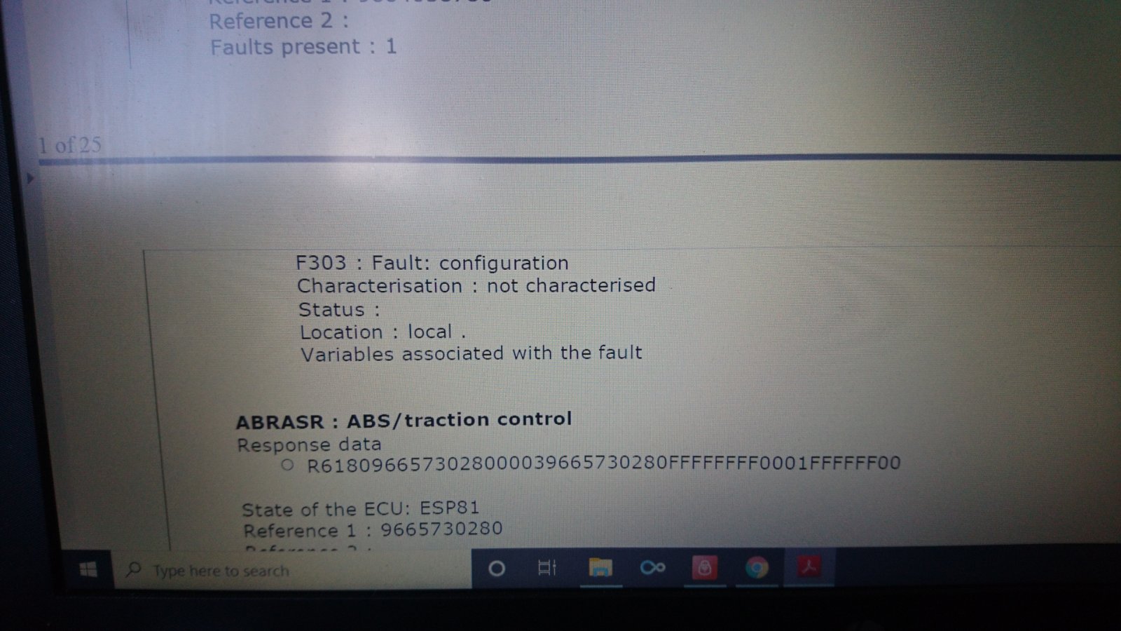

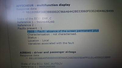

Had the pleasure of meeting Peter today, really good to meet another forum member,especially one who really knows his onions
Had some success with Diag session, Service light is now off and additive counter reset
A few faults remain that i cannot clear. Unable to disable the folding mirror options but that is probably down to operator error
Good news is that 1 of Peter's VCI does work so think the problem is maybe down to the software version needing updating.
Cracking car BTW, even the Boss asked if it was for sale
Not sure why the pics have come out the way they have but the last one is a fault within the BSI

Ok, so:
F8EB: Fault no PERMANENT positive of the display: Not characterised. So the permanent + voltage is disconnected (less than 8V).
This fault will appear apart from when the car is in Economy mode.
The fault will disappear if the positive + is returned and the multifunction screen is restarted.
Basically the display will be blank under these circumstances,
Suspect areas if still present when engine is running: Electrical harness / wiring or the Screen itself.
F907: Left-hand analogue auxiliary audio input 2 fault: Not characterised . Absence of a DC voltage of 4 V with a tolerance of +/-10 % and an impedance of the auxiliary inputs of 100 Ohms maximum for 2s, on one of the left or right-hand auxiliary inputs (During the radio wake-up phase). If Input AUX 2 configured present.
Suspect the Aux socket wiring (which is in the glovebox) to the Head Unit.
It might be worth checking that the Quadlock plug at the back of the Head Unit is secure.
F303 This is saying that an ECU has been left incorrectly configured / not written correctly. This may possibly be related to the attempt to change the folding mirror option - or from a previous session....

Sounds far to technical for me, I grew up with valves and analogue.
Thanks very much for your effort and hospitality Colin, and your assistance Marc, very much appreciated.

For clarity the fault F303 was recorded during the Global Test BEFORE any repair/clearing was attempted
Peter it was a pleasure to meet you, sorry we could not sort all of the issues that were flagged up but here if need me

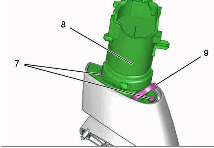

I have looked back at a post from Marc about the mirrors.
detailed pic
The mirror is doing what it should, with very little resistance it stops, my feeling is that maybe the lug has broken off the spindle, yes it is a faff to get it apart but may be repairable with a little bit of imagination ?
detailed pic

Yes - no blame intended there Colin - as I pointed out in my post
this could also of been a previous (unrelated) attempt by the previous owner for example.
That picture is exactly the thing I was referring to about the pin snapping.
