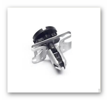

Nope. It looks (from what I can see) like a cage with a twist rivet through it, and it is all in one.
Re: My turn for a C5!
Found a picture on Aussiefrogs, looks a bit special, can't find it listed in the UK except at the dealers.

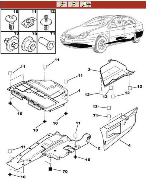

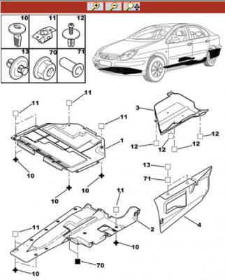

7030 16 are shown on the diagram I posted earlier and here again - top left number 10 for the MK I:
7013 V8 are the new combo clips from RPO 09741
7030 18 is number 11 next door which they go into. 7030 16 are 67p each, but can easily be obtained on the bay of evil for much much less - they are nothing special.
7013 V8 are 56p each.
7030 18 are 30p each from Citroen.

There is a later variant of some sort. My C5 has the RPO 10041CJ. If you look on the Cyrillic web page I posted, item 8 is the closest to the items securing the deflectors on my C5.
Item 8 on the Russian site is the same part as I pictured from Aussiefrogs, I've never seen any like that, the ones 10 & 11 that Marc refers to are the bog standard engine undertray fasteners, I've got a few of those in stock.

That might be the Aussiefrogs item. I have ordered 24 (I need 22, plus a couple of spares, just in case), as well as 12 of the nut washers.

Right, I don't have your VIN, so for RPO later than 9741, then it will be these combo jobs:
I've amended the table above to reflect this and the prices.
| 7013 V8 and 56p |
- Posts: 14310
- x 3296
Thanks Marc, that looks like the item holding the air deflectors in place.
