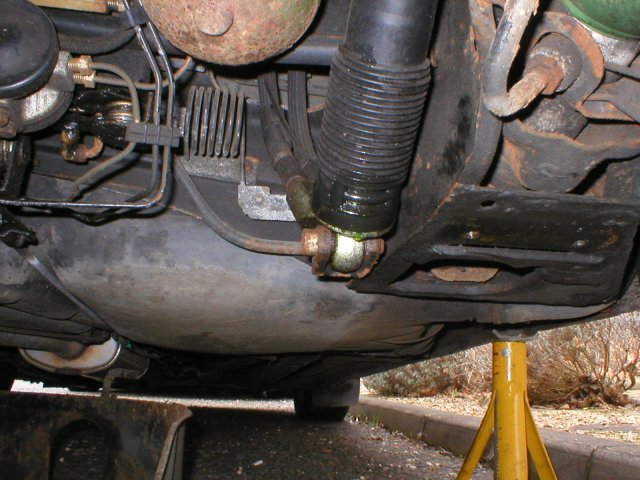

I fixed my leaky rear ram today...
This was how leaky it was
Full story is in my blog here:
http://www.activav6.co.uk/2015/03/fixin ... y-ream-ram" onclick="window.open(this.href);return false;
Whilst I was there I also pressure tested the rear spheres as access was easy...
I will soon need a new Activa Balancing Sphere and Rear Centre Hydractive as both are a bit low but that's not bad as both are about seven years old..
They came off nice and easily...
