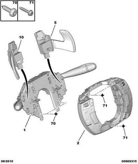

As collogue vborovic i'm going to make few thinks in parallel . Today i've bought switches module with ( over the steering wheel ) with gear shift pads - it is more important mod for me than make running amibinet light ( of course i'll not throw this topic away ). I got this complete switching module by around 30,00 EUR. I'm wonder if there is wire harness in my car for handle it - but for me it is just simple switches . Now i need to find dedicated steering column for gear switch pads... at least i'll do milling by my self :)

Now i need to find dedicated steering column COVER for gear switch pads... at least i'll do milling by my self :)

Just wondering? Do you have the AT6 gearbox? If yes, then the gear shift pads won't be of use to you ... :)

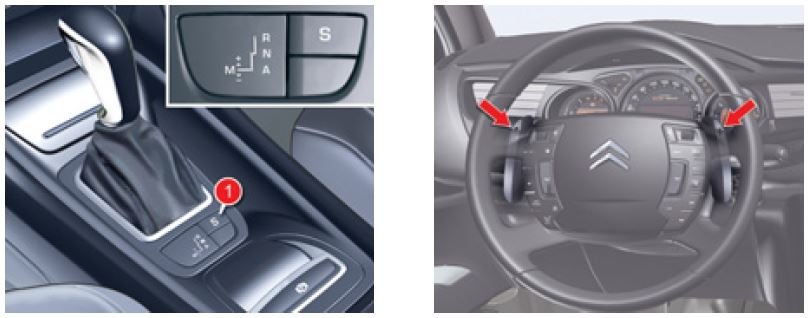

Don't know the english term, literal translation from croatian would be manual controlled/piloted 6-speed gearbox ... if you have it, it will work plug & play (but, that gearbox option already has the pads on the steering wheel in the first place) ... for the AT6 transmission, there shouldn't be a possibility of wiring the pads to the gearbox control ... I've researched this already, and that's the conclusion I came up with ... I'd rather I was wrong of course ... :D
The gearbox in question in the car looks like this:

My gearbox is BVA AM6C - called also if i'm not wrong : TF-80SC. It is automatics gearbox and it can work in manual sequence mode. So i'm sure i can bring this pads into life even if there is no wire harness. Hope .. :)

przemekwieckowsk wrote:My gearbox is BVA AM6C - called also if i'm not wrong : TF-80SC. It is automatics gearbox and it can work in manual sequence mode. So i'm sure i can bring this pads into life even if there is no wire harness. Hope .. :)
Yes, we know which gearbox it is ... https://en.wikipedia.org/wiki/AWTF-80_SC" onclick="window.open(this.href);return false; ... per the Service Documentation (couldn't find the related schematics so far), the pads are only available for the piloted/robotised 6-speed gearbox ... I know I used to search how to get them working on the AT6 gearbox quite a while back, but never found the location(s) which needed connecting or modifications to get things working.

I agree , gearbox Is slow, whole care is slow :) , event it is 3.0 V6. It is not a racing car but i think sometimes these pads could be useful, I think.
Today i've received pads with other switches
Tommorow checking if wireharness exists
Colegue vborovic don't be so pesimistic - shifting is just a 0/1 signal on wire ( wires) so even if there is no wire harness it could be easy to attach do gearbox handle in specific logic / sequential mode +/- control /

przemekwieckowsk wrote:Colegue vborovic don't be so pesimistic - shifting is just a 0/1 signal on wire ( wires) so even if there is no wire harness it could be easy to attach do gearbox handle in specific logic / sequential mode +/- control /
Electronically speaking, you're right ... but I guess Citroen had some kind of logic going on when they decided to leave the pads out from the AM6 gearbox ... fingers crossed you succeed ...
