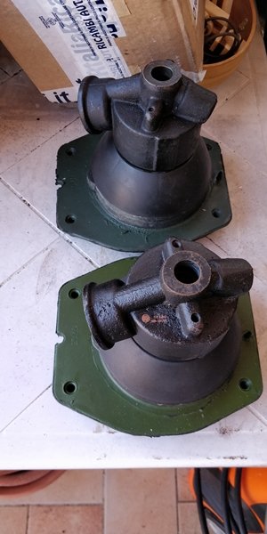

if someone can be interested i've a couple of this dome struct; I found but just when try to mount we discovered that they were not ok for my Xantia HDI mk2
So could be they were for Xantia mk1 ?
see in attach pic
see in attach pic

gercol wrote: 23 Oct 2018, 15:42 Hi!
see in attach pic
Hi, if you still have them what would you want for them? I have a 1996 Mk1 Xantia 1.9SD which needs saving and mine are pretty rough!
