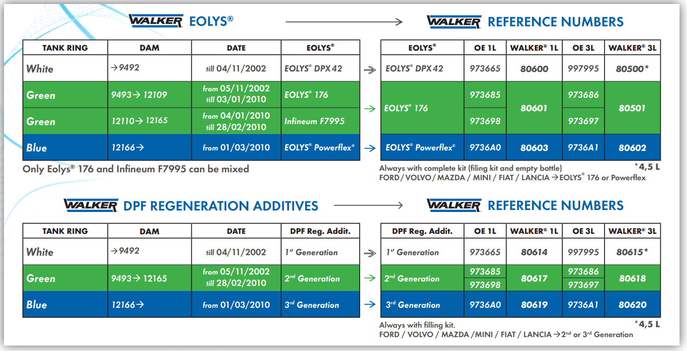

You should have a Blue Clickfit connector and according to your build number (13477), you need Eolys Powerflex additive.
Here are the part numbers and the Walker alternatives:- so any of the products in BLUE.
Click image to Zoom
Click image to Zoom
