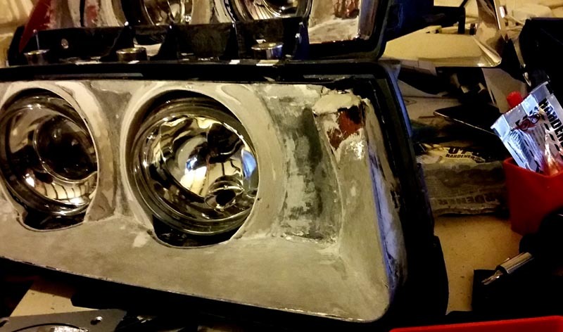

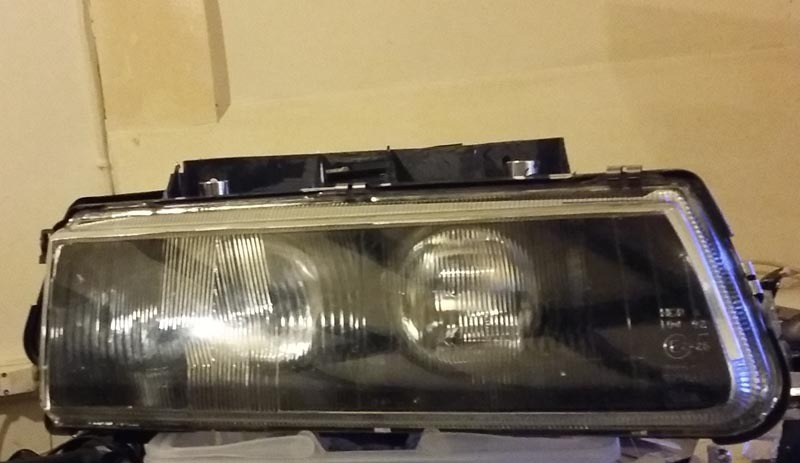

The moulded front plate behind glass............(painted satin black)
Black ?, well it could be any colour you choose really incd chrome.
elma
- Posts: 3745
- Joined: 13 May 2007, 02:17
- x 287
Re: I am an Activa owner...a V6 and I am an addict
That looks mean, I like satin black a lot.

Moulding will push the price up a bit I think, I will also have to find a very good heat resistant type and test for some time.......high carbon plastics are normally only made under pressure injection.........that or a blow down (cutting out is £xx.xx as well (or time/more skill)

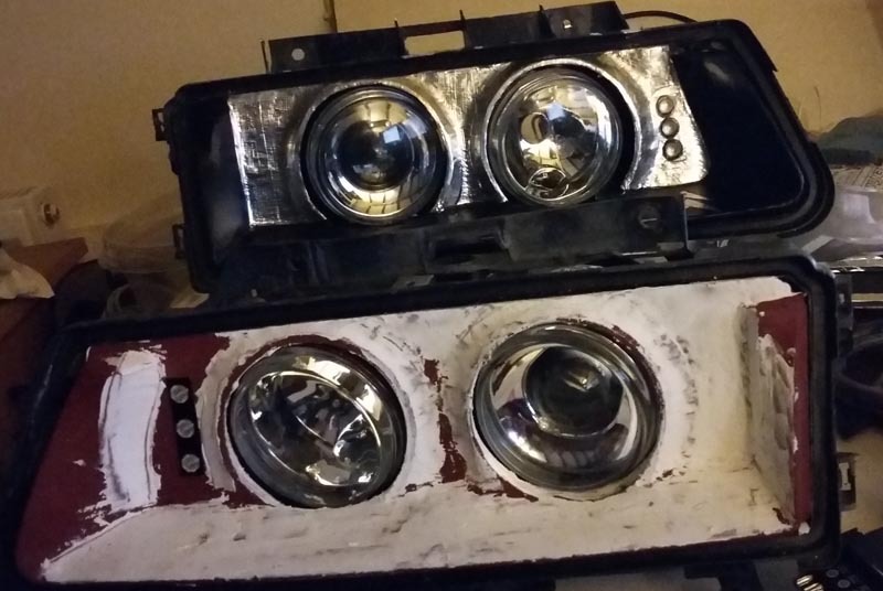

Mocking up the master for the other side...

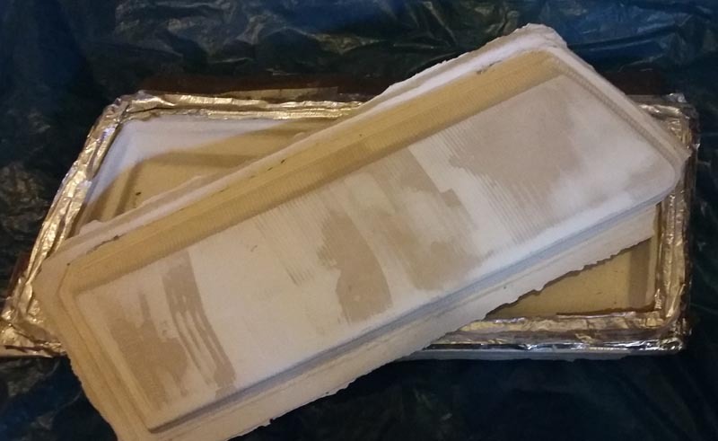

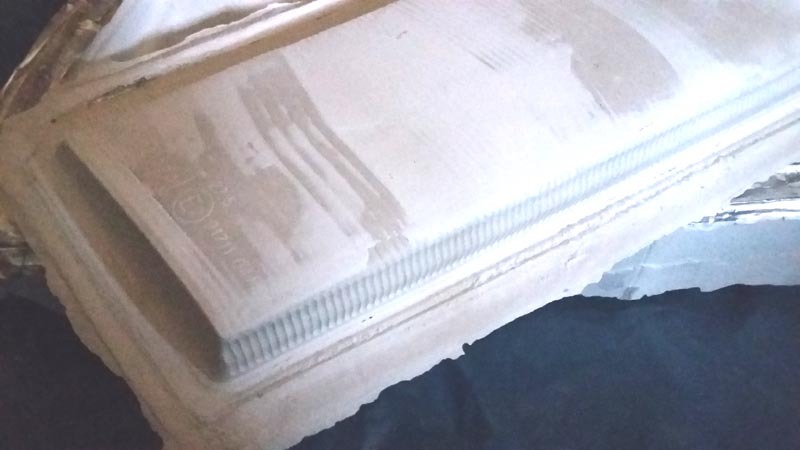

Making the bucks for the vacuum formed replacement "glass"

I have a final design now and the faceplates match well. I am now making these smooth ready to make moulds with them so I can produce copies.
