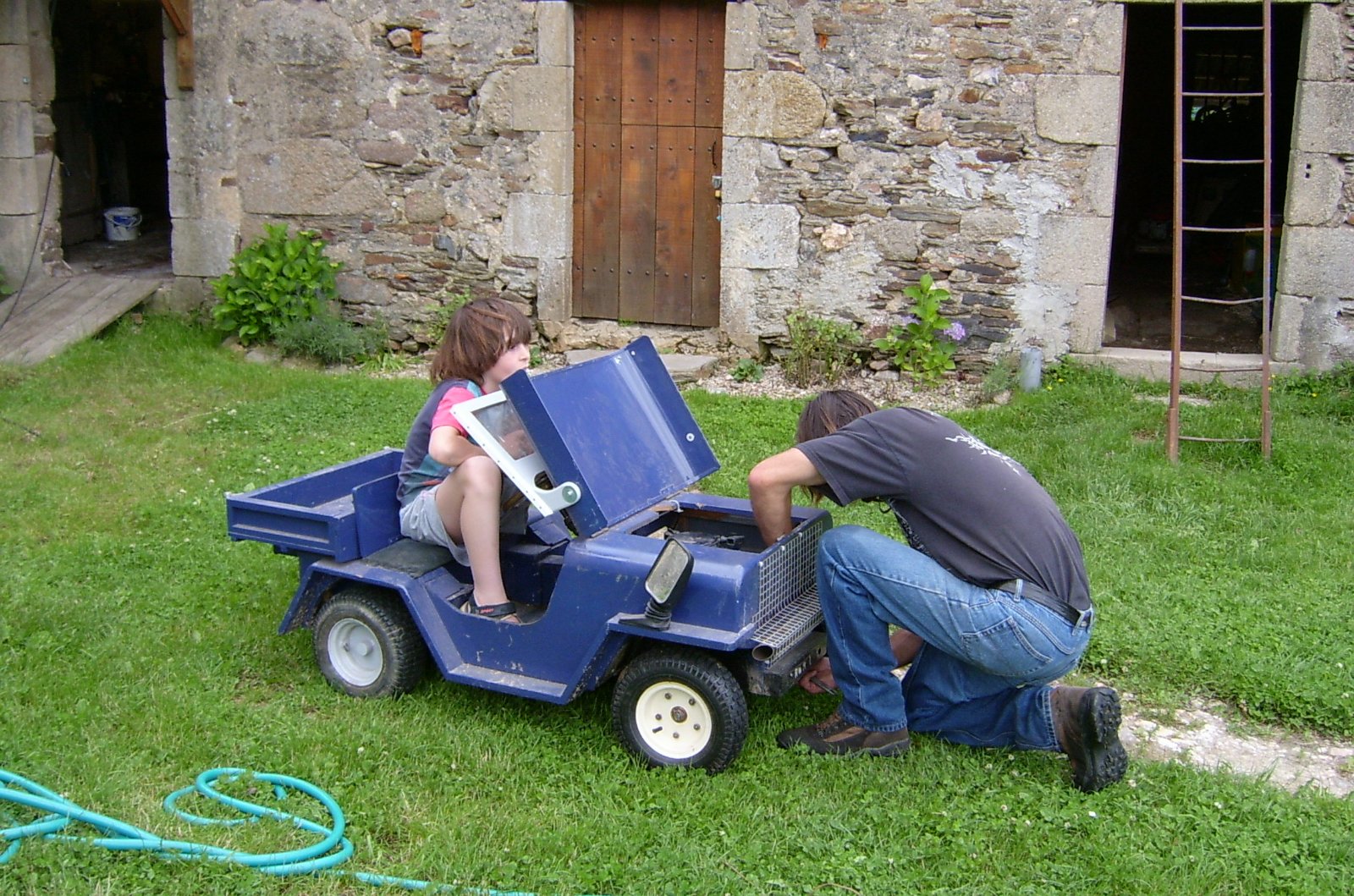

That's magicalmoizeau wrote: 07 Sep 2024, 08:35 A photo from 2008/9, built by my late Father in Law.
It uses a gearbox (3 forward, 1 reverse) from a flash sit on mower, belt driven from a 3 1/2 hp Briggs engine and feeds the back axle by chain. The disk brake is integral on the g/box output shaft.
The Jeep has long gone with the mechanical bits put into a rear engined go kart which I still have in the barn.

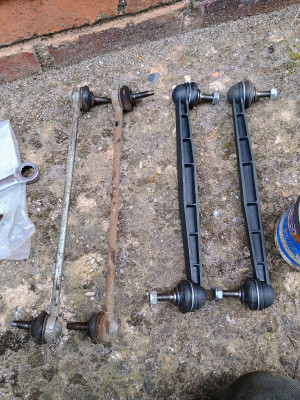

Suspension clonk on the blue 308 = sorted.
Anti roll bar drop links, one ball joint very worn.
As a bit of an experiment (and because I had a pair of them "in stock" from years ago)
Anyone want to play a game of "name that drop link" ?
Oh, suspension clonk on the other 308 is a step nearer: I realised the 3/4" deep 41mm socket in the set I've bought, has enough depth internally to accept the bottom ball joint (without modification unlike the 1/2" deep 41mm socket I bought) hopefully next weekend's task.

It amazes me that quite highly stressed components like drop links can be made of plastic!

Yes, on the car what these are intended forCitroJim wrote: 08 Sep 2024, 04:59 It amazes me that quite highly stressed components like drop links can be made of plastic!
- Spoiler: show
I've read a few times the theory that the plastic versions last a bit longer than the steel ones - as it's the ball joints that give up, rather than the steel rod. Perhaps that little bit of "give" protecting the joints from some of the shock loading

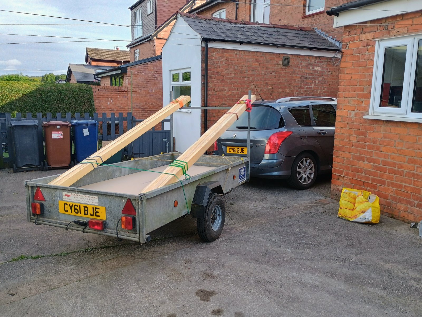

Another trailer trip, 300+ kg of plasterboard and some 3x2" timber for studwork,
